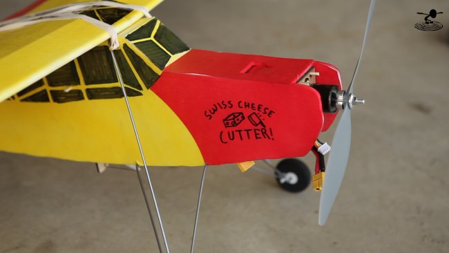

The Swiss Cheese Cutter.

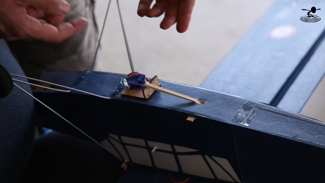

The bomb drops are an extremely easy setup that you can make yourself.
All we did was mount a servo onto our FT Elements Simple Glider Tow Release with a small hole punched out to let a 1 1/2" (3.81cm) piece of push rod thread through.
A popsicle stick near the CG holds a rubber band that will hold just about anything you want. When you activate the servo, the rod is pulled out releasing the rubber band. By the way, when we say this setup will hold anything you want, we mean it.
