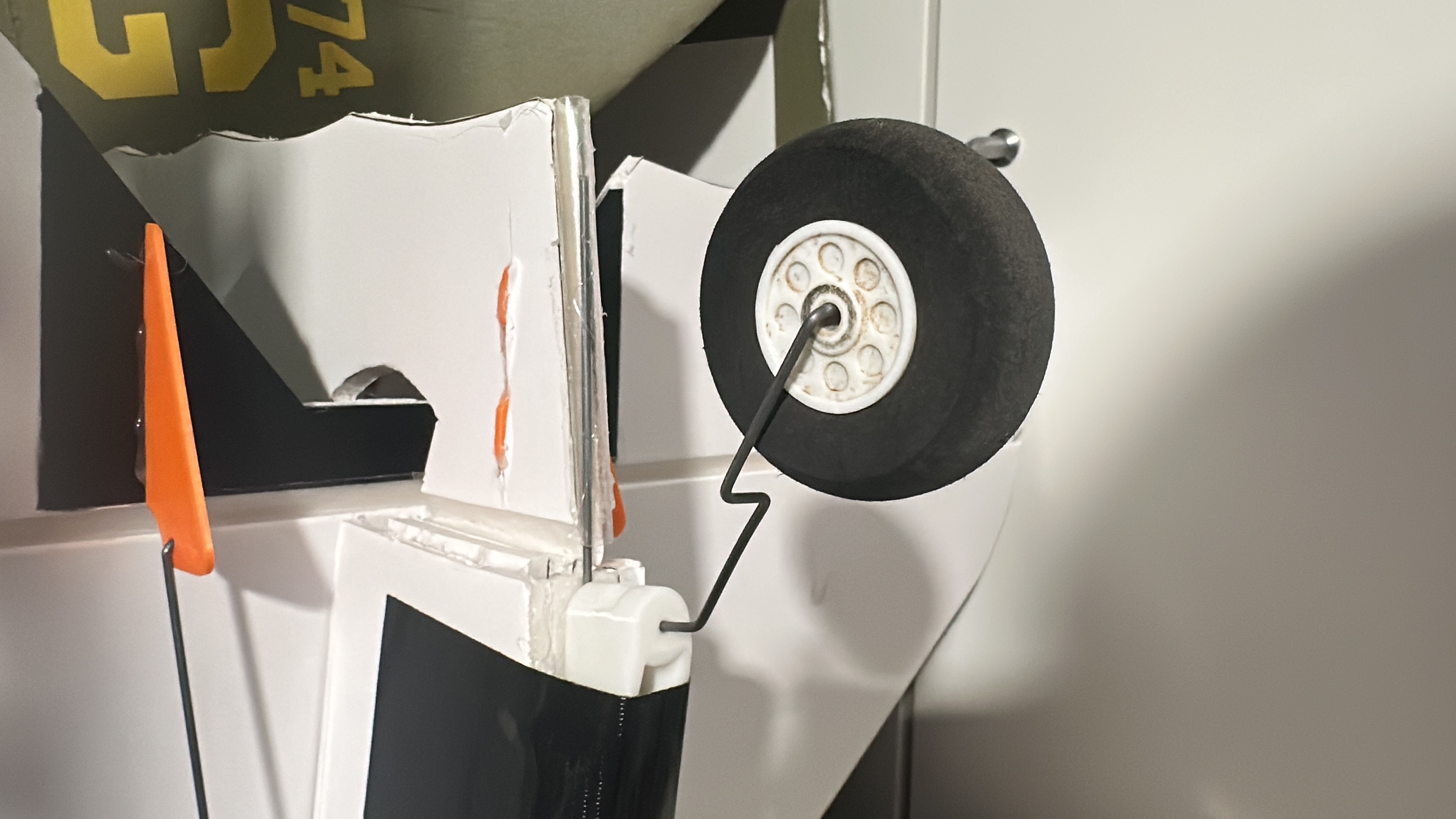

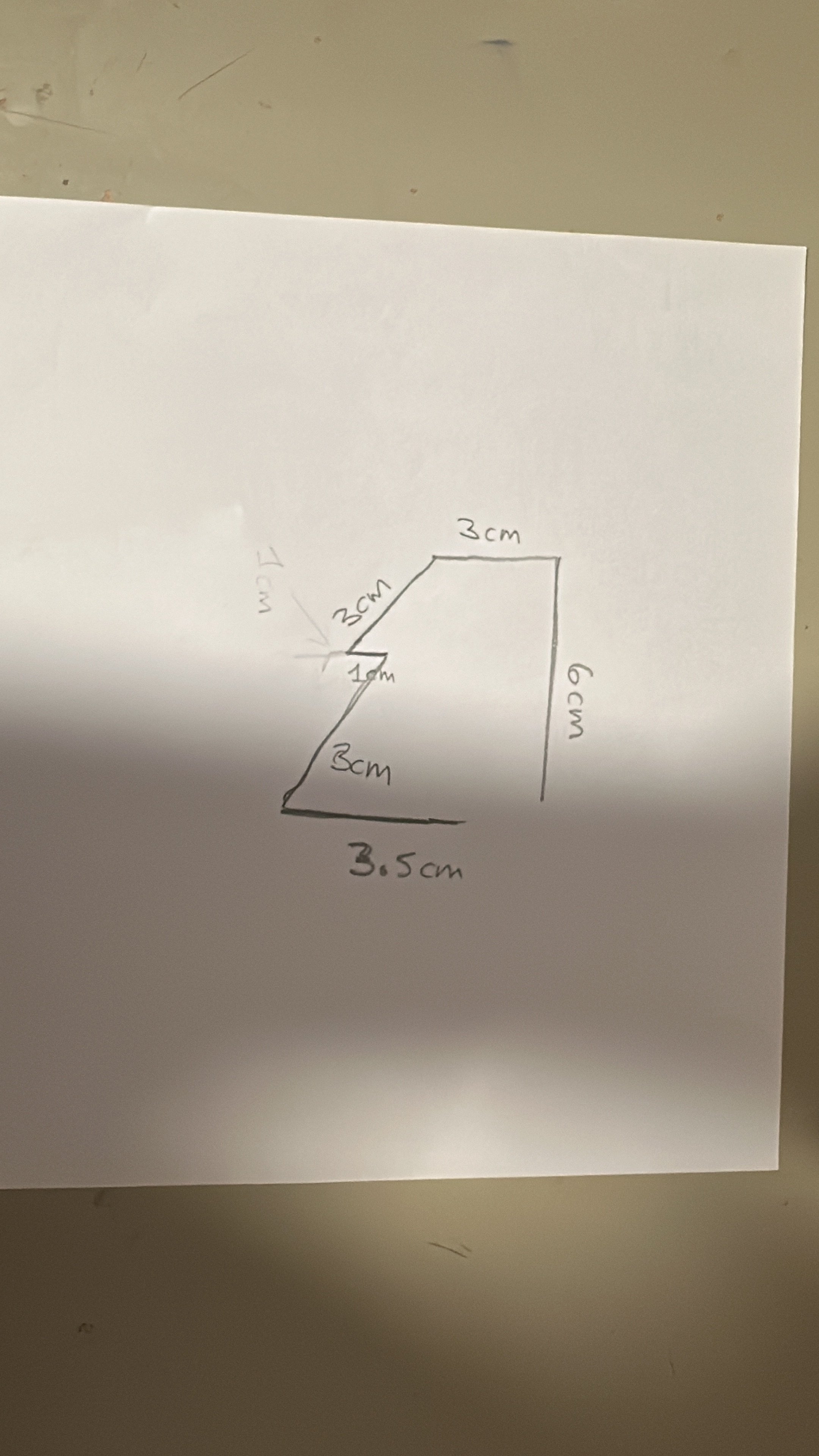

I ended mimicking the bends from the video and got it looking decent if you’d like I post the measurements
mayan
Here you go.
The 1cm bend in 90 degrees to the left or right to allow the wheel to sit straight on the rudder.
It should be about half of the width of the wheel.
Ohh and the angle should be about 45 degrees.
