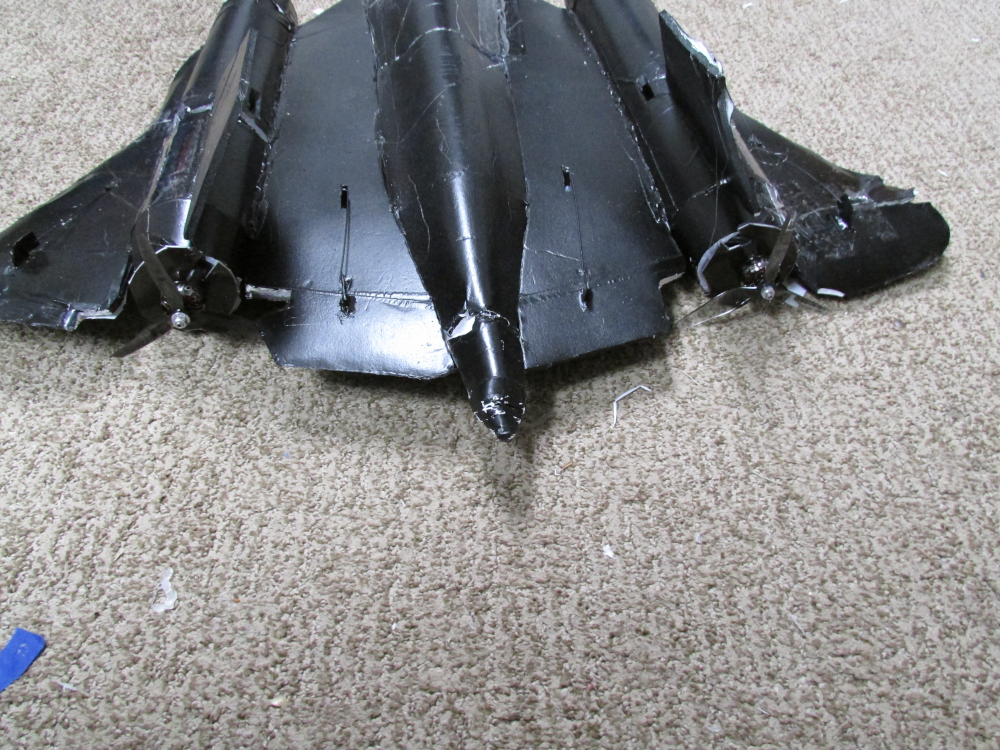

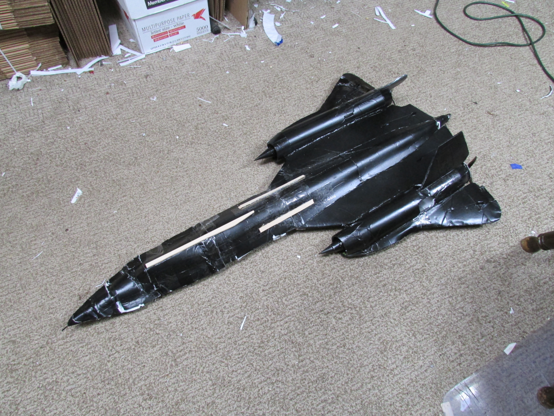

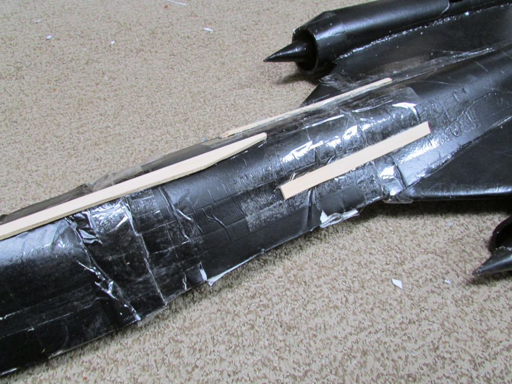

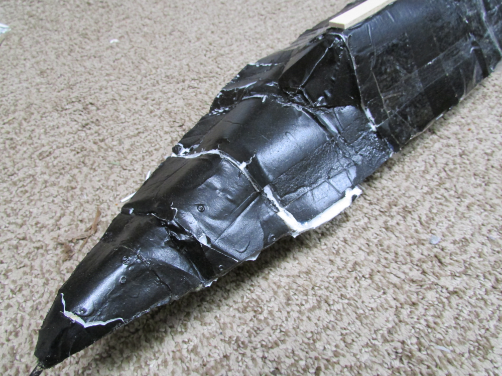

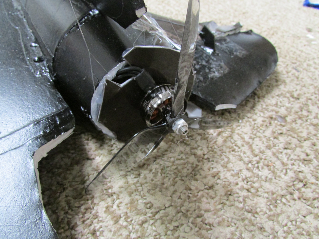

I was videoing...I thought......Yes I had differential thrust.....How I know that it stall is I pull up just a little bit and the nose whips up until the plane is vertical, and then because I have Edf's it stall and comes down!
I am hoping to get time to get the rest of the nose glued/taped on and the other motor put on tonight so i can take it out tomorrow.....I would have done it last night but the incident with the radjet sorta took a LOT of my time, and then there was work ect....
Cool, no worries on the searching for parts stuff, I’ve had my fair share…
Welll.....She's ready..... 🤣 🤣 🤣
