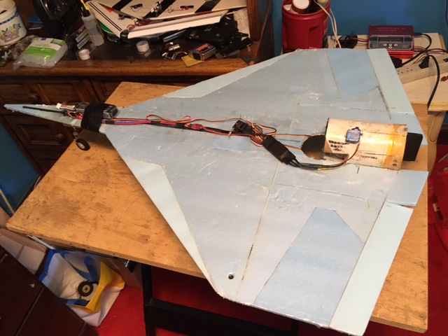

I am beginning to think the B2 is so unstable that it will need a gyro. I got my rudder inside the exhaust tube to fly and the only way to stop the oscillations was using the gyro and reducing the servo speed. That sucks.
