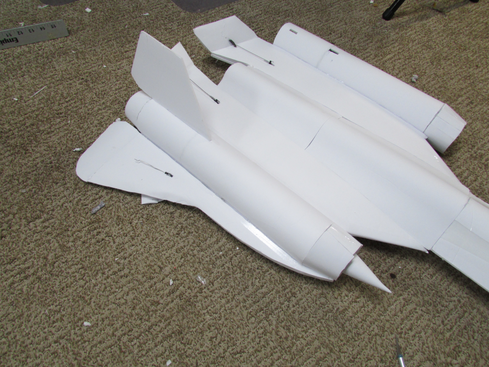

Cool!....Hopefully the paper doesn't come off when you are forming the nacelle cones...You will need to bevel those like the radjet and the edges of the wings will be done like Nerdnics speedwings. Also because you can't fit the servos in the outer wing sections you will need to run some coffee stirs thru the nacs and into the fus where your servos will be..

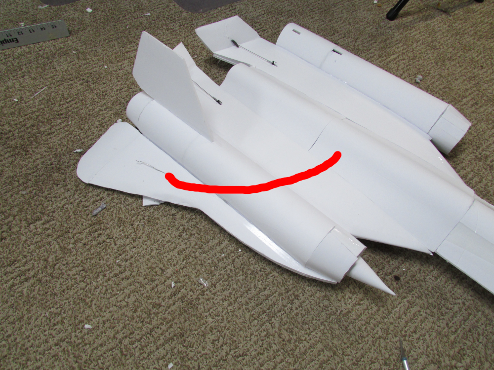

But what about yours? It kinda looks like the servos are right there....
No, what you are seeing is the end of the coffee stir...I know, its hard to do but I couldn't think of any other way! (I used a drill bit to punch thru the nac while looking down them...Also, make sure you get the nacelles straight otherwise you will have built in thrust angle so to speak.

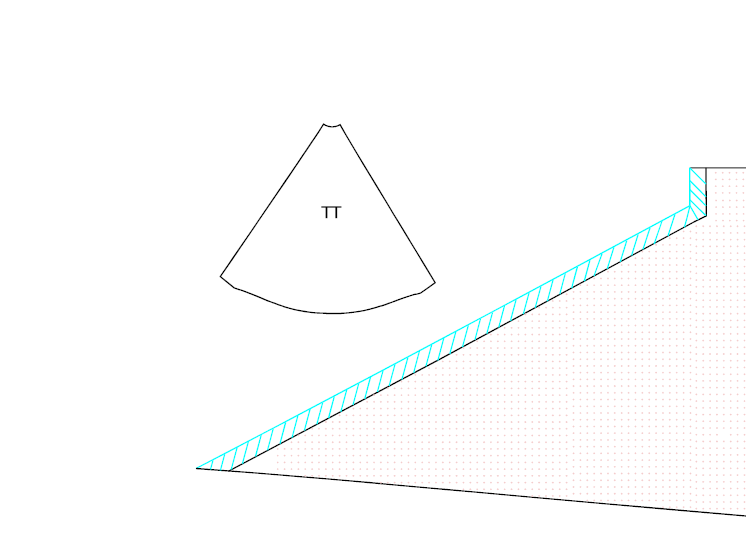

Quick question. Do I cut on the blue line, or black line? (I'm guessing black)
