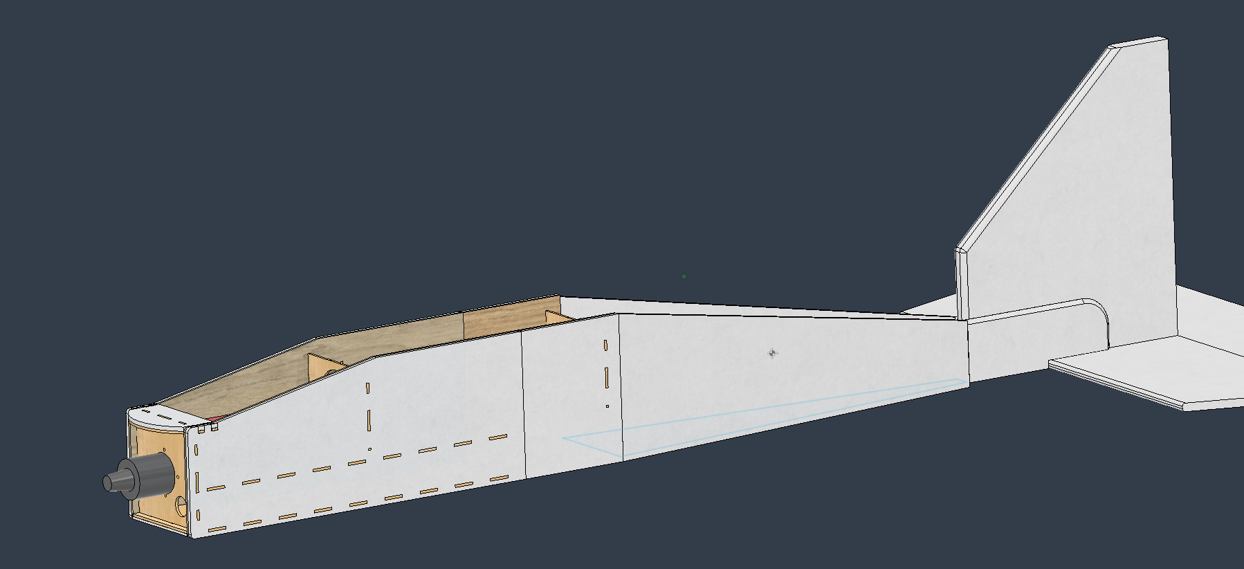

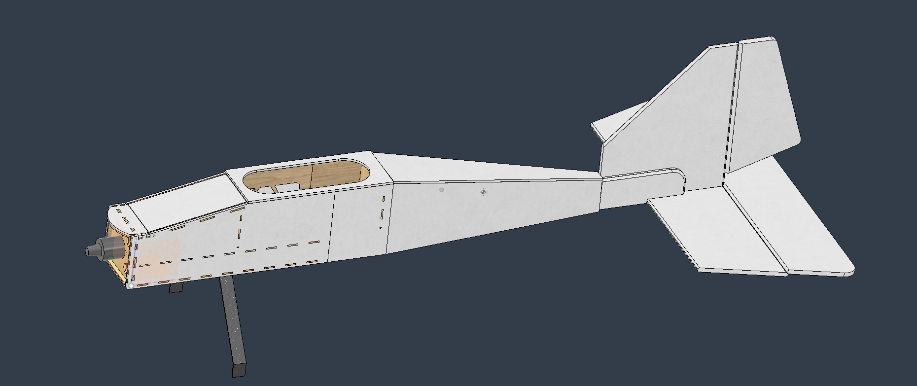

I'm making progress, slow but still... The fuselage is about 60% designed at this point. 62 inches from firewall to back of elevator.
Things to do:
  • landing gear
  • cut away most of the wood, leaving only what is needed for reinforcement
  • wing mounts
  • top of empennage
  • tail servo mounts
  • battery compartment cover
  • rudder
  • fine toon a lot of trivial things

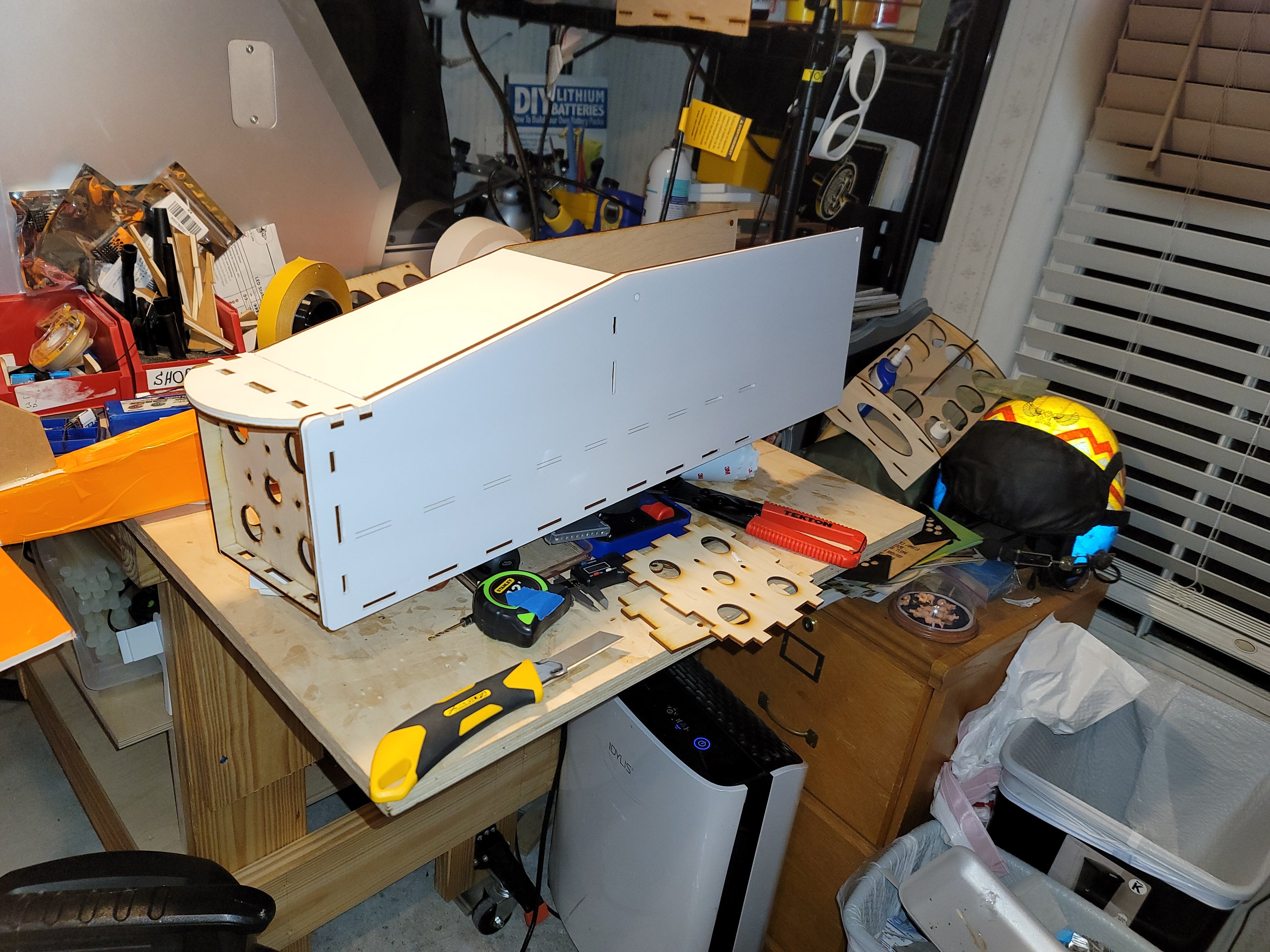

Made good progress today, glued up plywood reinforcements in the forward fuselage.
Did a lot of design work on the empennage and cut the top empennage plate.
I need to start thinking about the wing and a color scheme.
Any suggestions for a color scheme are welcome as she needs to look good even if she doesn't fly. :p
