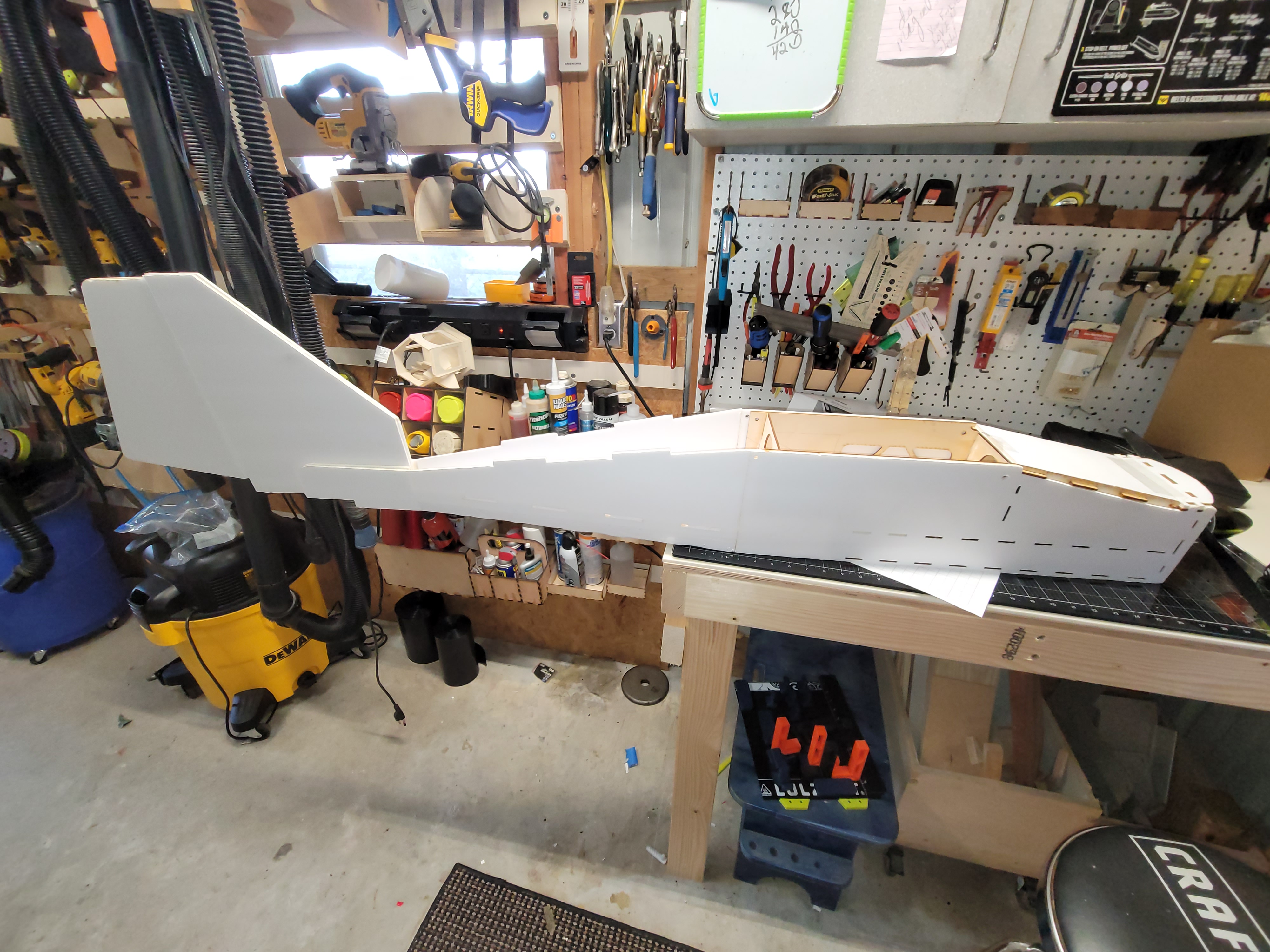

The fuselage is complete minus the control arms.
The wing is cut out, minus the spars.
At this point I am giving her a 50/50 chance of flying the pattern. Pretty heavy. Found a design flaw where the empennage meets the tail feathers. I've fixed it the way you would crash damage but that has added weight and ugliness. I understand my mistake and the learning just from that makes this a worthwhile endeavor.
I have more foam board on order, but if everything goes smoothly with the glue-up of the wing, I have enough to finish.

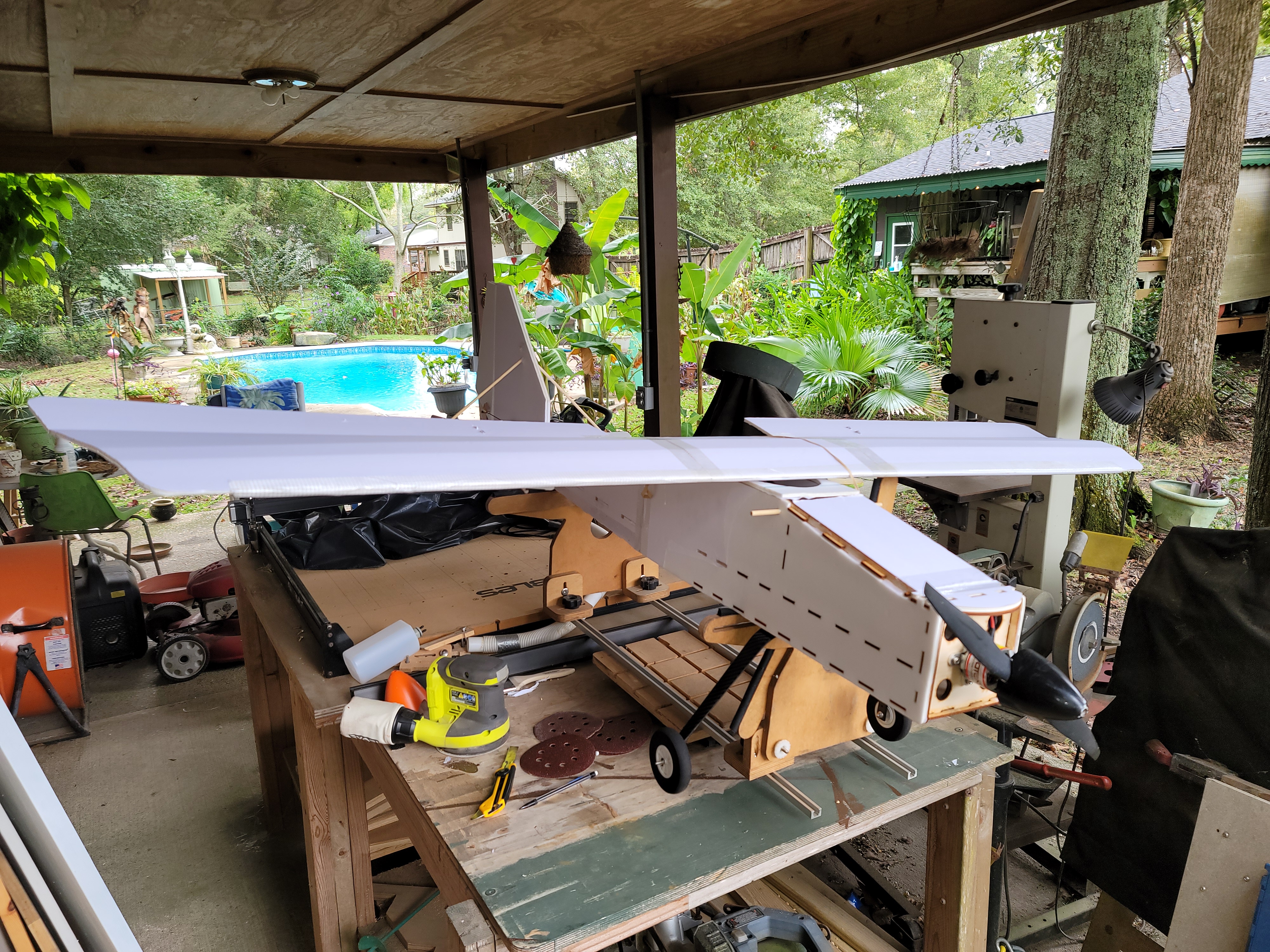

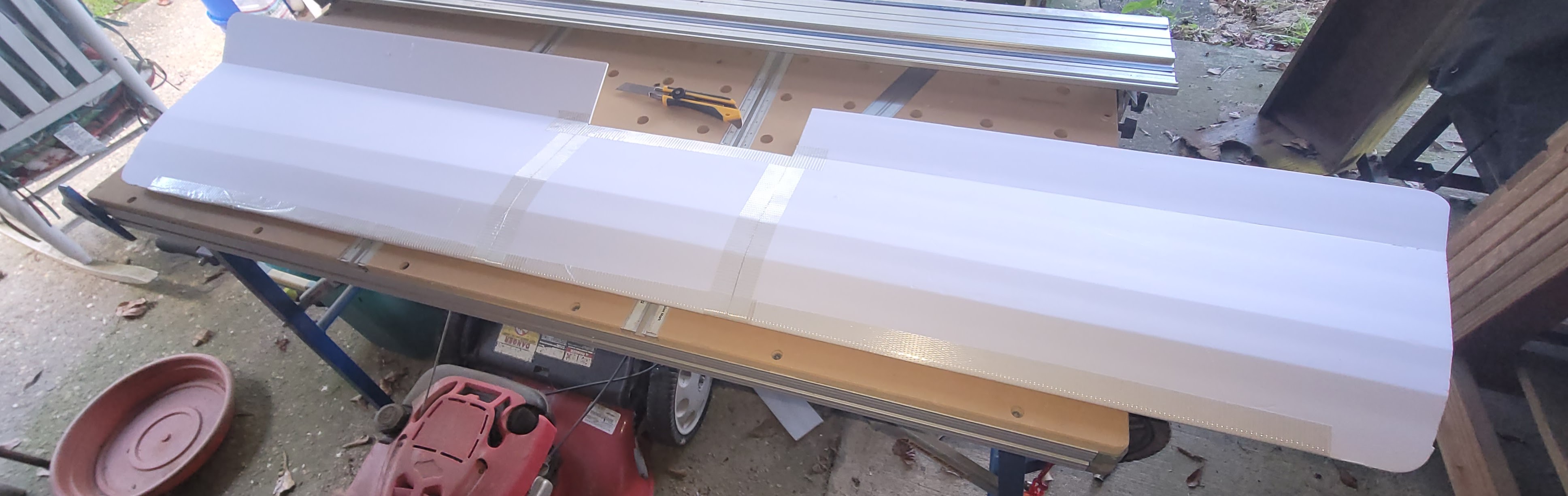

Flying Monkey fab
The wing glue-up went better than expected, but not without challenges, as it is 6 different panels.
Total wingspan is 70".
Next, install the servos in the wing and install push/pull hardware everywhere.
I must look again, but I think I'm going to have to order a receiver as I have several larger flyable right now.
This wing is basically a stretched simple scout XL without the scallops.
I added a spar reinforcement made from cutting down a yardstick.

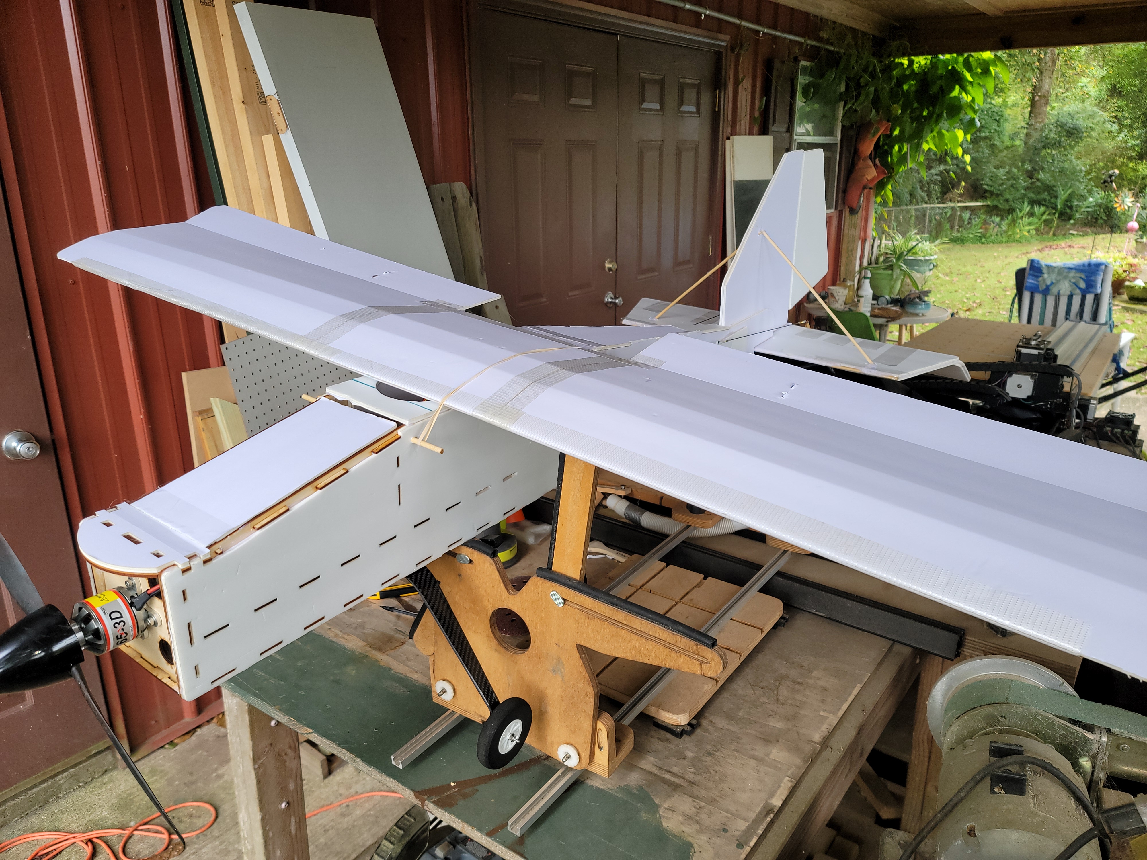

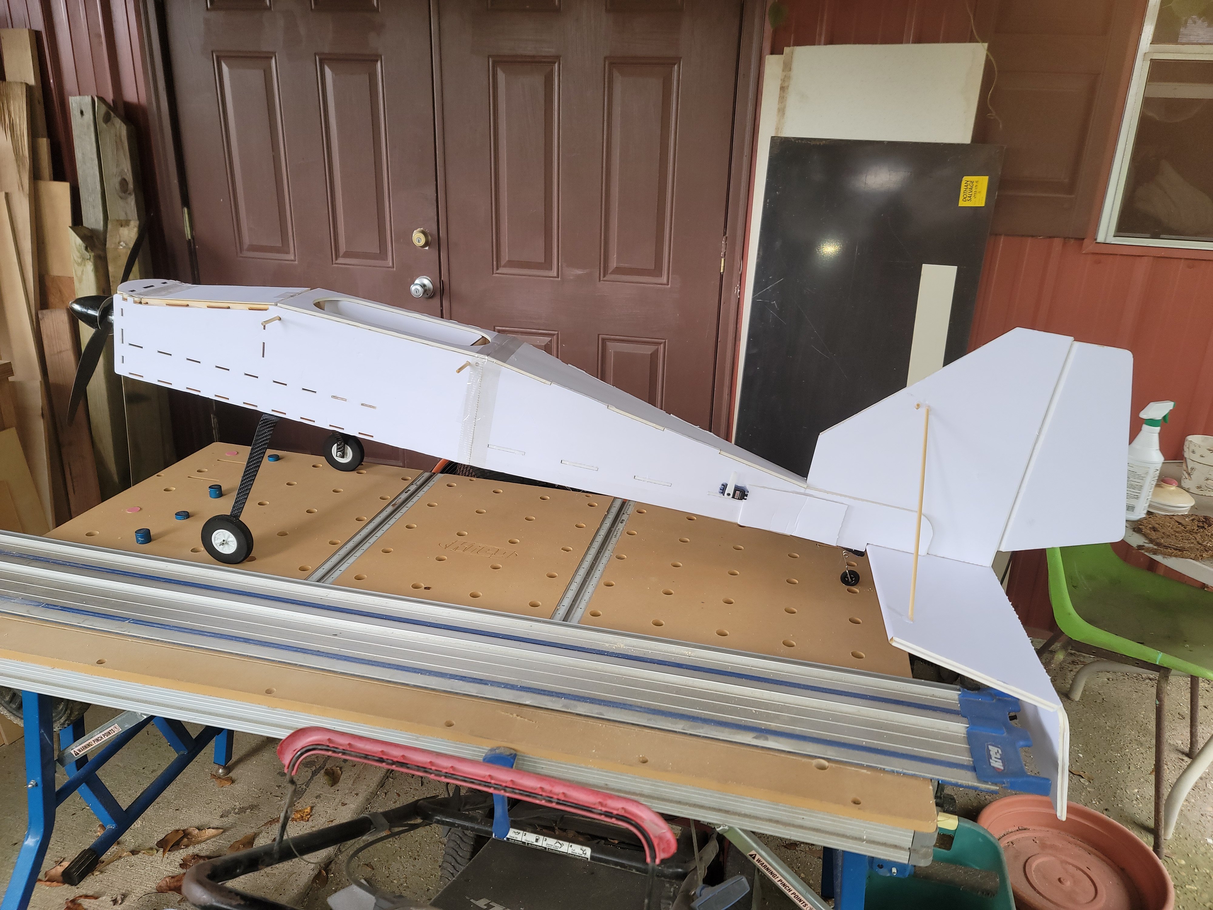

Flying Monkey fab
Working on it a bit this afternoon I realized that just existing out in the shed is destroying it due to LA (lower Alabama ) humidity . Now it is a race to see if I can finish and fly before it just falls apart. So note to self , if it is too big to exist in the house it doesn’t need to be DTFB.
Flying Monkey fab
It is finished, and if the weather plays nice tomorrow, I can see if it will make it around the pattern.
This is the "lessons learned" post.
First and foremost, if it can't fit in the house and you live somewhere with high relative humidity, don't use DTFB. If I was starting over on this I'd definitely use insulation foam as this build is dying due to stage 4 foam cancer. I'm not going to stop using DTFB, I love the stuff but I'll also keep them down to 60" or less so they can stay in the house.
The next big lesson is to get organized. For the physical build, this means thinking about the order of the build, etc. For design, it means organizing (and you need to preplan for this) things into folders. In Fusion, they are called components and are nestable making it where if you plan right things can stay very neat. I ended up with a hot mess that luckily for me Autodesk planned for. Yes, even when there are 50+ sketches all bunched together you can find what you need in Fusion because they make things highlight. Thank you, Autodesk, but I will do better next time.
I'm not going to do much if any color work as she's dying anyway. Just going to try to get around the pattern.
