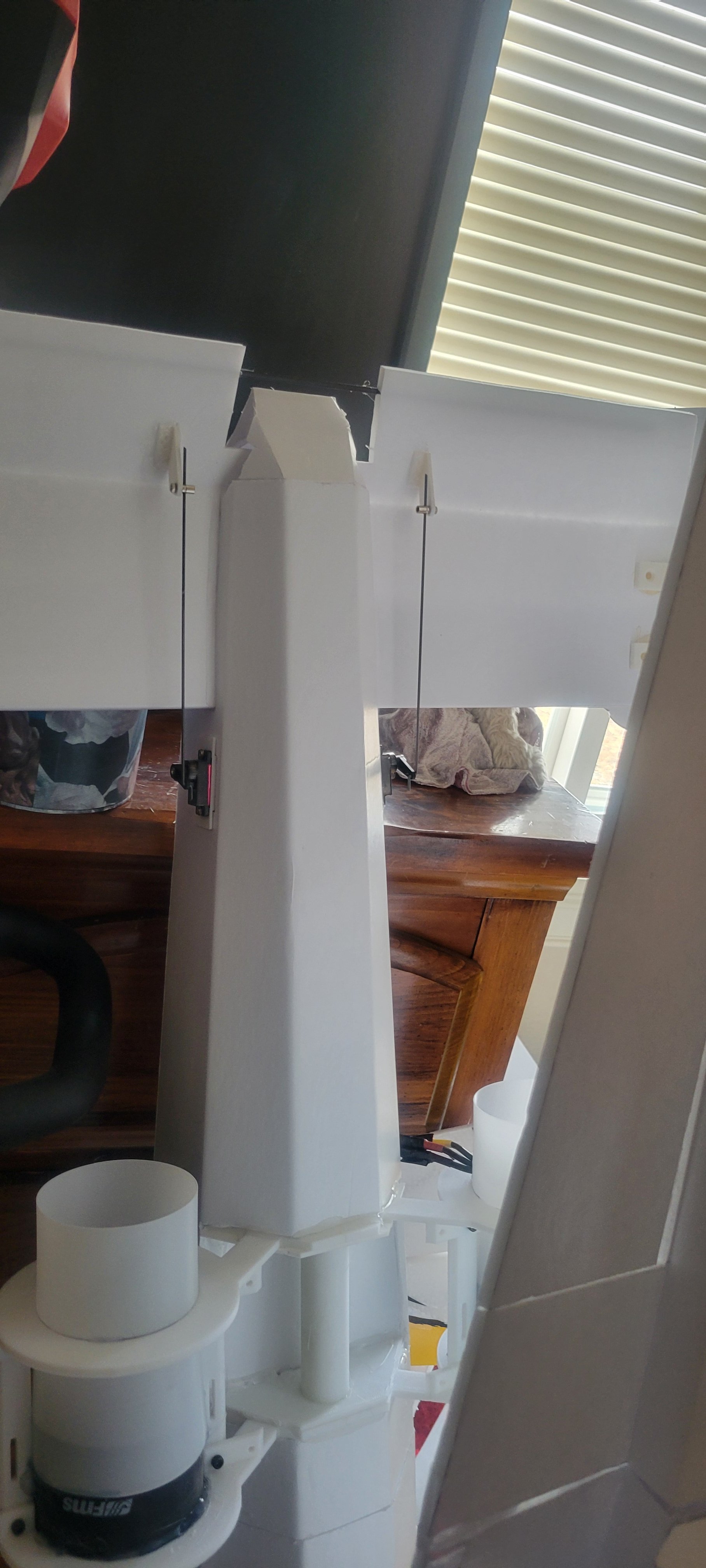

I think I figured out what went wrong! So as I was coming around I was picking up speed I think partly the servo was cold, but mainly the servo is placed so that it pushes the control rod to go up...I looked at it this morning and sure enough it was bent some!
RickHunter
I bet you that was it. I have a dual servo setup, and modified it to pull on the up, on my twin 70mm A-10. If you bandage it back together, easy modification.
Yup! It sure makes sense! (y) (When I looked at the onboard footage I could see the elevator wasn't moving upward...And I am 100% sure I was full up on the elevator!) When it did fly it actually flew SUPER EASY! And the sound and size.....😁😁😁
