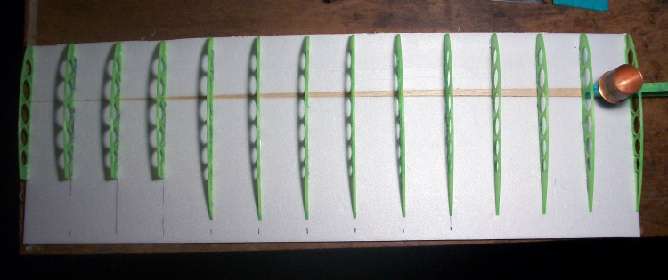

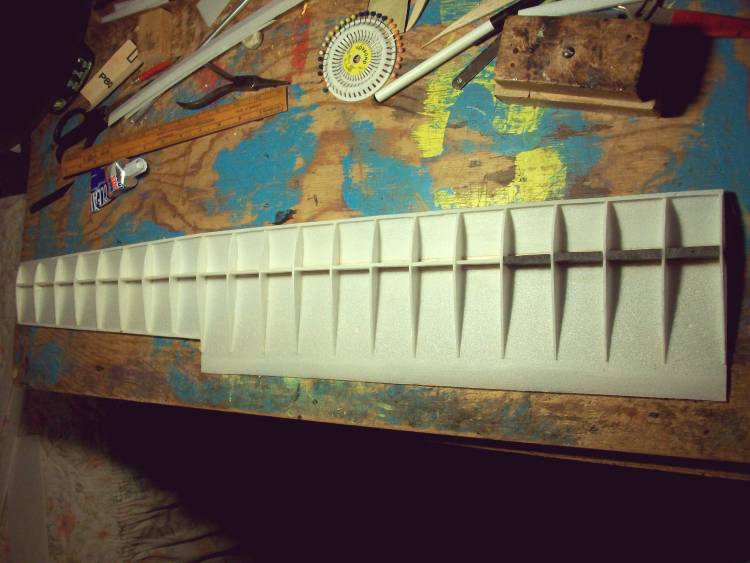

So I'm doing this Ryan's Rebel . Scale wings up a bit 86 Inch . Basic armain wing from experimental Airlines. Would build them differently next time
The fuse ,rudder ,elevators is out of 1inch pink foam . Cut from the plans.

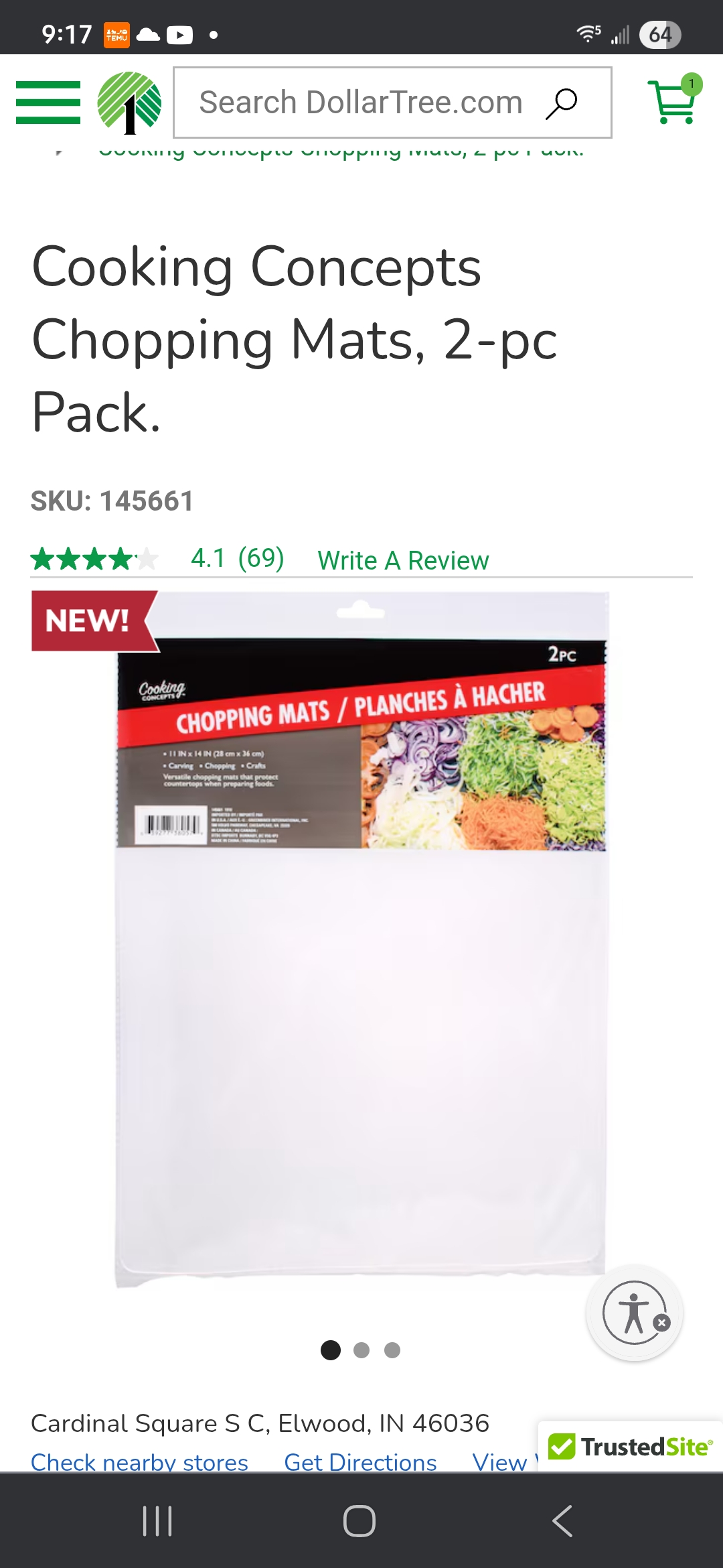

This is what I'm using for control surface hinges for elevators and rudder cut into 1x2 strip hit with sand paper and glued in with gorilla glue

Next time I will cut the ribs out of foam ,like it was balsa. The 1 inch would work then sheet it with dtfb . I did the armin wing and here is the video of it . I find showing everyone what techniques I use could help them and new people that would like to learn .
