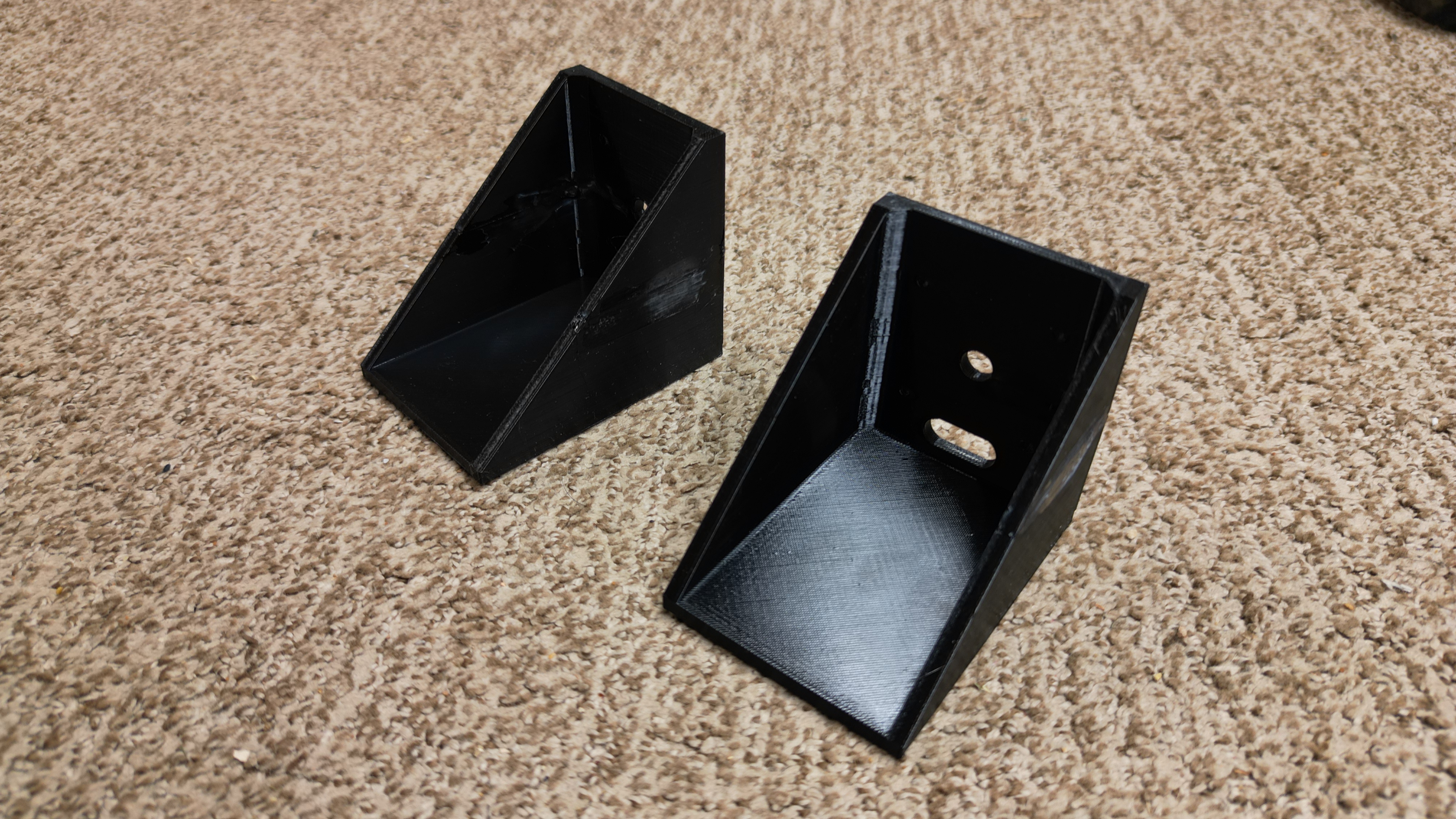

Got the firewalls printed out!!

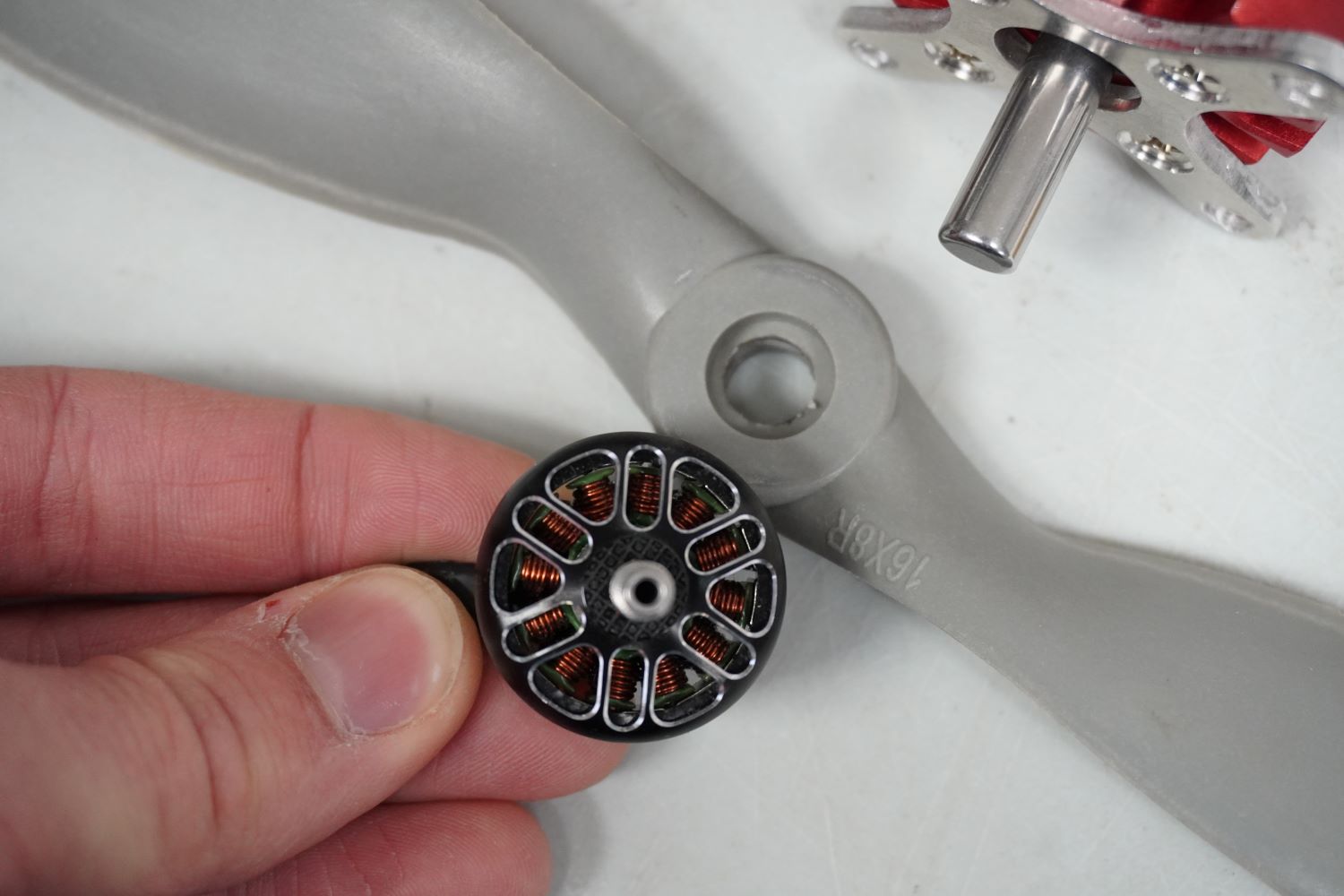

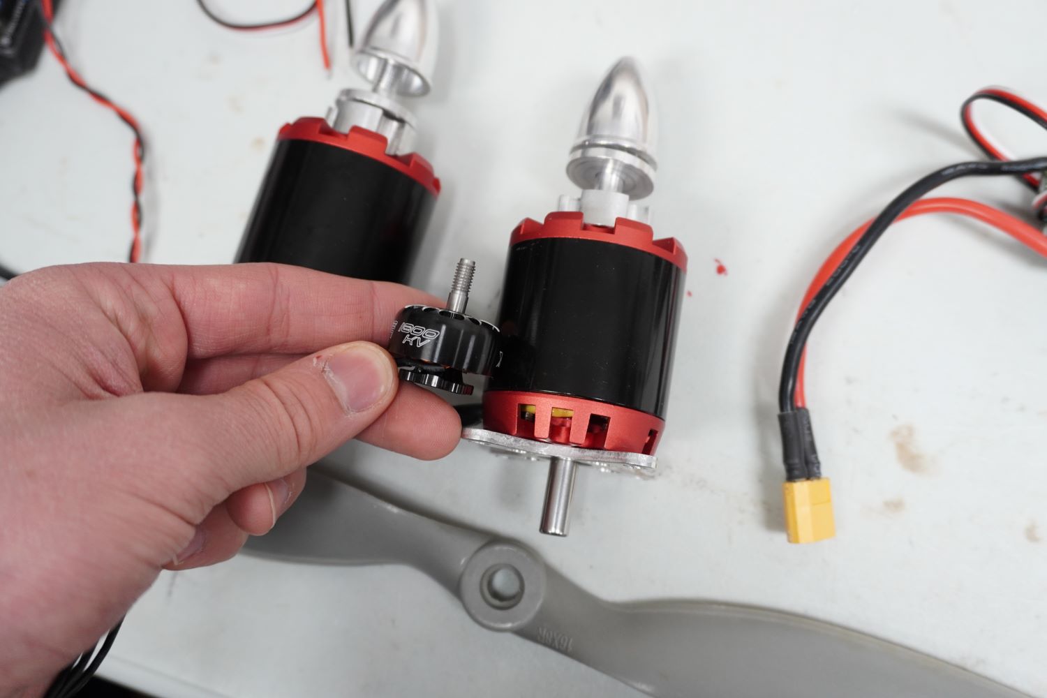

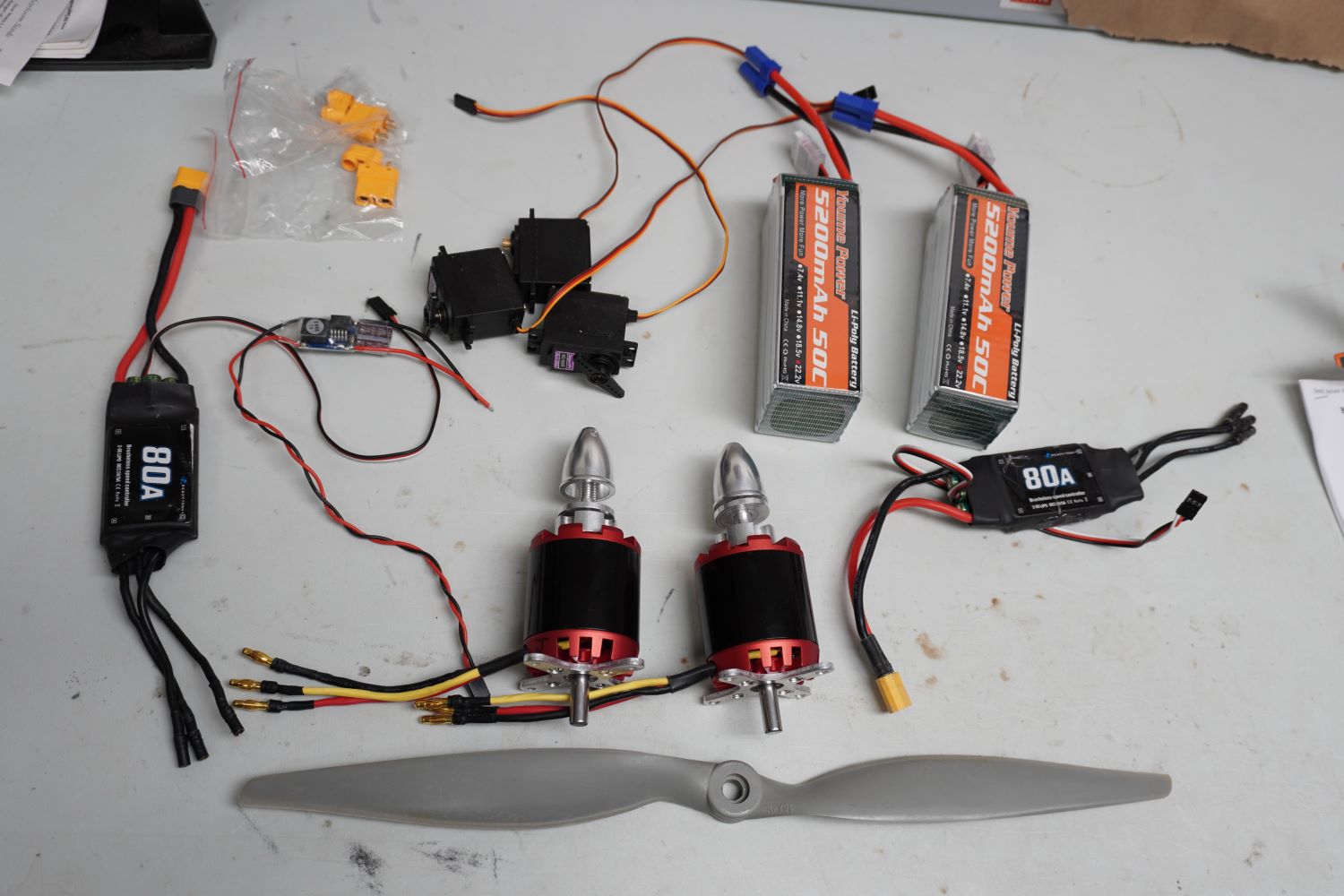

Did a thrust test today and I got 10lbs on a 16x8 prop..And it only drew 40amps!...I think we are going with some 20x6 props which should give us about 15 lbs of thrust apiece, giving us a all up thrust off 30lbs!....The plane will weight about 10-15!
