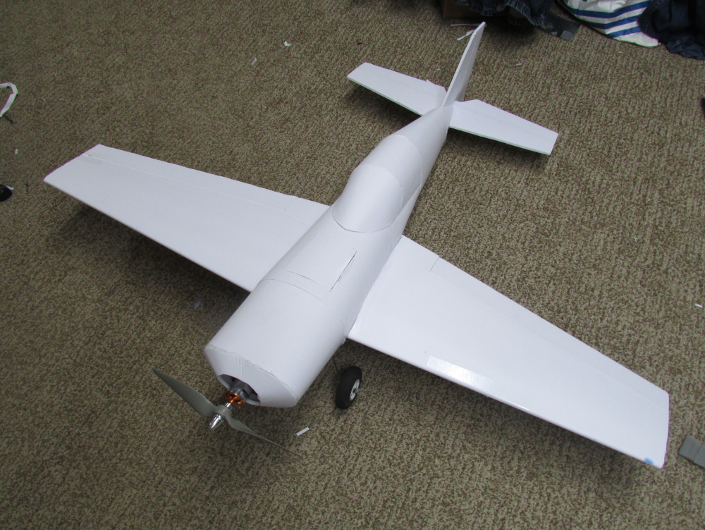

All done except for paint!
So I ran this today on a D2836 1120kv...It's gets REALLY hot when I am running it with a 9x6 prop on 4s and doing a lot of high throttle stuff which i like to do) so I decided to get a D3536 1000kv running a 11x5.5 prop...We shall see if that's better!

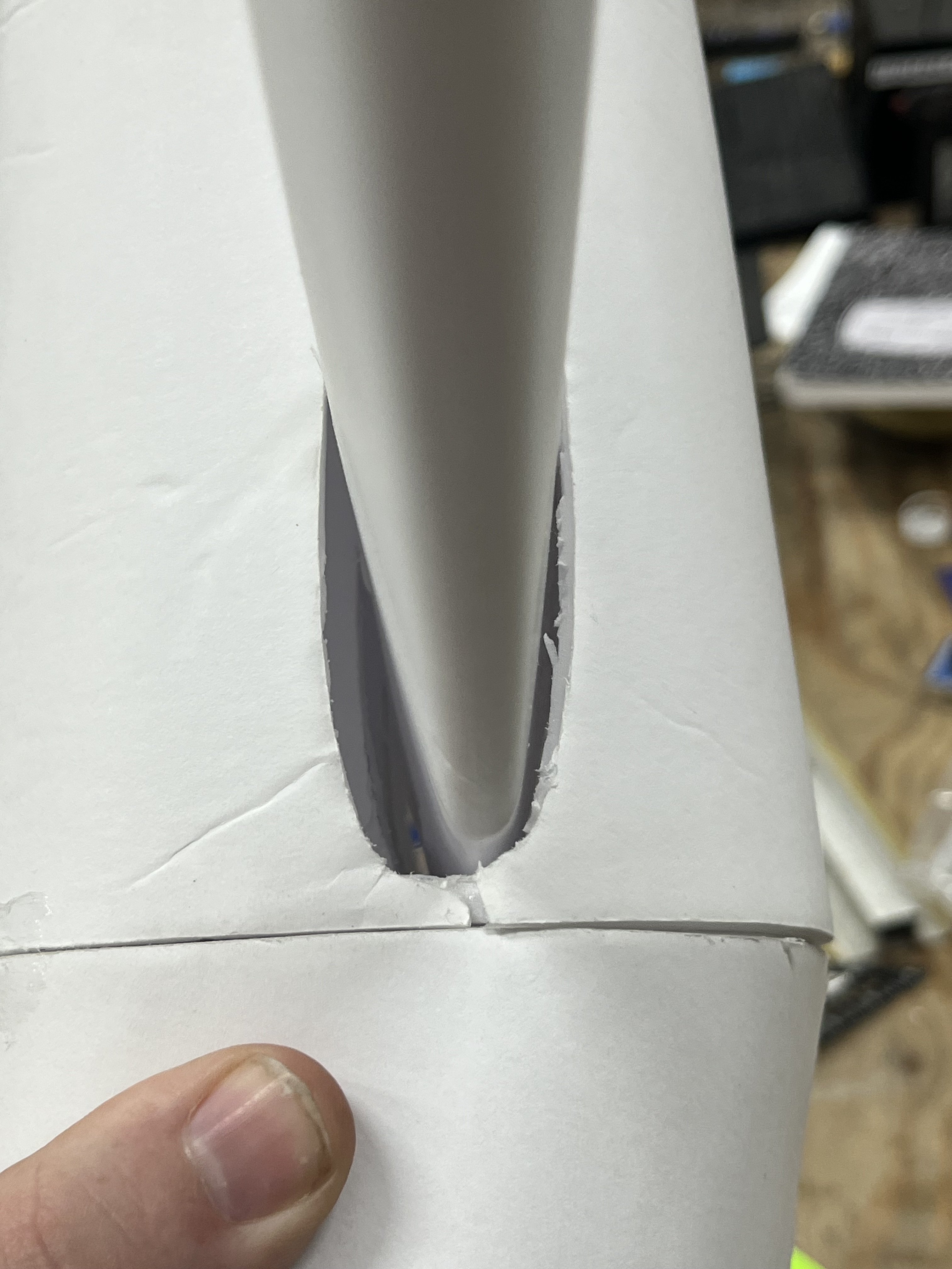

i made one of these last week but the shape of the win saddles on the fuse and the shape the wing airfoil comes out to are no where near the same. anyone else have same issue?
The formers on the fuselage require you to cut a chunk out of them so the wing can slide forward farther. Don't know if that's the issue though. If you send some pics I could probably tell you the problem. (y)

I’ll take some pics tomorrow the wing saddle and airfoil shape on the inner square support are a perfectly round and symmetrical profile but using the plans the wing profile comes to a point instead of round like the saddle and there’s a big gap above and below the front part of the airfoil
