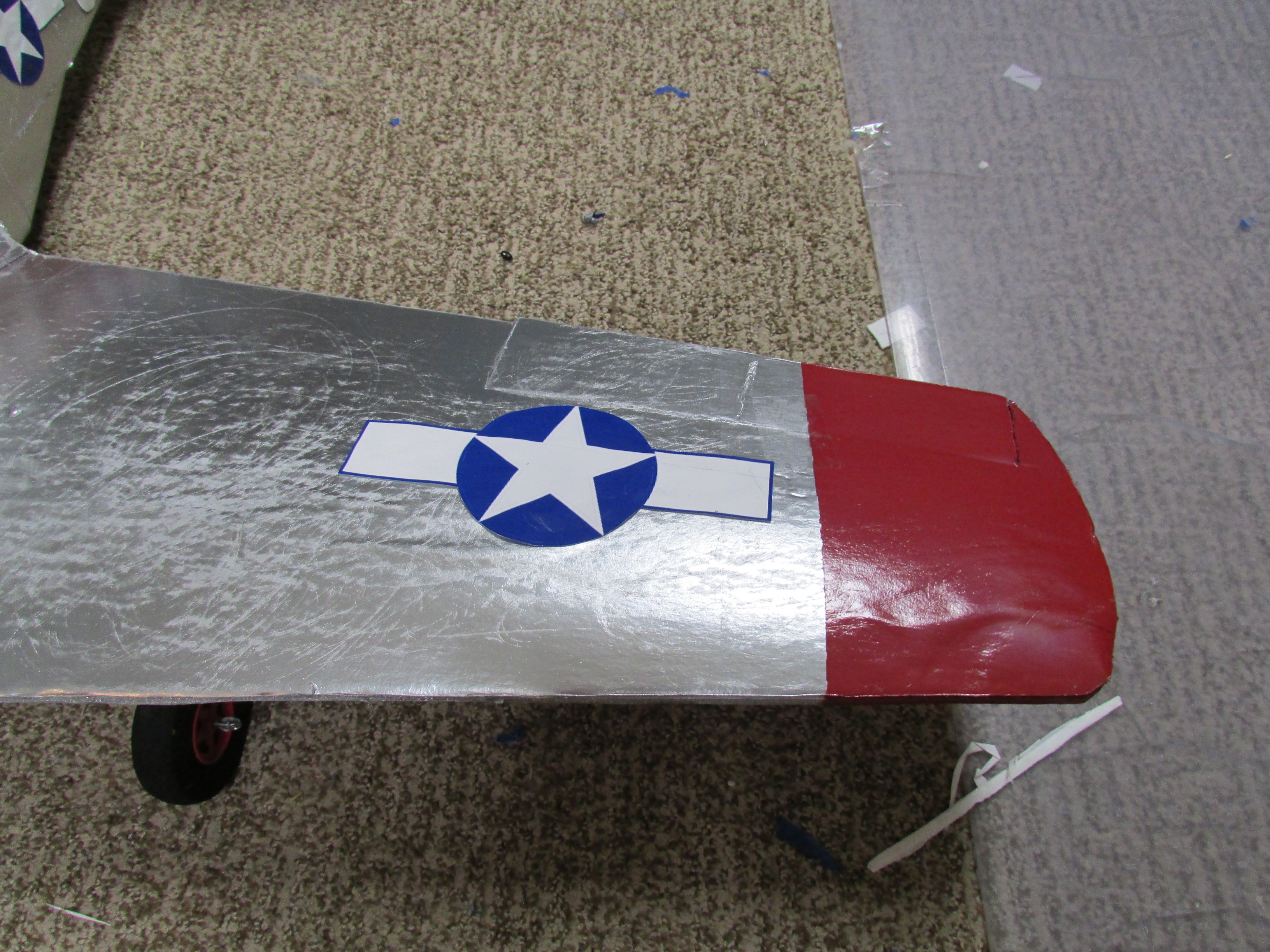

First I put on the Silver coat of paint.
Unfortunately i sanded it with too low a grit sand paper. so it went through the water proofing, so the paper wrinkled a little bit, also the paper got scratched.
Then I painted the nose, wing tips, and tail stabilizers red. Next I masked of the canopy and nose.
Then I added the decals.
Here it is When it is done.

when you sand it do not use a low grit sand paper,
If you scratch build try to be precise when cutting out the pieces (it will go together better and easier),
