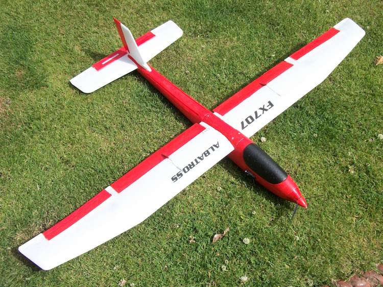

My FX707s Albatross RC conversion not with brakes but with big flaps.
The flaps have 3 positions 0,15 and 50 degrees. By trial and error the elevator has nose down trim compensation included with each of the positive flap settings. Intended to be a good glider is has a 6x3 folding prop and uses a 1500mAh 2s.
A short video of it using the three flap settings.
A smooth flyer. Note how slowly it flies and lands with full 50 degree flap.
