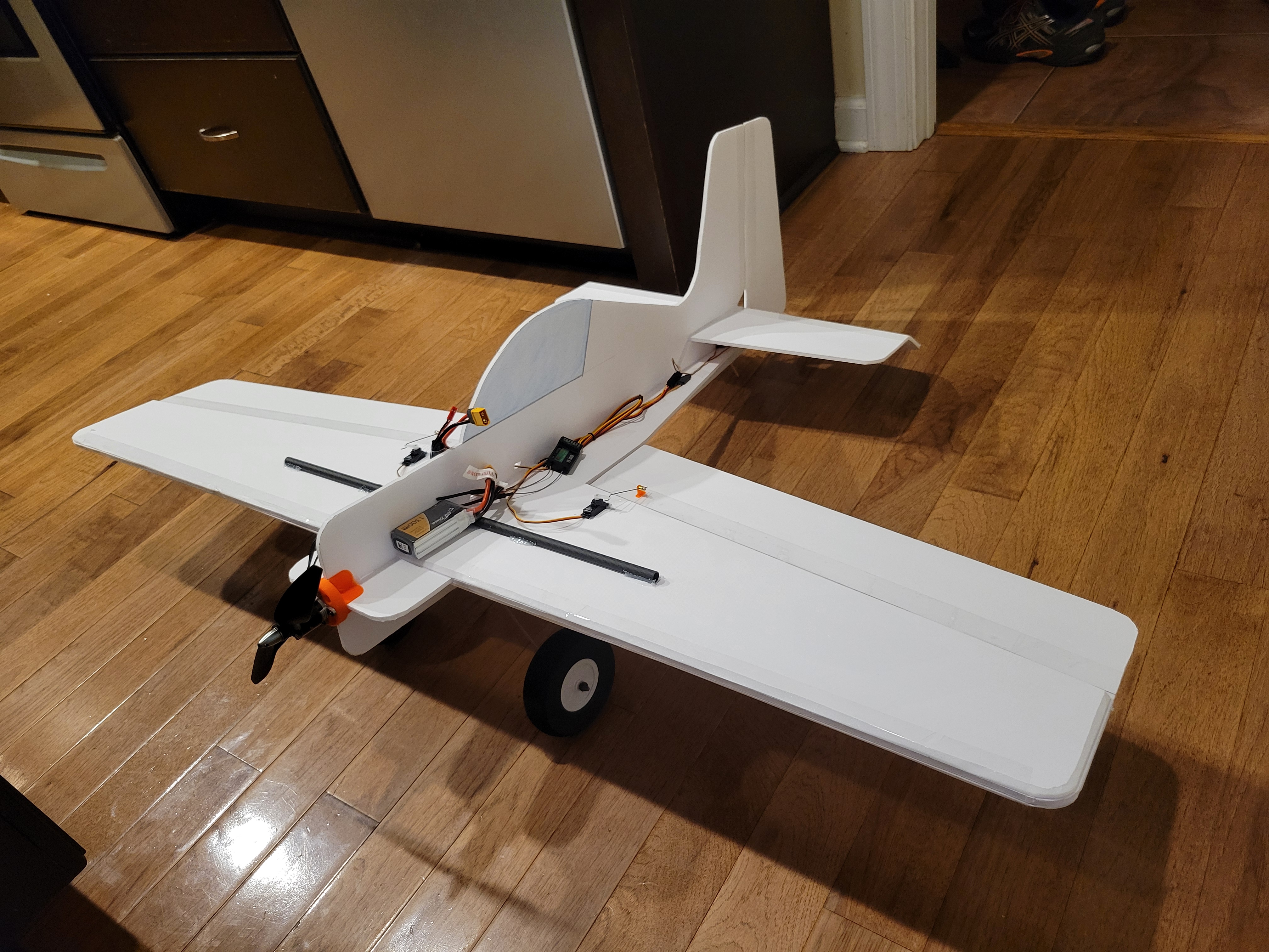

A profile aerobatic plane I whipped up in a few hours. Embarrassingly crude, pretty wonky flying, but it's wild what you can do with control surfaces that large. Salvaged for parts after a few flights.

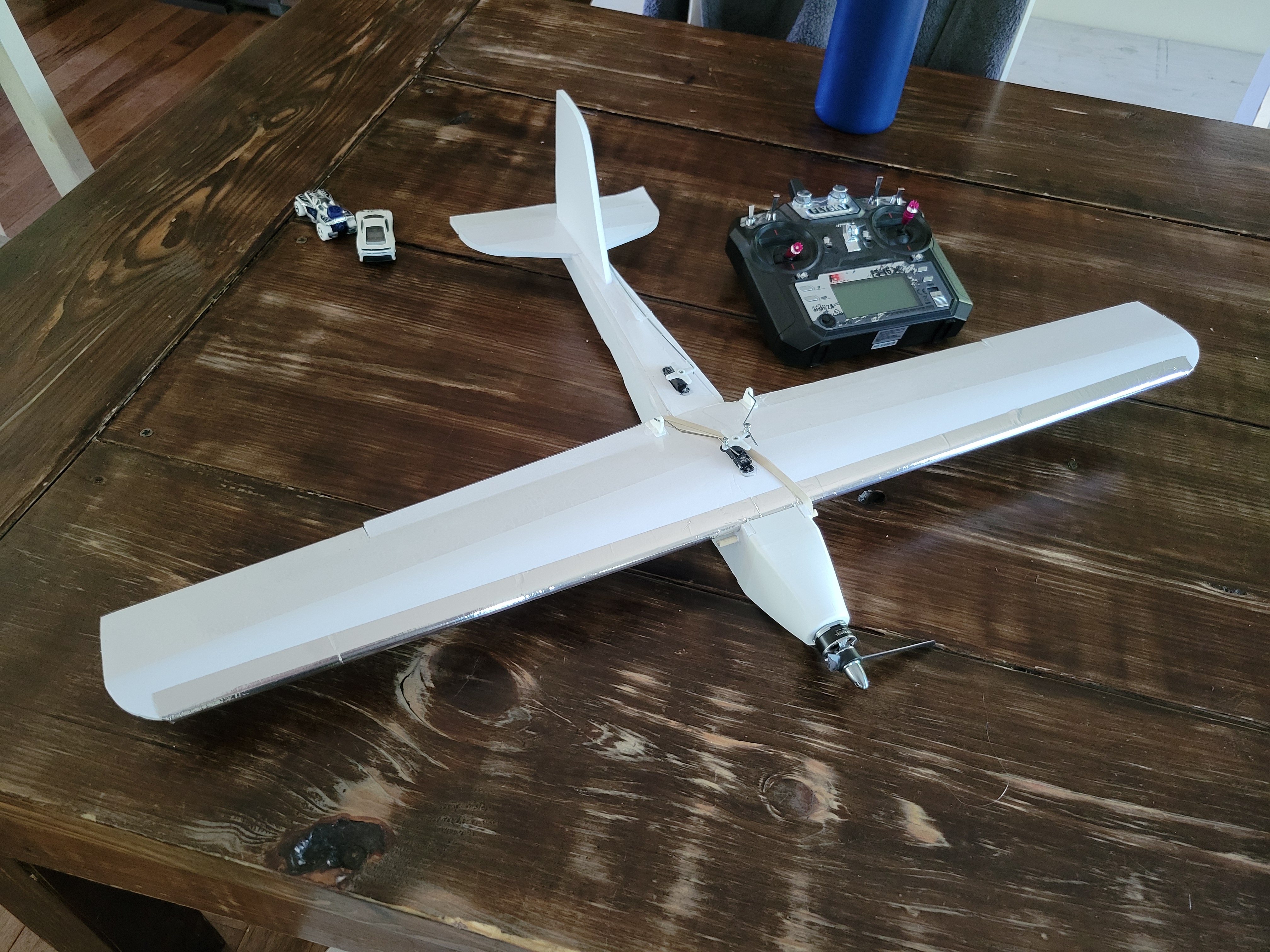

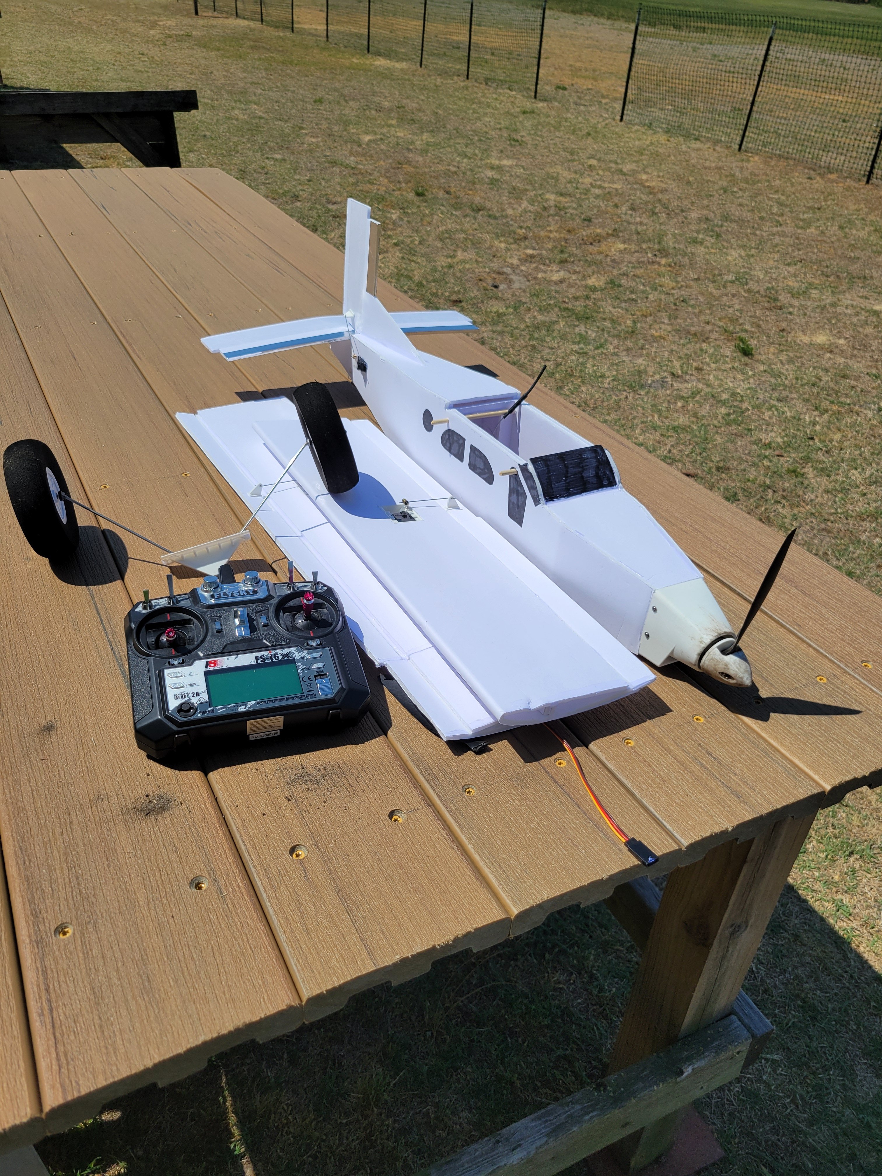

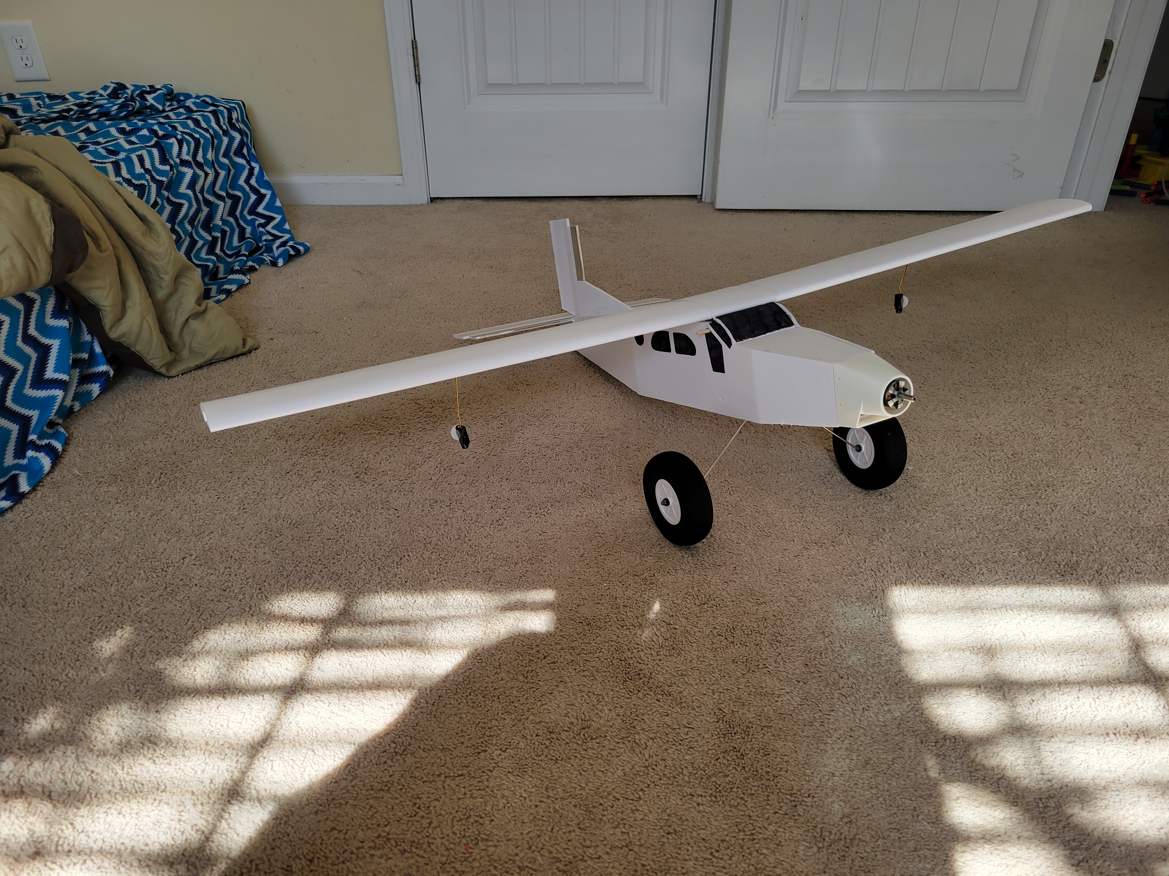

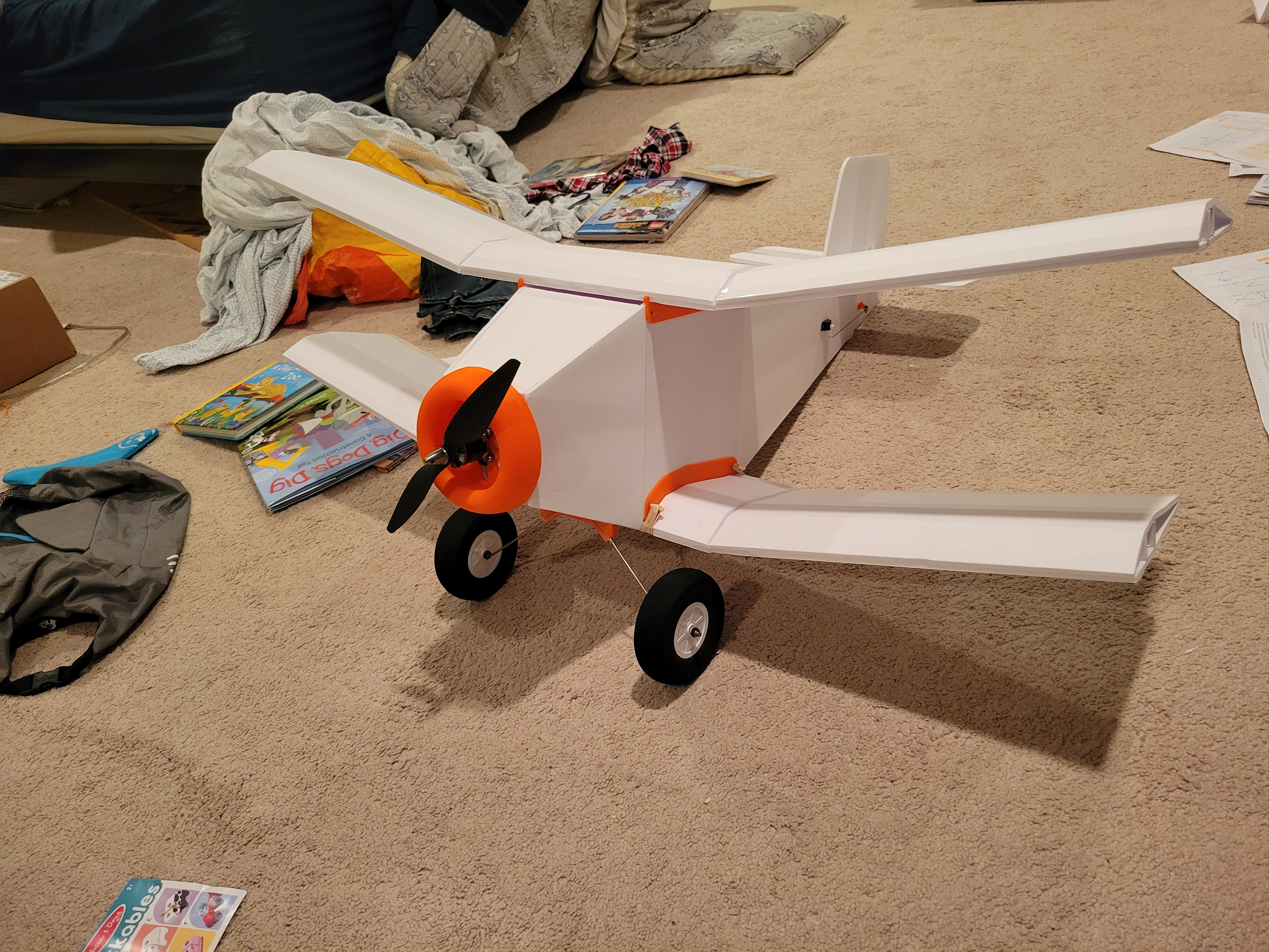

A rather scale (in profile, at least) Pilatus Turbo Porter. Flew quite well for about 20 seconds, then the wing folded in half. My mistake, poor construction. Ugly damn plane.

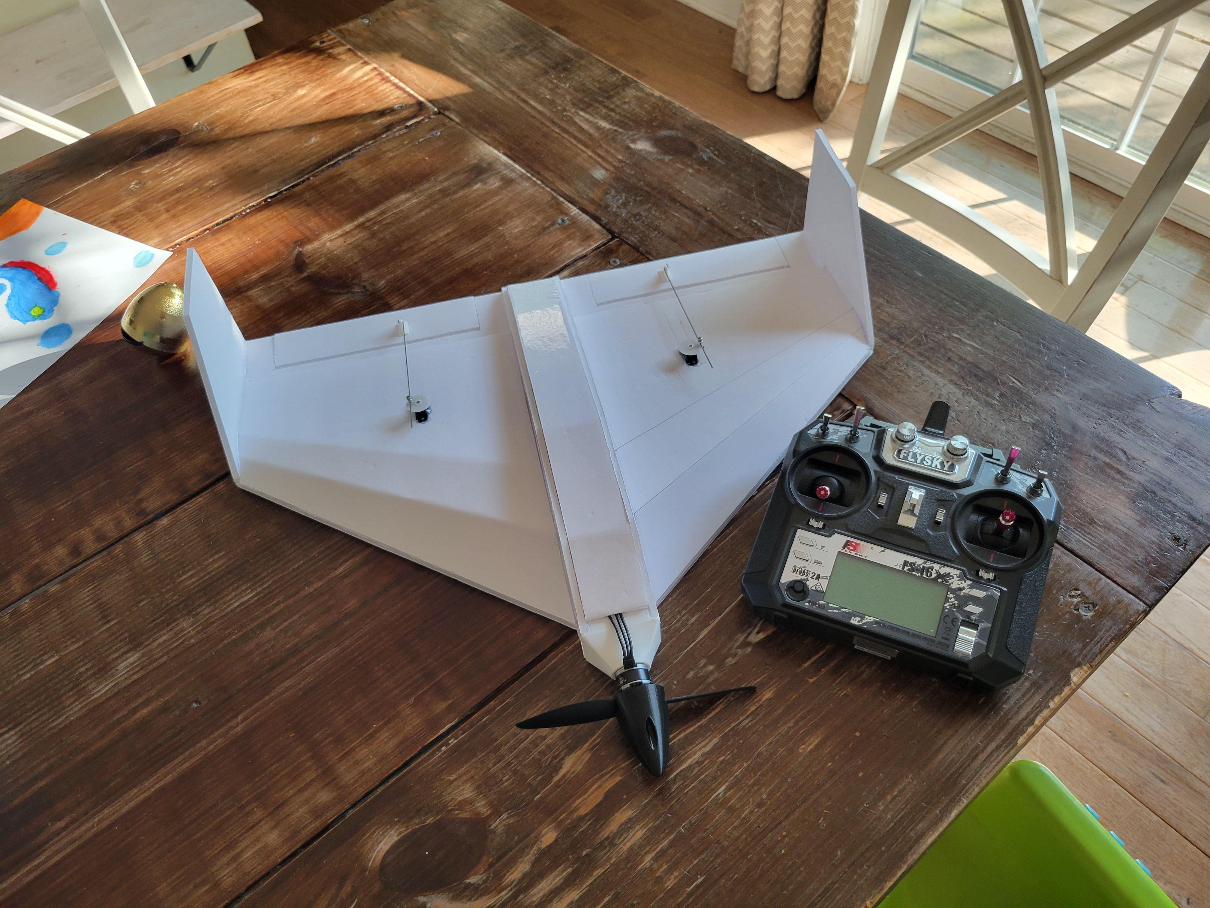

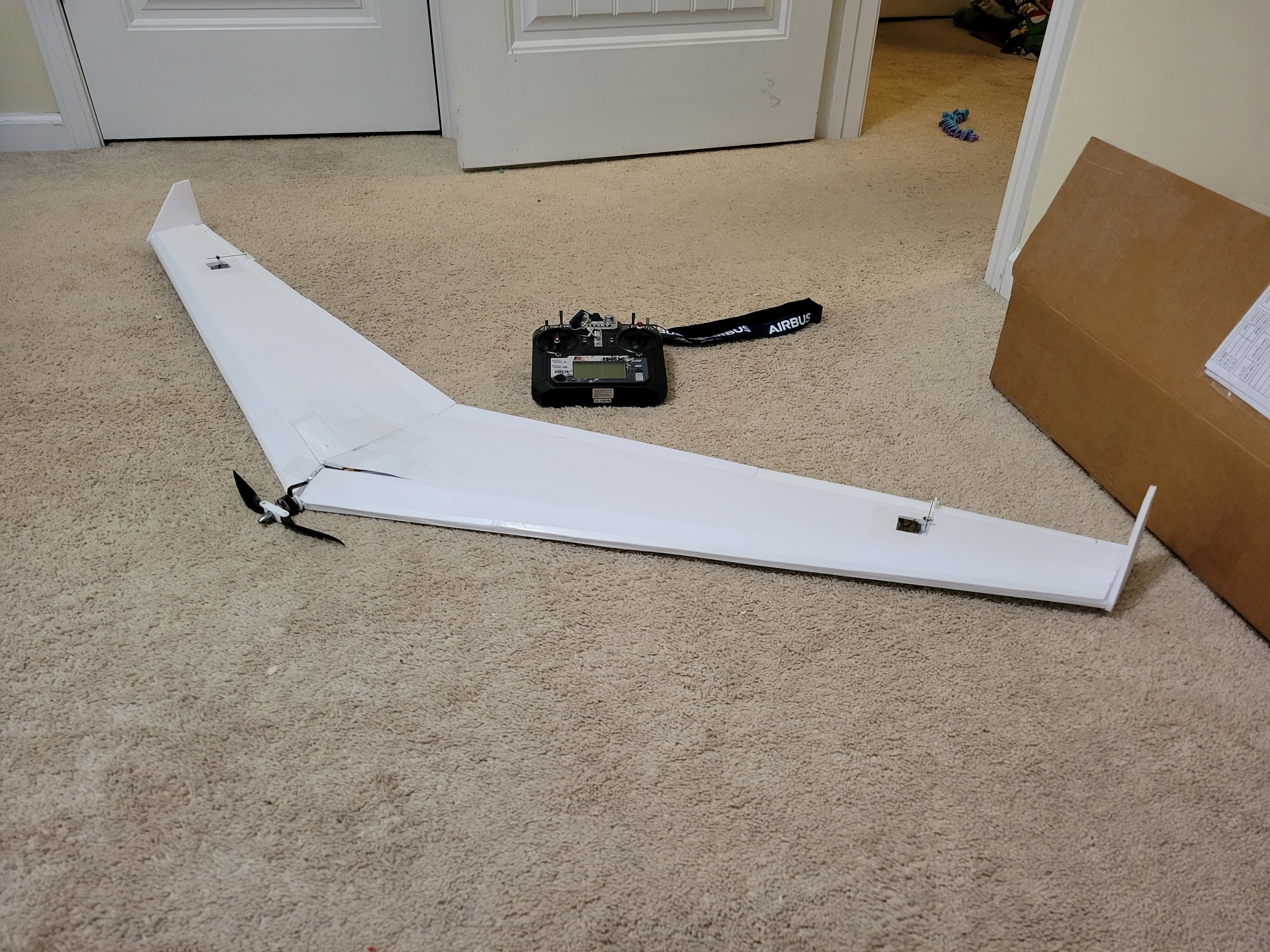

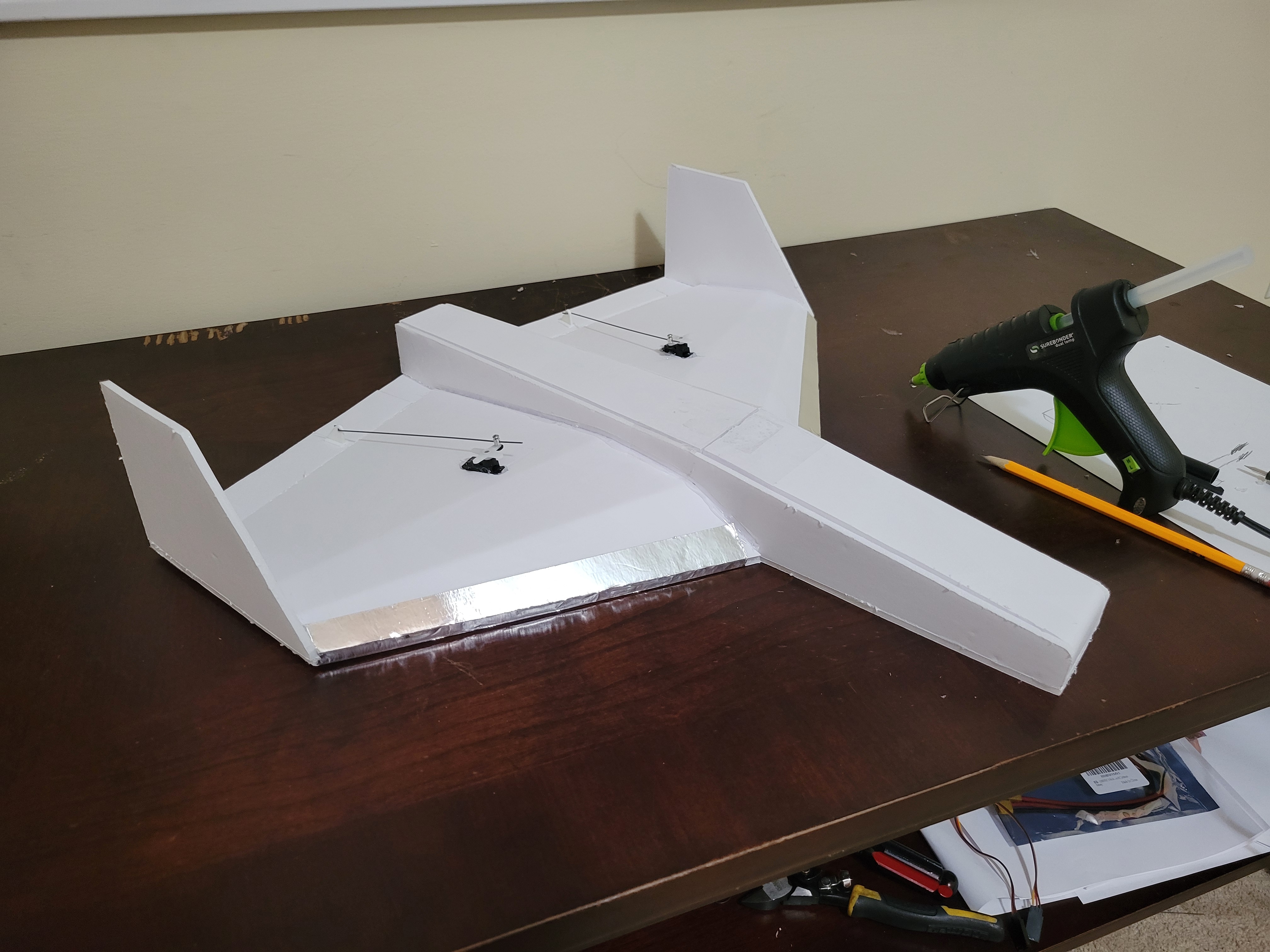

First attempt at a Delta wing. Didn't fly.
Second attempt at a Delta wing. Also didn't fly.
Third attempt at a wing. ALSO didn't fly. Why did my wings not fly? Because I didn't do my homework. I've since figured out how I need to build these and have tested with some hand-launch miniature wings. I'll circle around to making an RC wing again eventually.

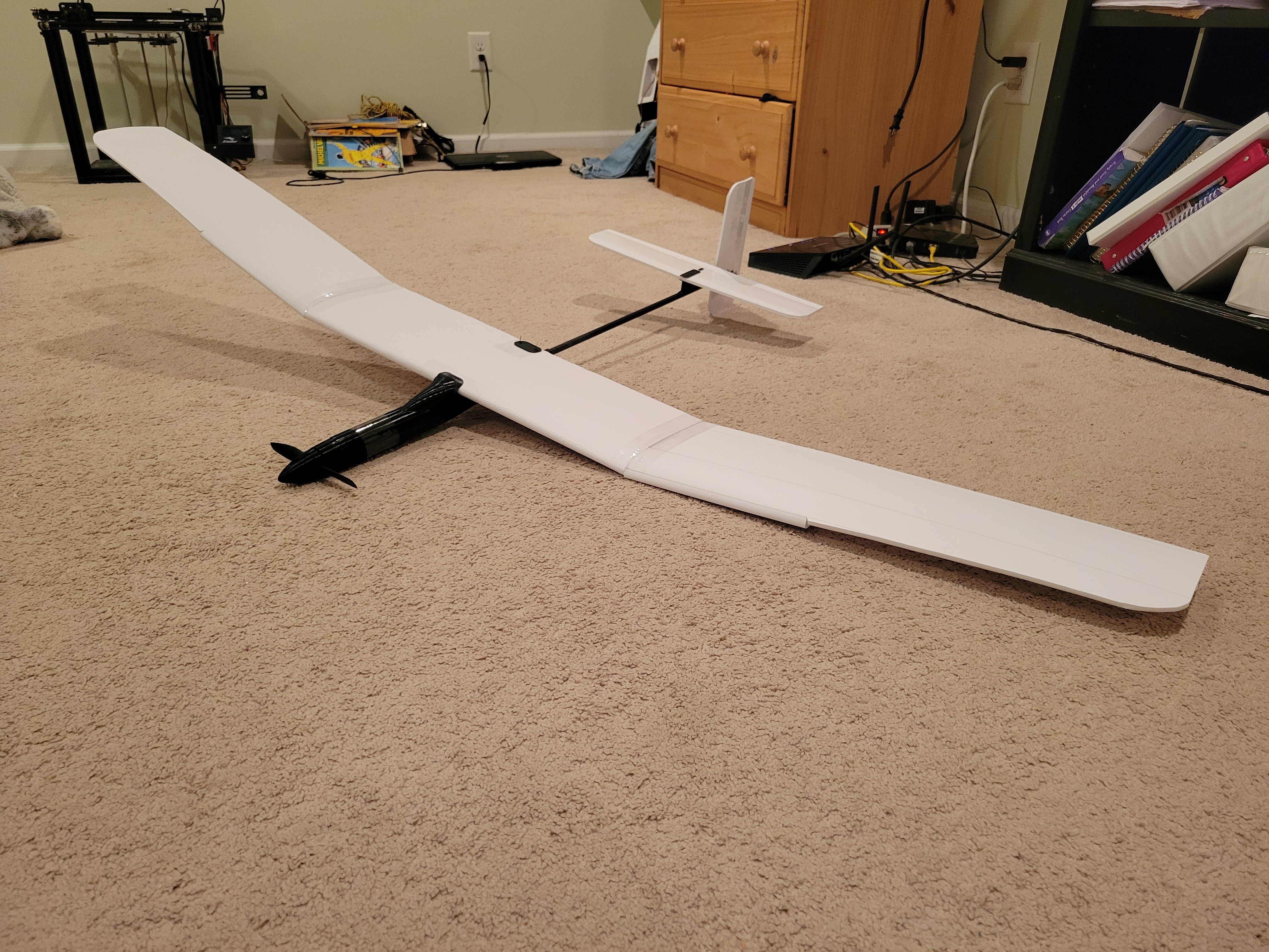

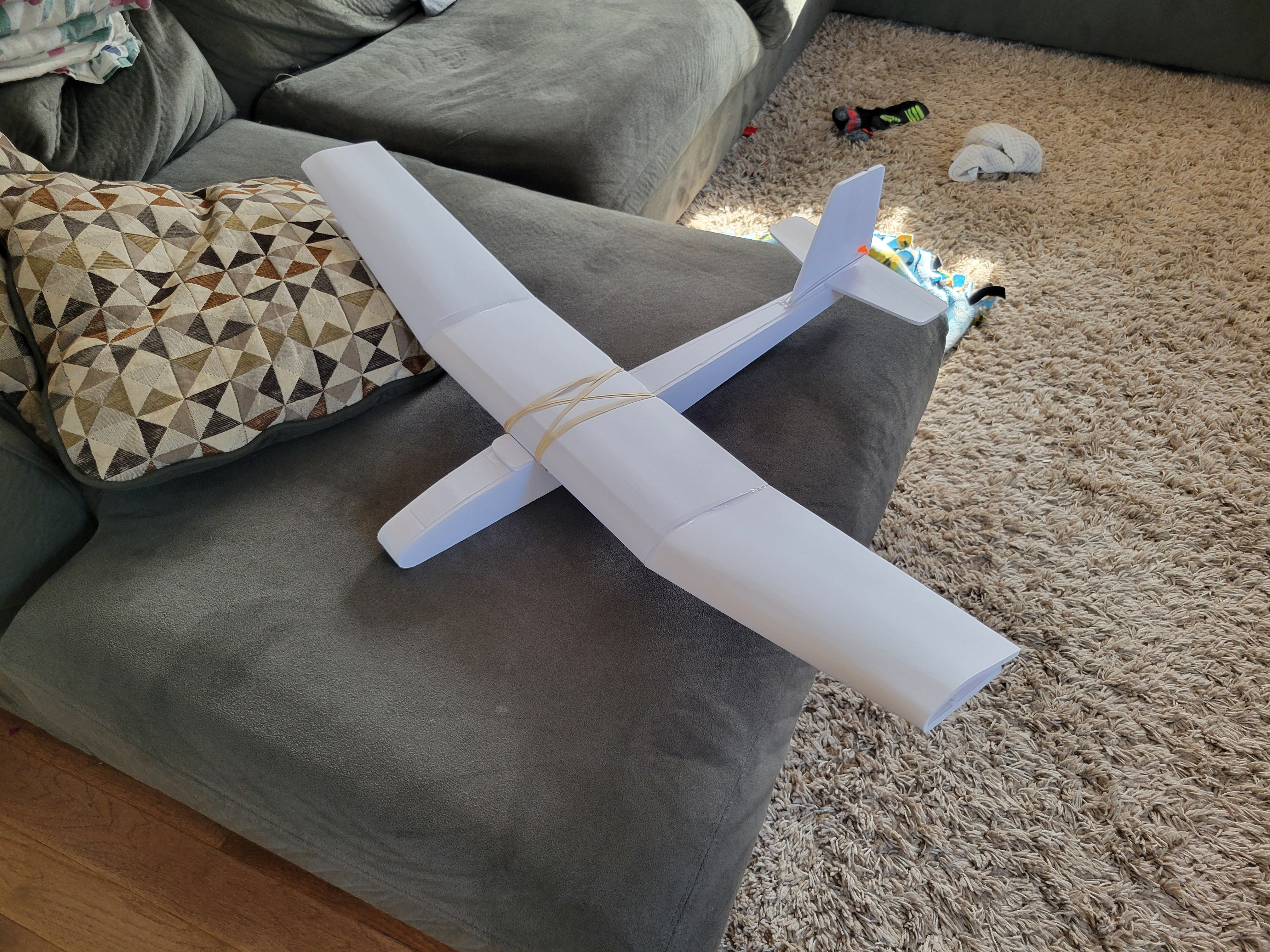

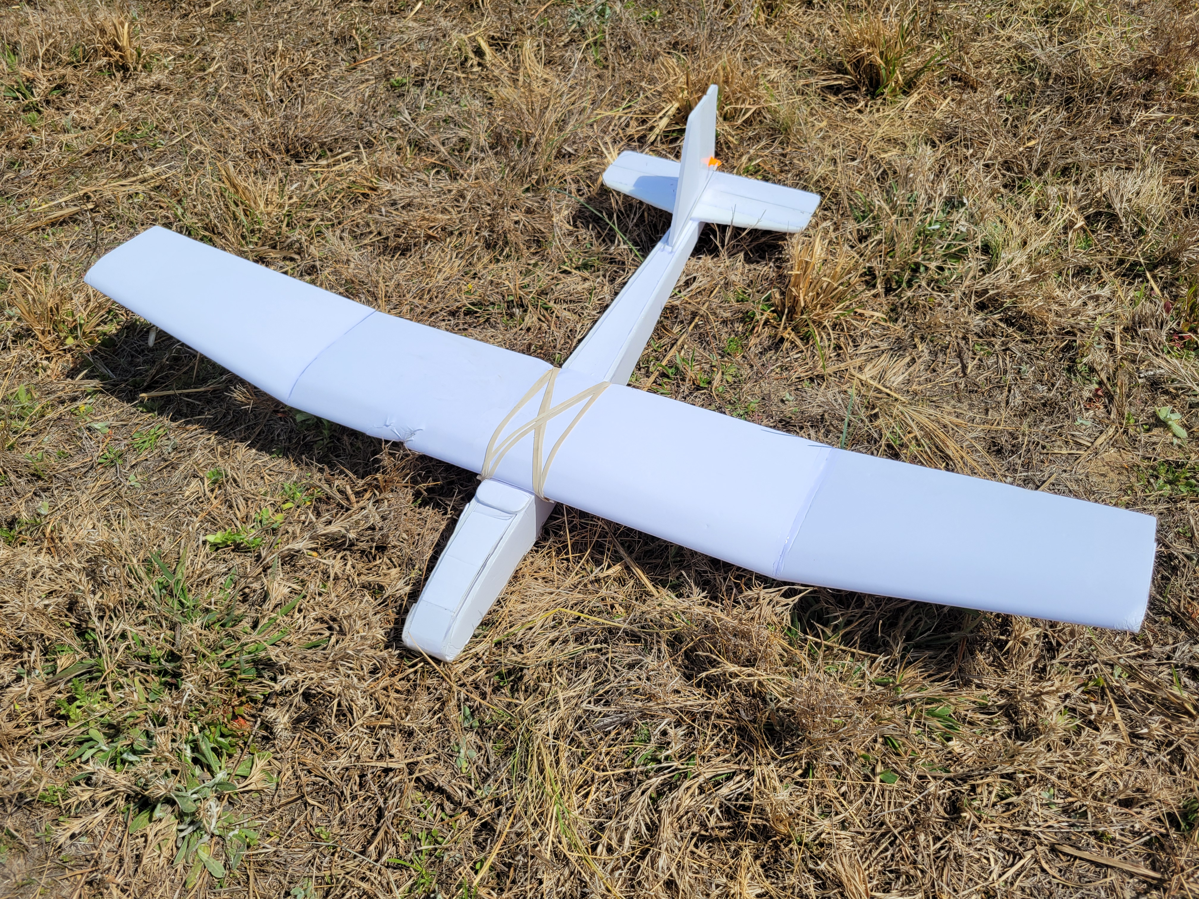

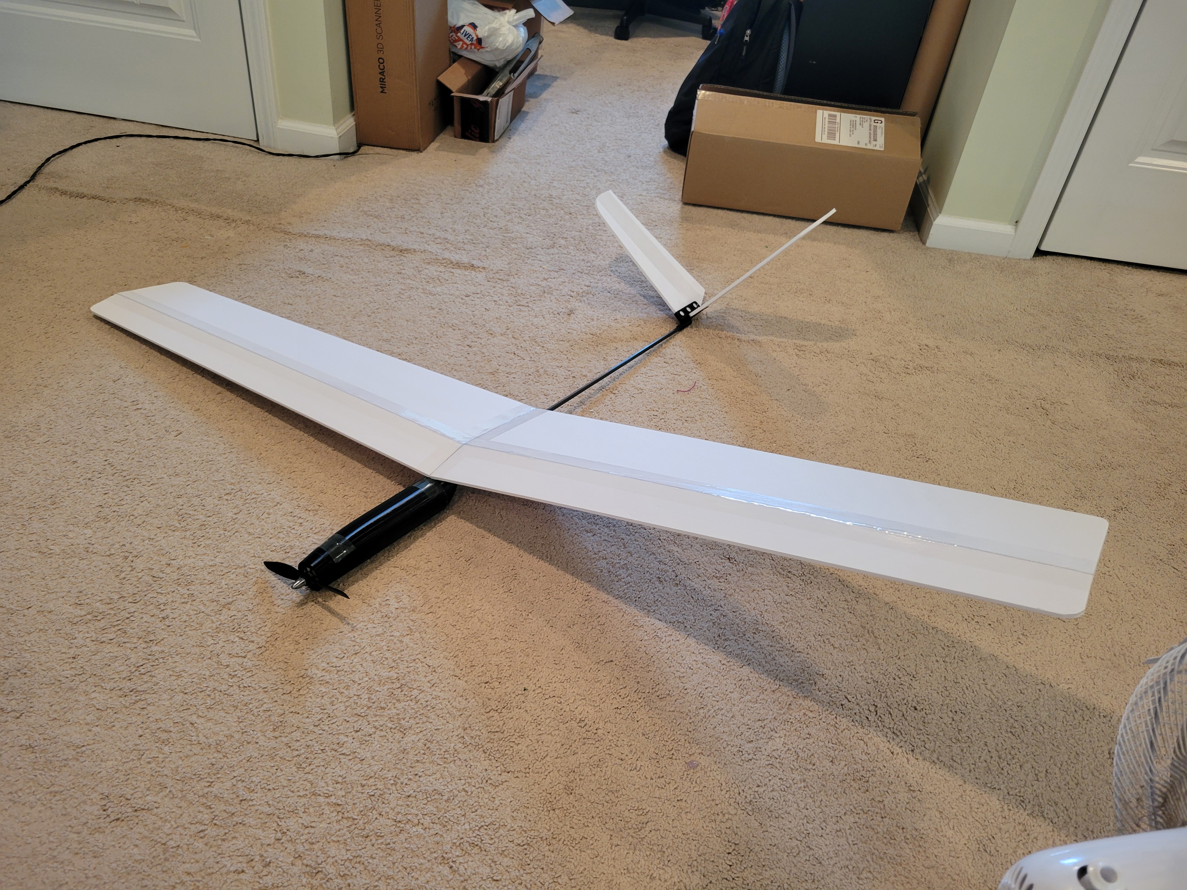

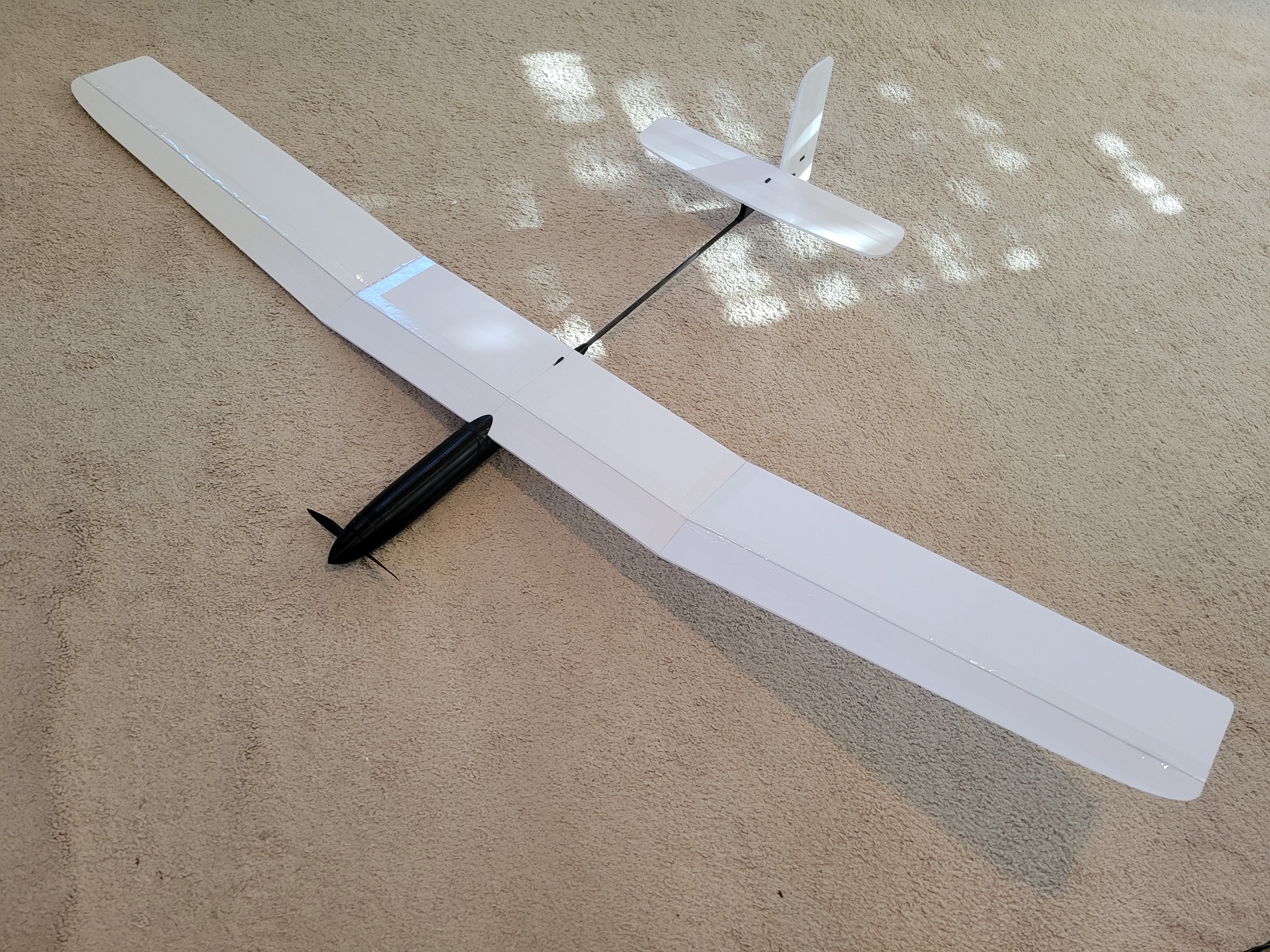

1m 2-ch sailplane designed for simplicity of build and flight. Not sure how well it flies, it has only had a few very short attempts, slope soaring is essentially non-existent where I live and I didn't have any provision for hi-start/winch.
Second prototype of the previous sailplane. Slight changes to dihedral, tail volumes, wing construction. Rigged a hook to the bottom for a mild hi-start. Kind of worked. Hit a power line. I'll circle back to this project eventually, too.

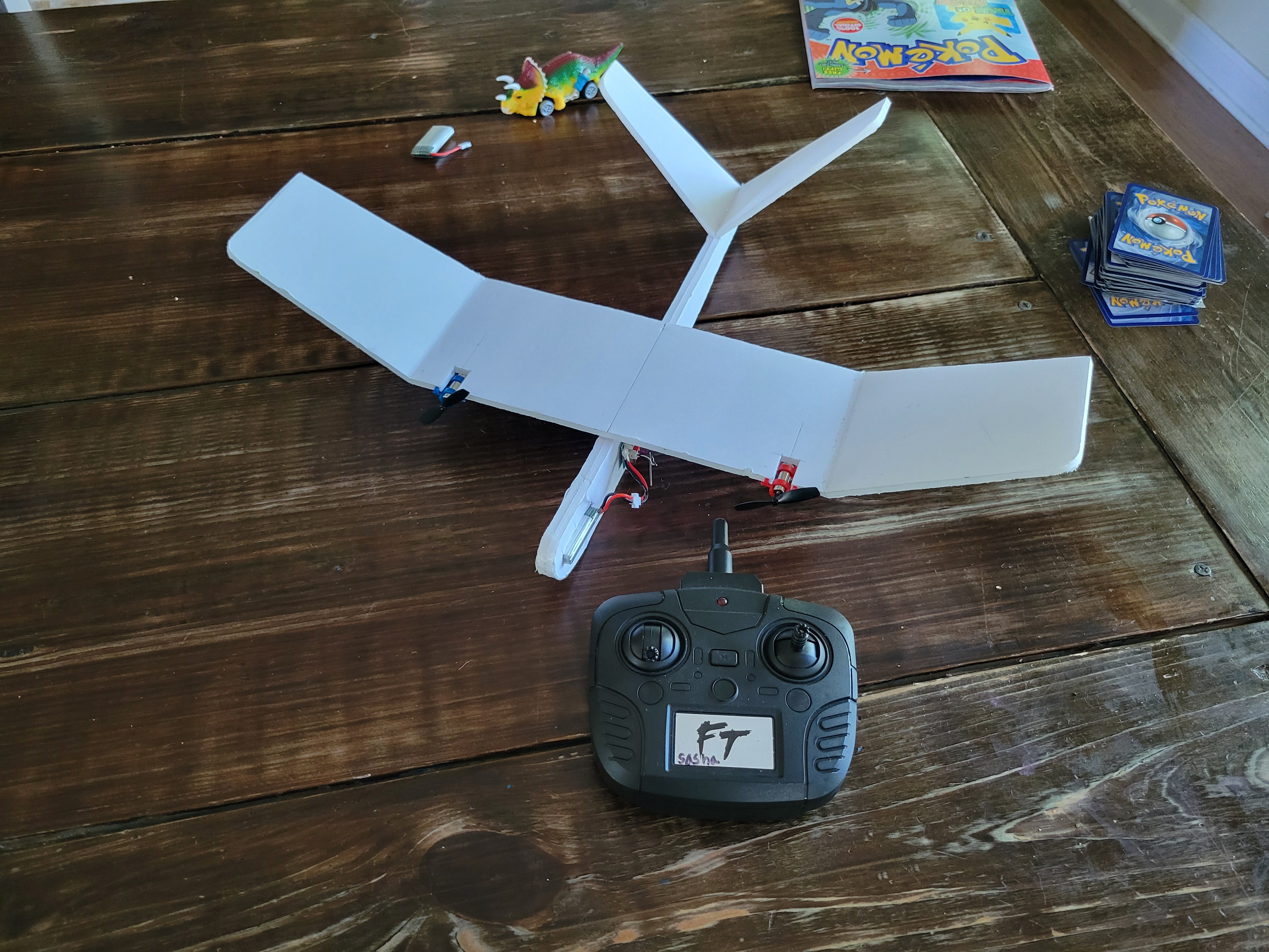

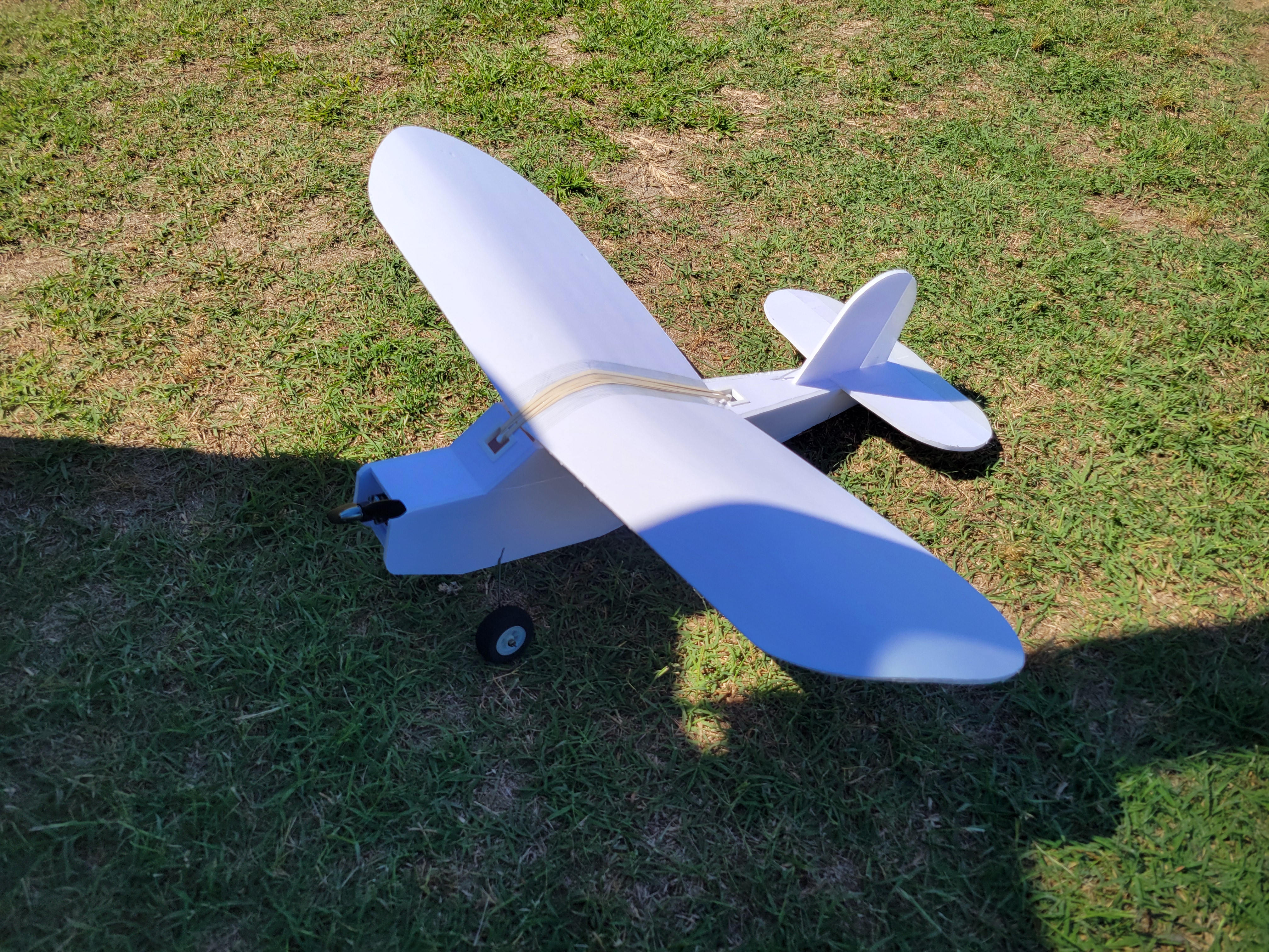

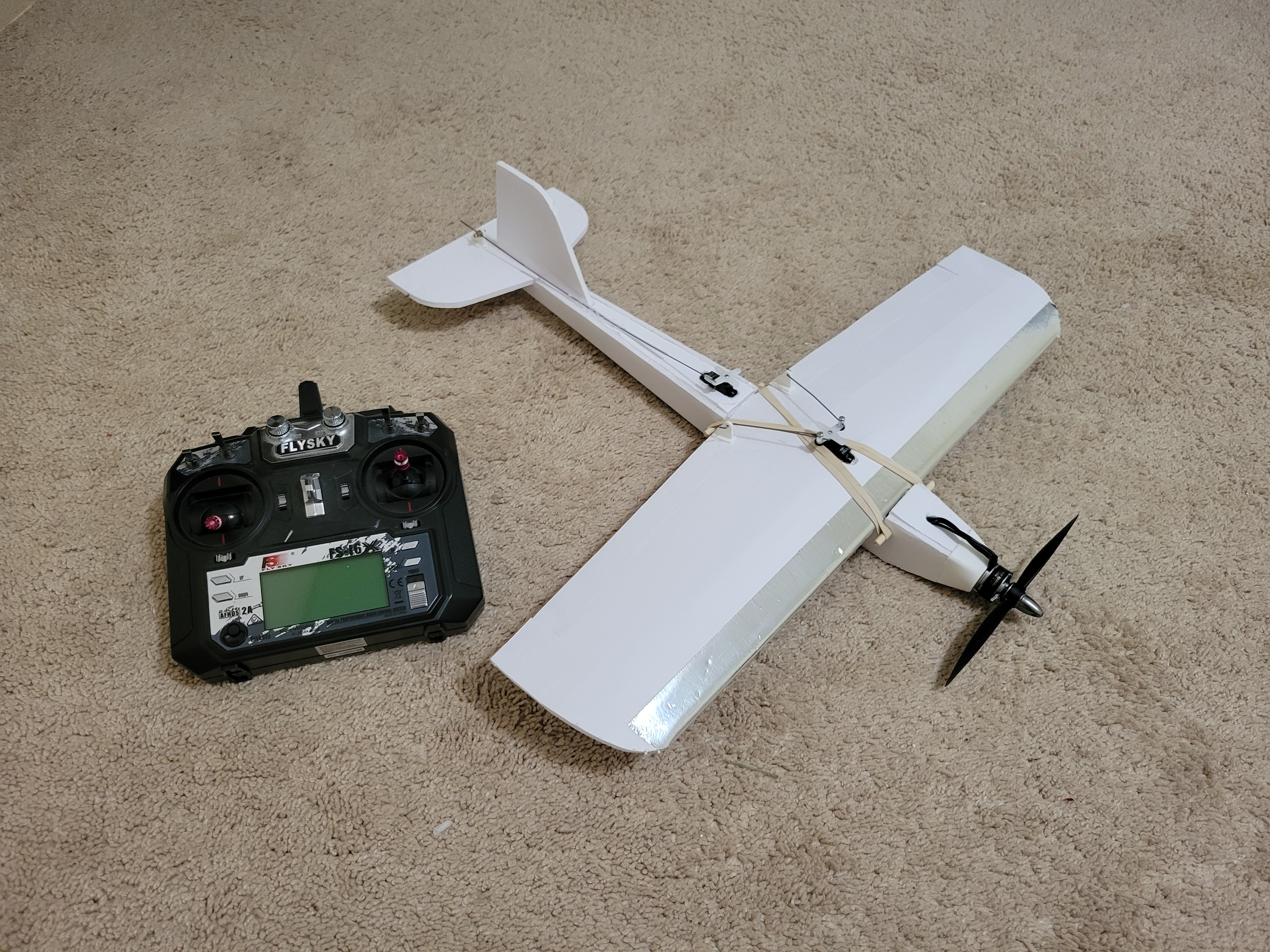

Little plane I threw together for my daughter using the FT EZ plane stuff. Flies extremely well and she does a good job with it.

I think the reason for the first and second wings not flying is they seem like they would be too nose heavy.. The last one looks like it would fly, but getting the CG would be pretty hard due to the short wing cord.
*Not sure, but just guesses....Keep on building!
Gadeirus
You're actually mostly correct! CG was an issue on the first two, but all three had the issue that I did not take reflex into account.

I really like the design of those gliders - I've been looking for a good 3D printed glider for a while but they're all too heavy
Glad you like it! The 3D printing is great, but yes, heavy and I get the impression that they're fragile. That's why I've yet to make a fully printed plane.
I use 3D printing on these gliders for the fuselage pod, tail group attachment, control horns, things like that and then DTFB for the wings and tail surfaces. I believe all of them have come in under 400g using the FT 1806 motor and 2S 800mah battery.

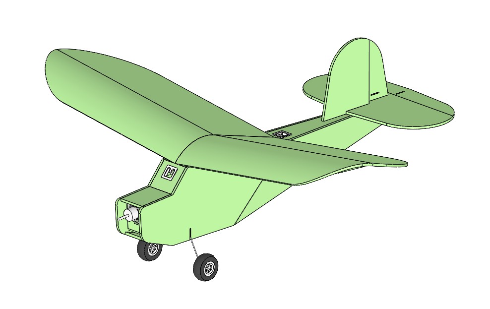

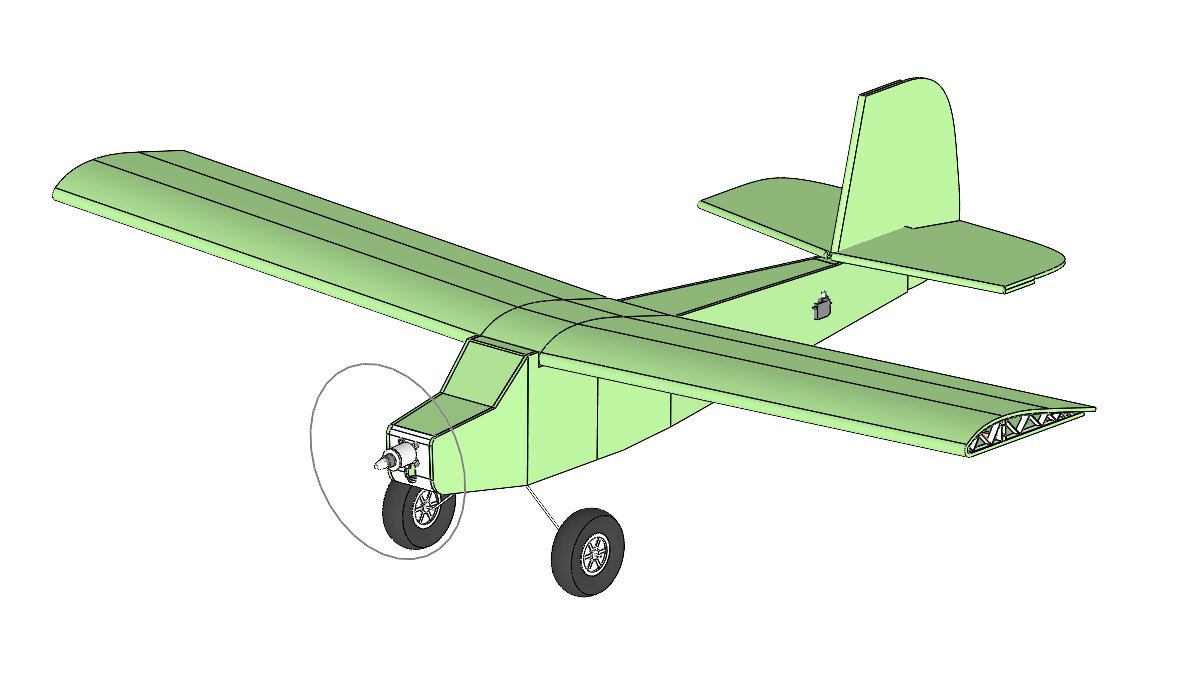

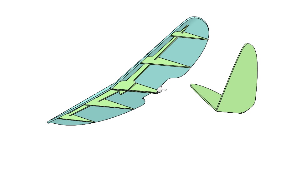

Here's a selection of what I've got going on. I apologize for the names, I usually call my planes whatever comes to mind first:

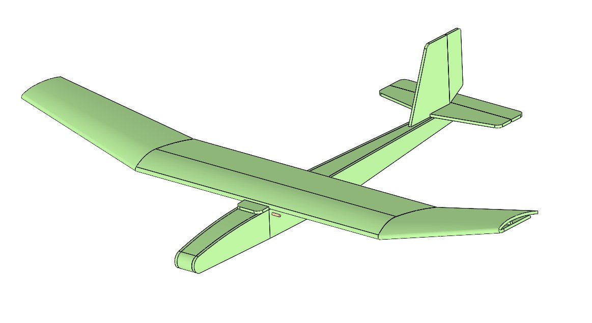

Carolina Queen ~1650mm span sailplane, 3DP with DTFB flying surfaces and carbon boom. I actually built this plane in its entirety but was so unpleased with how the wing came out that I scrapped it. The concept was something to fly in the seemingly always windy conditions around here and I'd like to revisit it again.

DumbleDee Plus. A 10% upscaled version of my highly successful DumbleDee park flyer. Design is done, haven't built it.

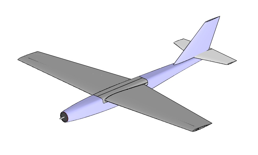

Mercury V2. 900mm span, design for 180-200mph flight, full 3DP and CF spars, etc. First time using AI for design help, mostly on the electronics side of things (I'm not impressed). Haven't finished the design, will be a bit pricey to build anyways.
Mercury V3. 1000mm span, designed for ~160mph, possibly more. This time no AI. I feel more confident about this one, ironically enough. Haven't finished the design, have studied some more aero stuff lately that's making me rethink some things anyways.

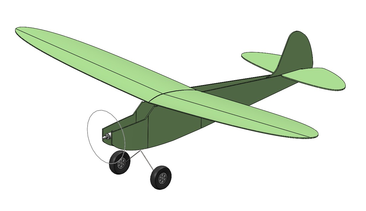

Rascal. 2000mm span DTFB version of the classic Sig Rascal. Design work unfinished.

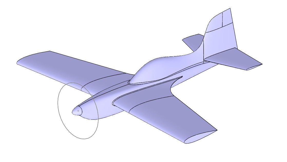

Sharp. 1050mm span 3DP and CF spar aerobatic plane with forward swept wings (cuz why not). Design unfinished.

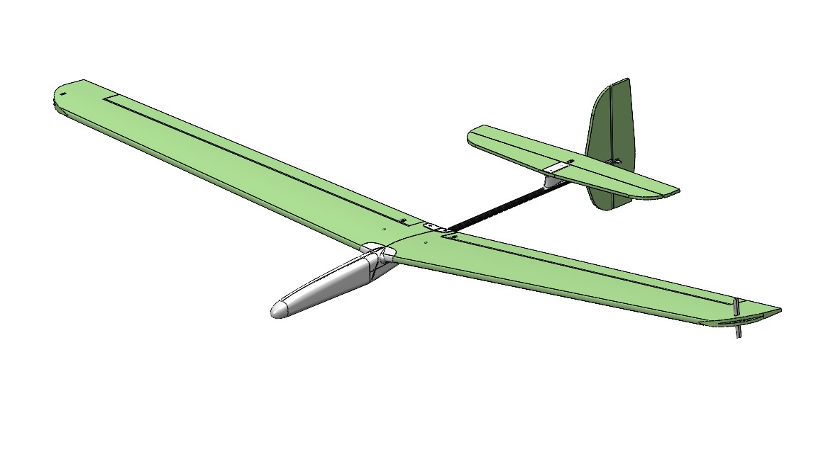

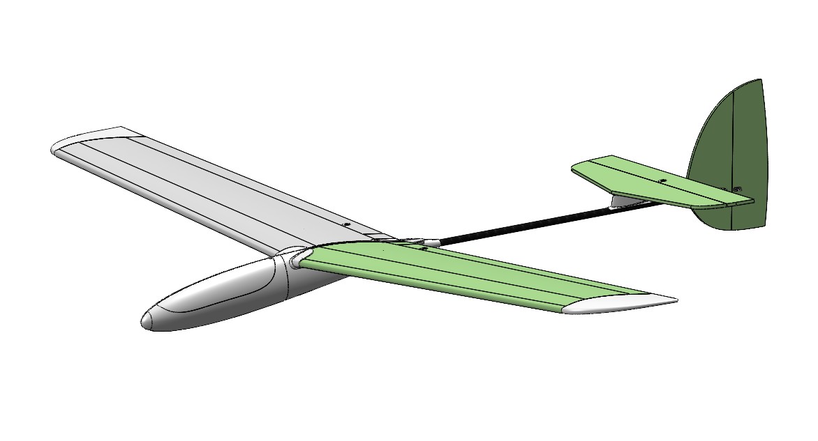

Vagrant DLG. 1500mm span DLG, DTFB flying surfaces, 3DP pod and stuff, CF boom. Also built in its entirety, built the wings twice and still wasn't happy, scrapped. Still want to successfully build something like this, have some new ideas.

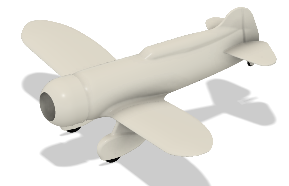

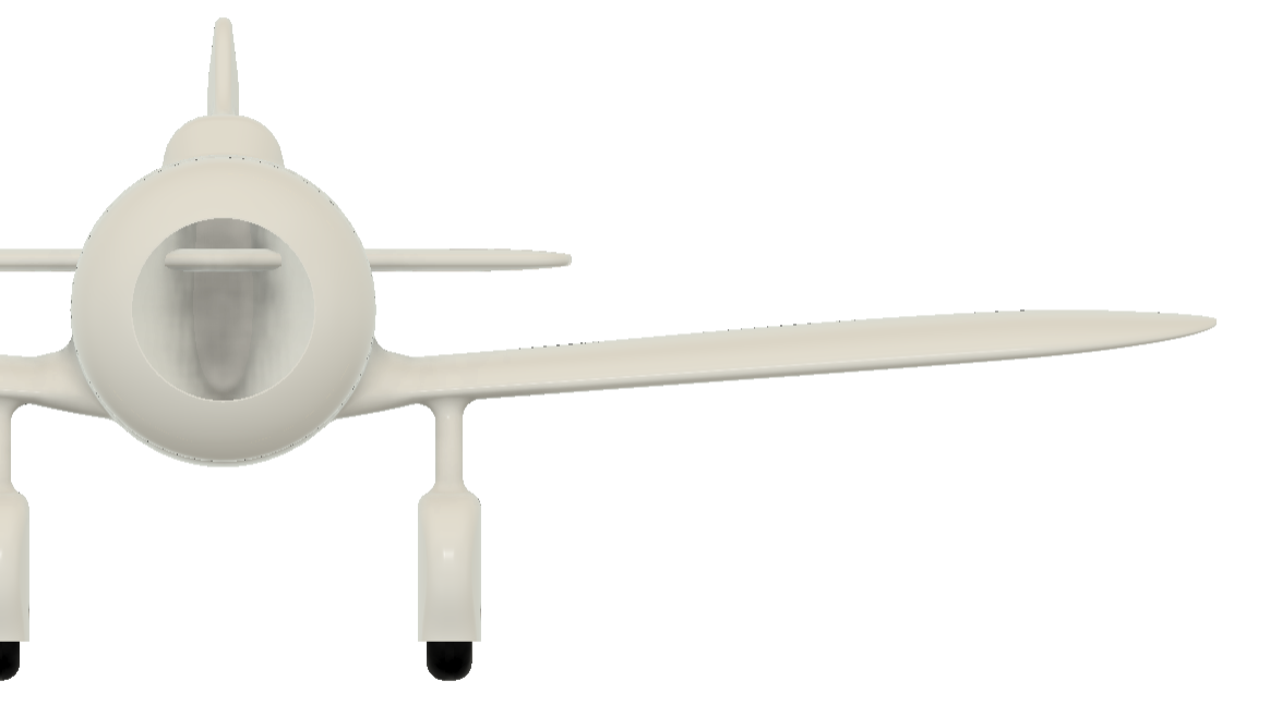

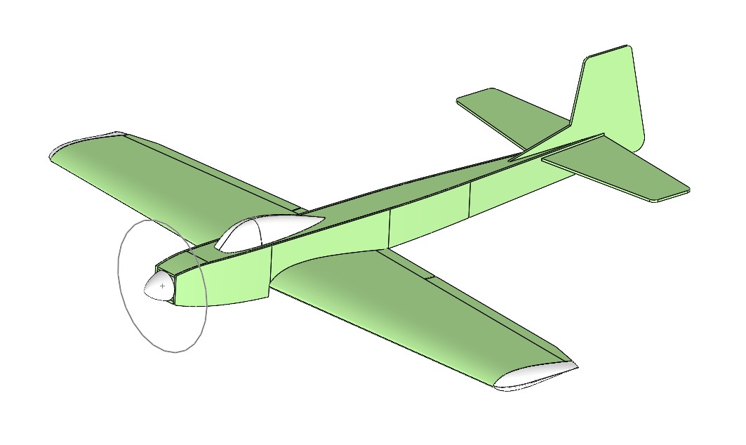

What kind of layout are you thinking? Add cowling around the motor and a spinner and those look pretty darn good to me
Well, the general layout would be approximately the same though I keep wondering if a high/shoulder wing really is the best or if I should investigate a low or mid wing. I also want to focus on the wing-to-fuselage interface a little more as well as possibly reducing the size of the vertical stabilizer. It's all obviously a balancing act between weight, stiffness, wetted area, etc.
Mid wing would be great so as to keep the thrust line in plane with the wing, but now my spar crosses through the battery compartment which doesn't really work too well.
Vertical stabilizer reduction could be accomplished by extending the tail, but now I take a hit to weight and stiffness. Alternatively could reduce the wingspan so as to reduce the required stabilizer area, but reducing the aspect ratio comes with its own set of conditions. I've kind of set the rough span based off of using a 1m length of CF tube, I want as much span as possible supported by it.
I dunno, it'll probably remain mostly the same. I tinkered with a new wing in CAD last night and got frustrated, I need to go back and re-do my airfoil sketch blocks, the way they are now cause some issues. Also, lofting wingtips is tricky.

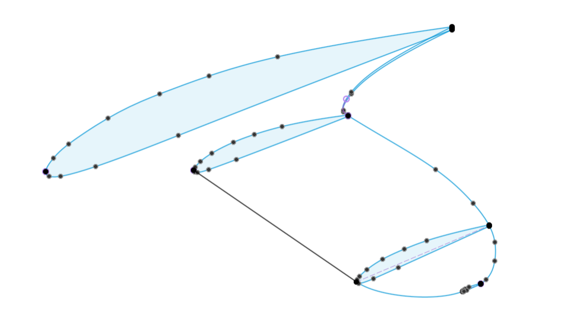

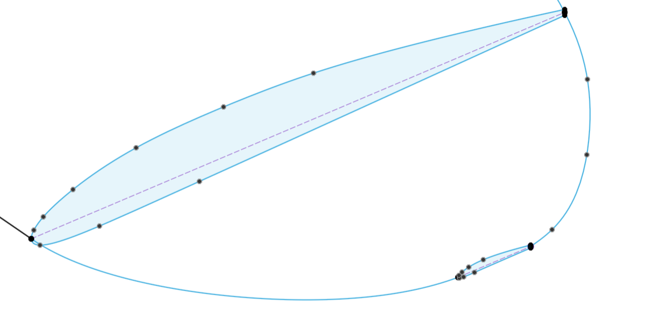

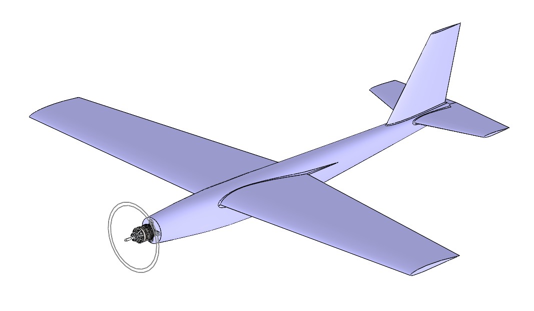

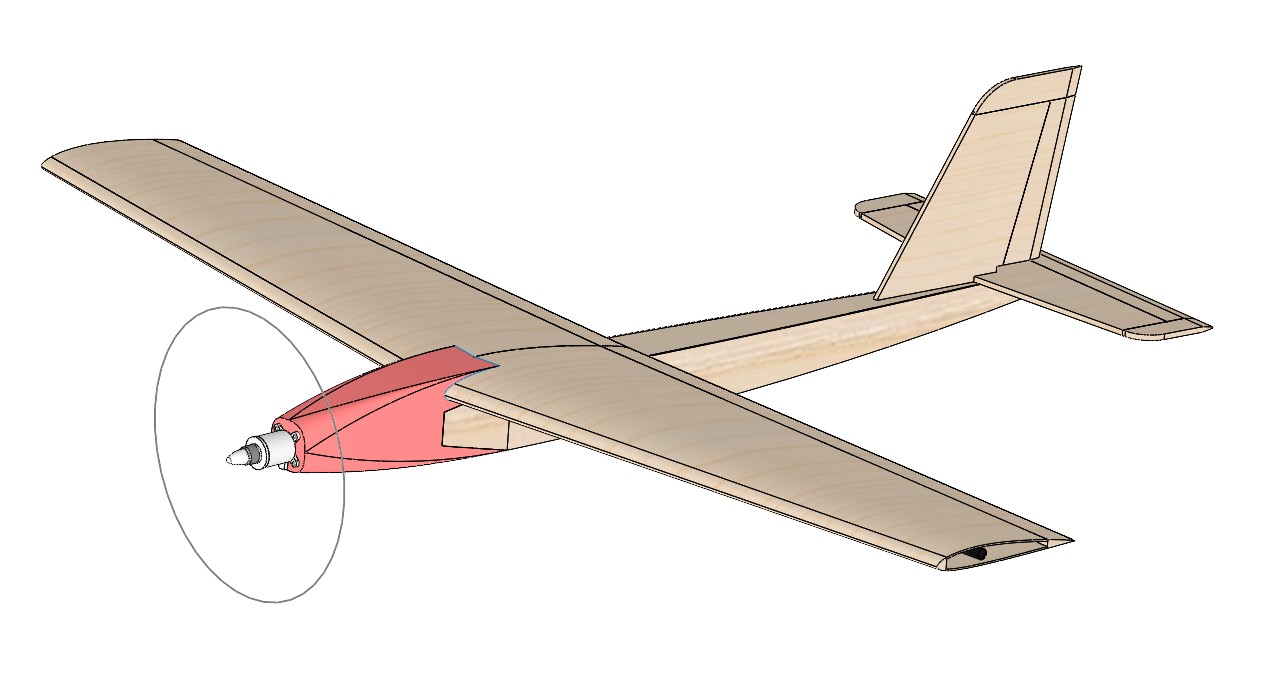

Makes sense. My understanding is that midwing is the lowest drag location since it reduces interference with the fuselage. My experience with 3D printed designs is that the battery basically always needs to go in front of the wing regardless to achieve CG so the spar probably won't be in the way - you might actually need to make the nose longer to get it to balance as is.
In general, for modeling wings, I just trace the airfoil out visually since it allows me to visually edit the trailing edge much more easily than if I imported a dat file. Tapered wingtips are definitely annoying to do - my approach is to have a very small airfoil all the way at the tip and then loft to that without having the rails quite parallel to it - once it's printed you can't tell the difference and it keeps a good airfoil shape all the way to the tip.
These sketches give me this wing with the help of a couple fillets after the loft.
View attachment 259484 View attachment 259485
