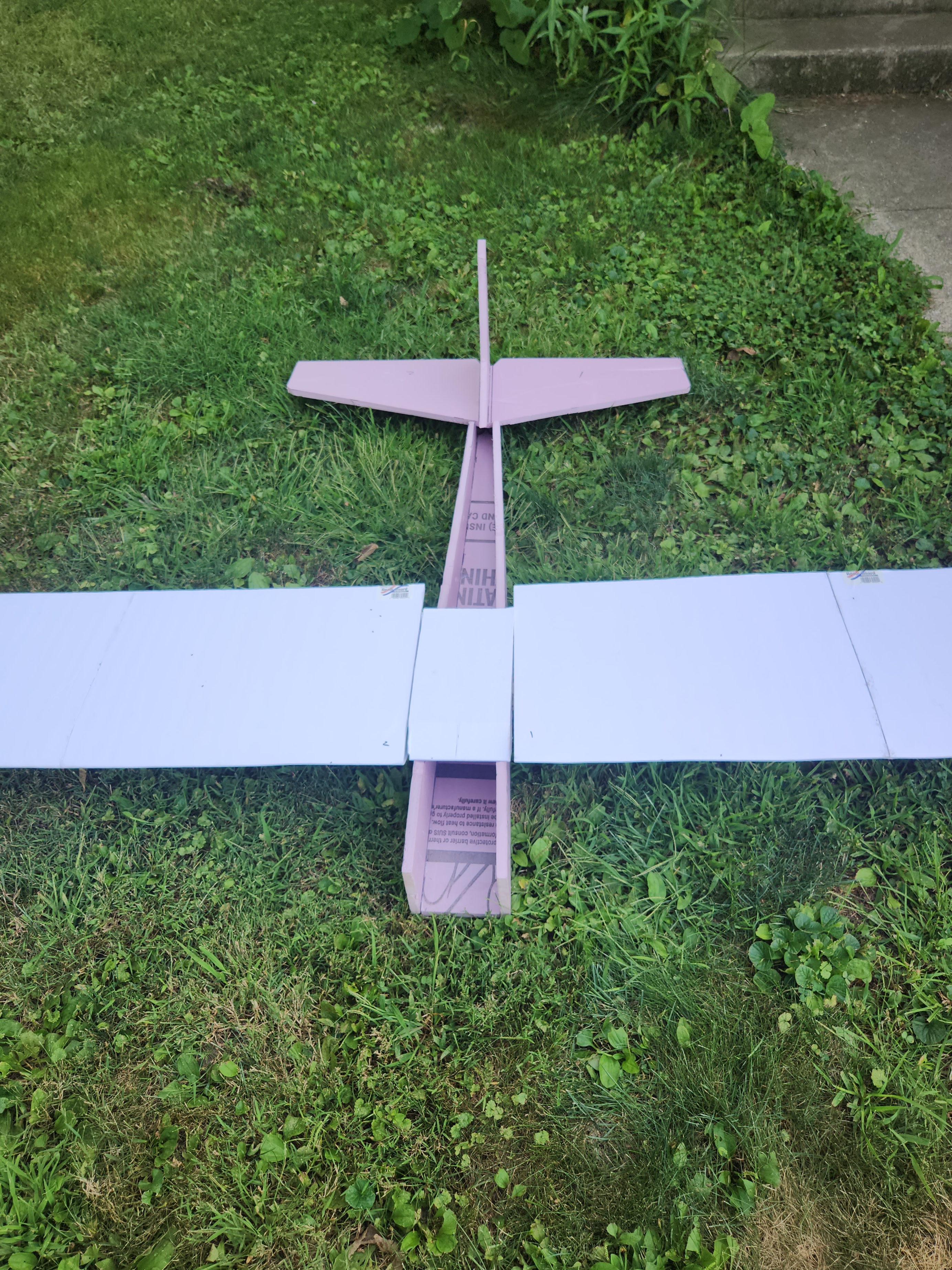

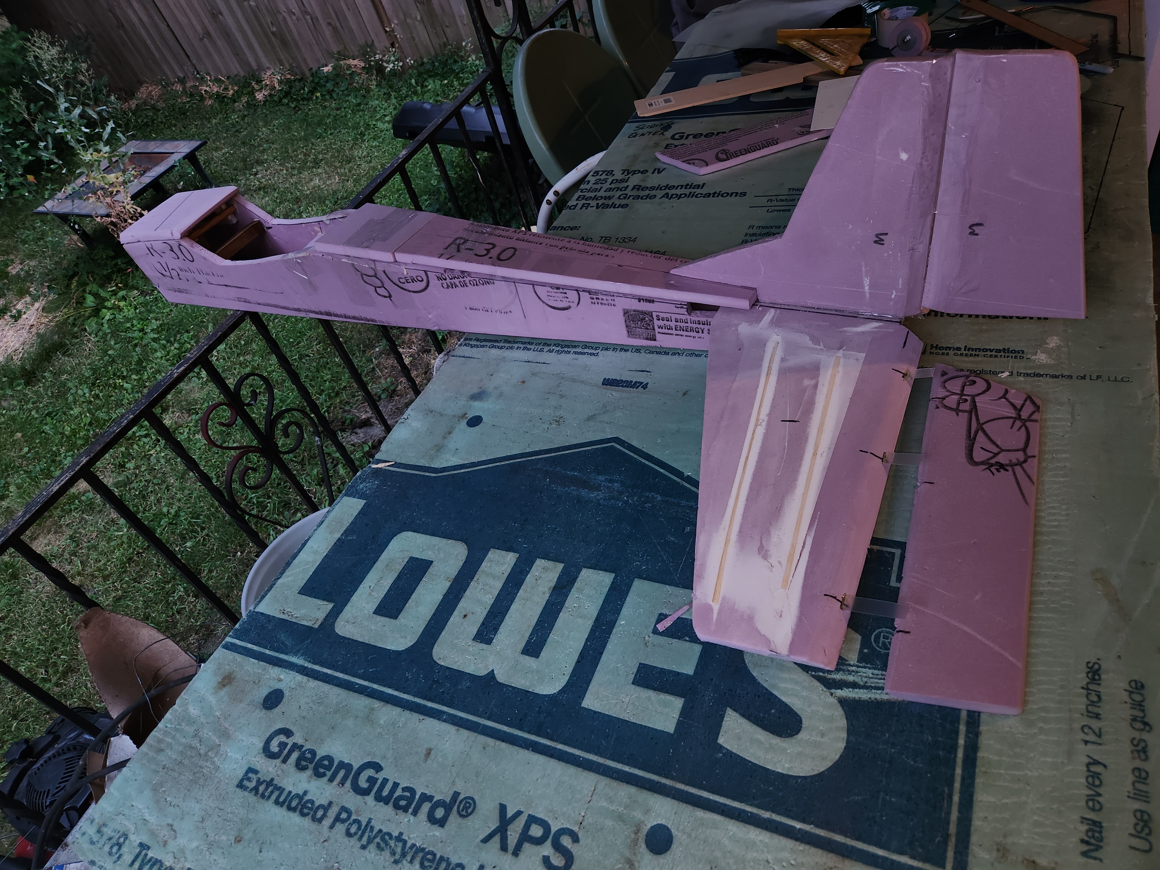

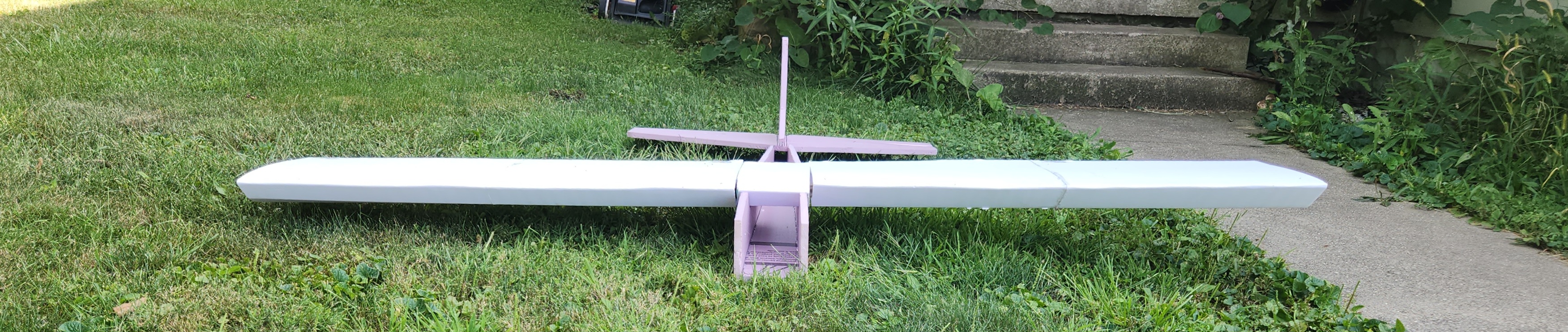

The fuse is 67 inch long by 6.5 tall 5 5 wide . The wings was build three sections and put together out of dtf 1x2 poplar spar through wing less one inch on each side . The foam former is 2 in from leading edge and is 2x2 green foam block . Wing weight is 2lbs the fuse with foam and 3/8 dowl rods with the rudder and elevators it's about 1.5lbs . All up maybe 6lbs . Will post pictures soon

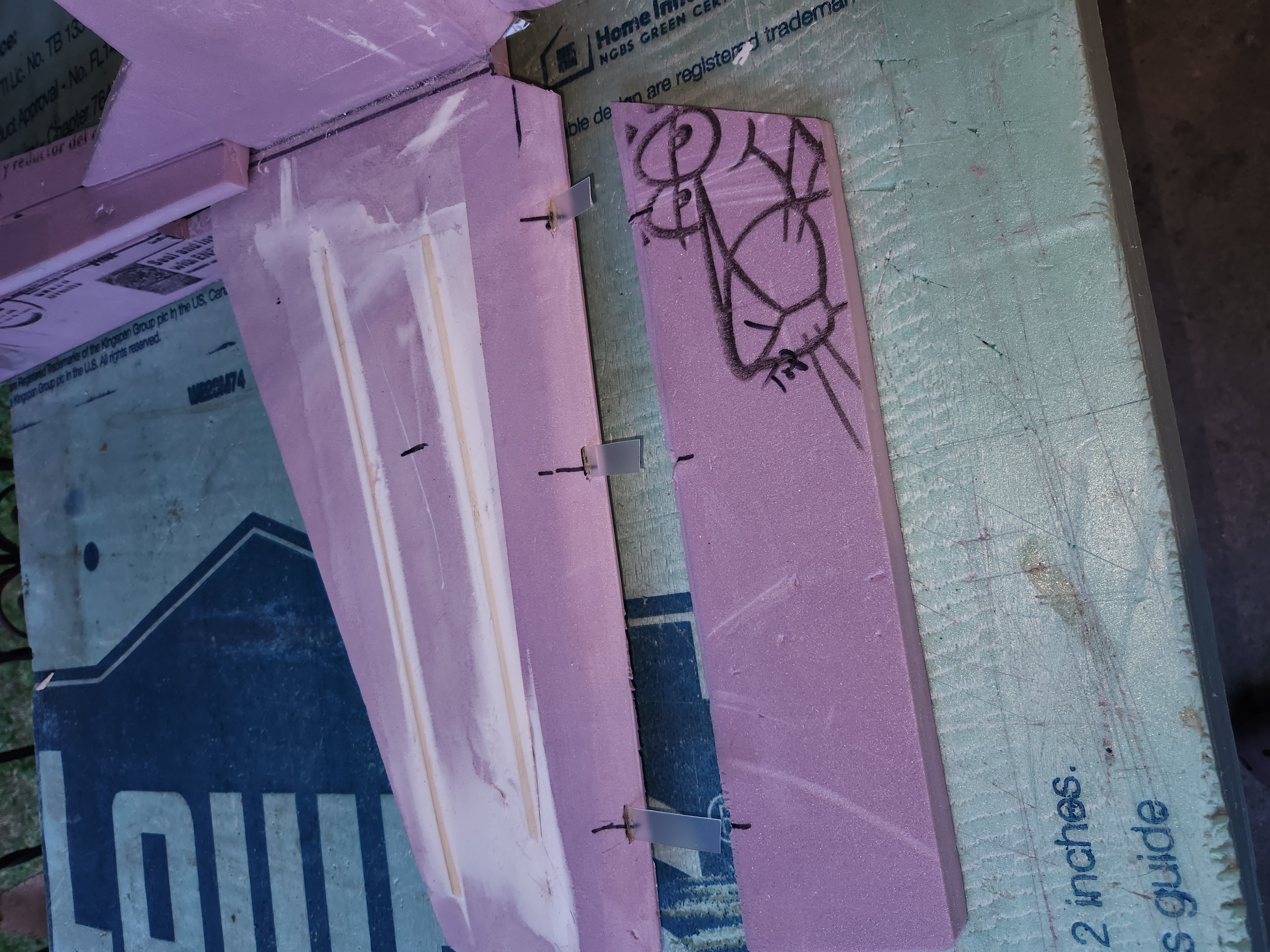

And tape hinges dont work with 1inch foam . The thin plastic cutting board from the dollar tree cut into 1x2 strips as the hinge looks to work

Foam Ryan's revenge
