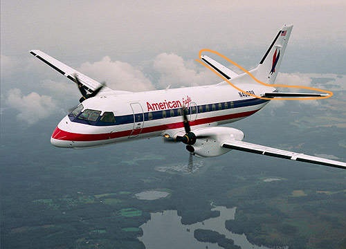

I'm working on the saab 340 rn and the only thing im having trouble with is the vertical stabilizer.
I wanna keep the deihedral but I'm kinda confused on how to make the elevators move together. I wanna try something with wire but I think it might mess things up. Of anybody has an idea im all ears!

I would do dual push rods like @nerdnic did with some of his planes.

depending on the over all size of the model you might want to just use two servos.
