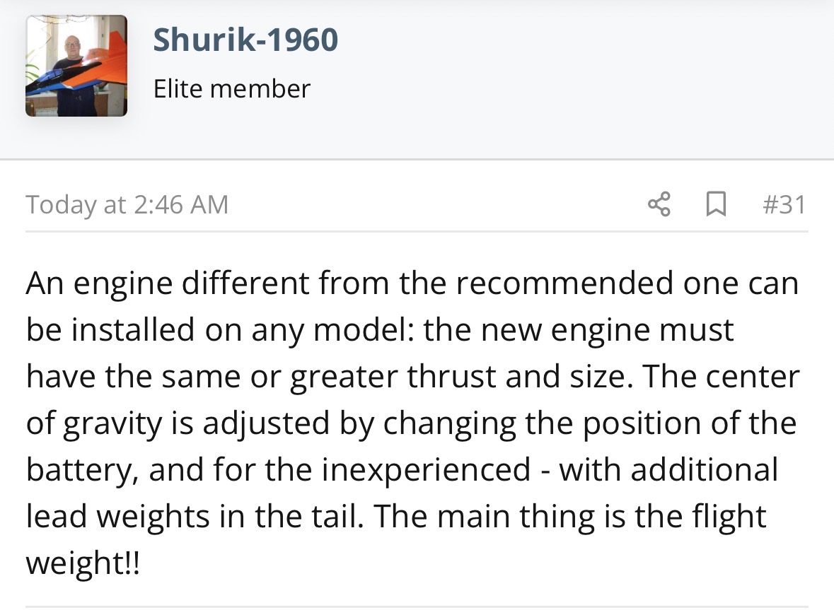

An engine different from the recommended one can be installed on any model: the new engine must have the same or greater thrust and size. The center of gravity is adjusted by changing the position of the battery, and for the inexperienced - with additional lead weights in the tail. The main thing is the flight weight!!
