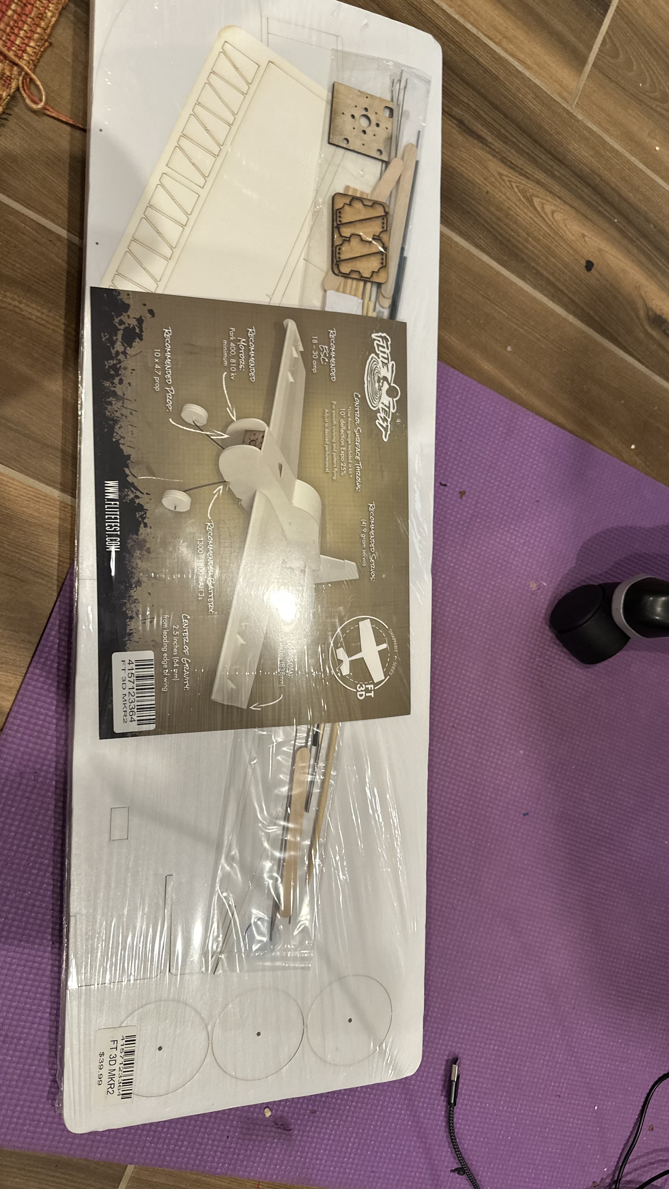

Foamforce
And does the esc go in the power pod or on the underside?
On mine, the battery (1300mah 3s) was strapped right behind the motor on the bottom of the power pod and the ESC was inside the power pod, also toward the front. That matched the marked COG. From what I know now about 3d, those should both be pushed way back to make it more tail heavy.
Be careful moving cg aft. A wee bit might work, a bit more than that makes it un-flyable really quick. Stay inside the range if they give one. They don't tell you in the instructions where stuff goes bad. 3D generally has much more authority in the response to inputs so sometimes you can get away with cg changes, not always.
