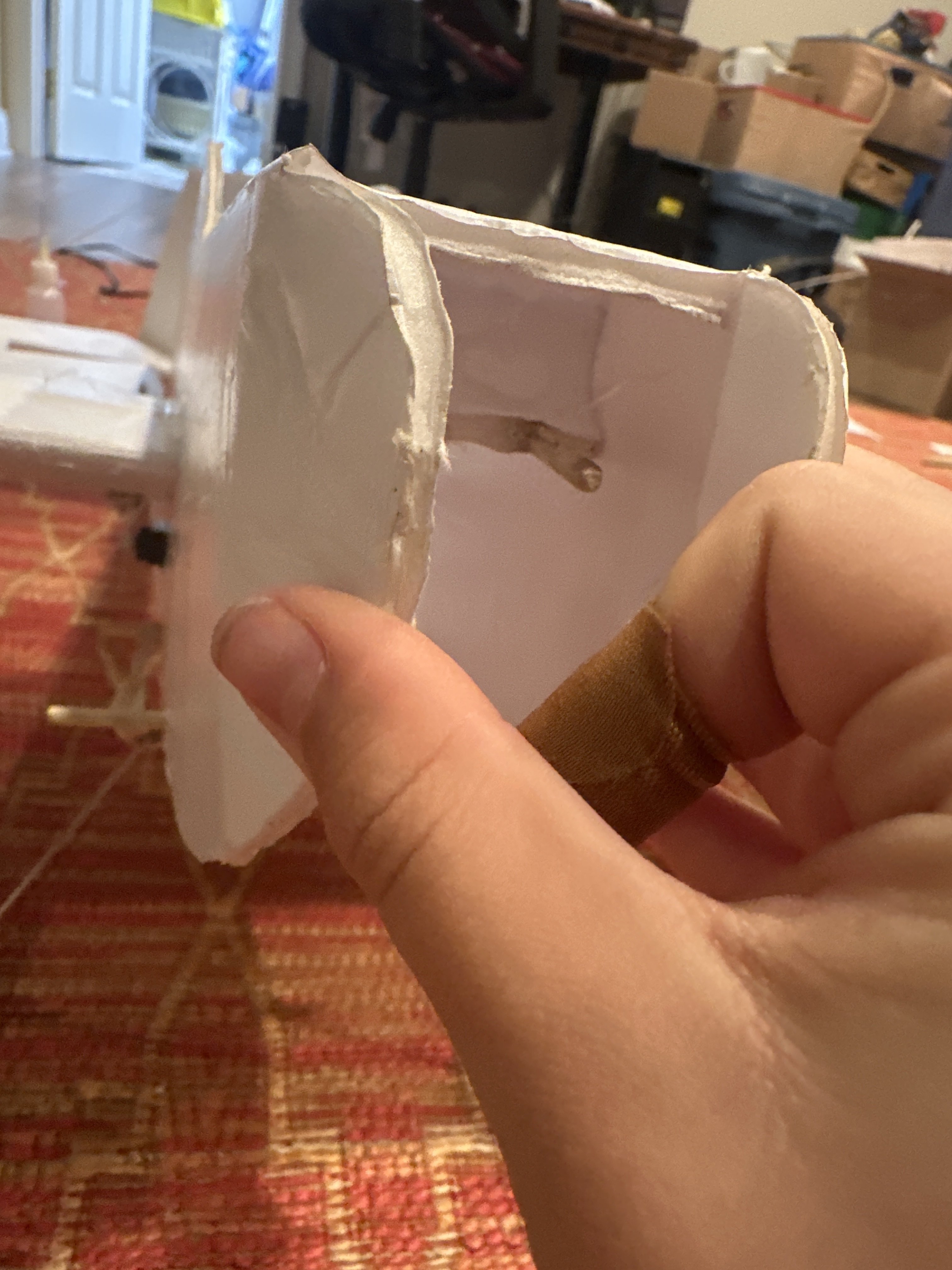

Just maidened the 3d, it flew great. I did my first hover (even though it wasnt that good prolly because it was set to be nose heavy). Unfortunately I was hovering it, winged it over with the rudder, and rolled it on the way down. I tried to recover but i think i was too low. It smacked the ground on the front end. The wing was a little peeled off, the front was a teeny bit dented, and the thing with the skewers that holds in the power pod came off. Something very unexpected was the rudder started fluttering when i did a control check post-crash! I dont know how the servo got stripped or whatever, but i am not impressed with ft’s servos. Either way just got home and will hot glue the slightly damaged parts and replace the servo.
These pics are of the damage (i dont have a crash vid)

When you upgrade your servos, get the cheap metal gear ones off Amazon...They will last forever and what ever you put them thru! 😂
Bricks
If you can do your repairs with out hot glue you can save adding extra weight, lighter flies much better. What Houndpup said for replacement servos even thou they are not true metal gears the ones taking the most torque are metal.
