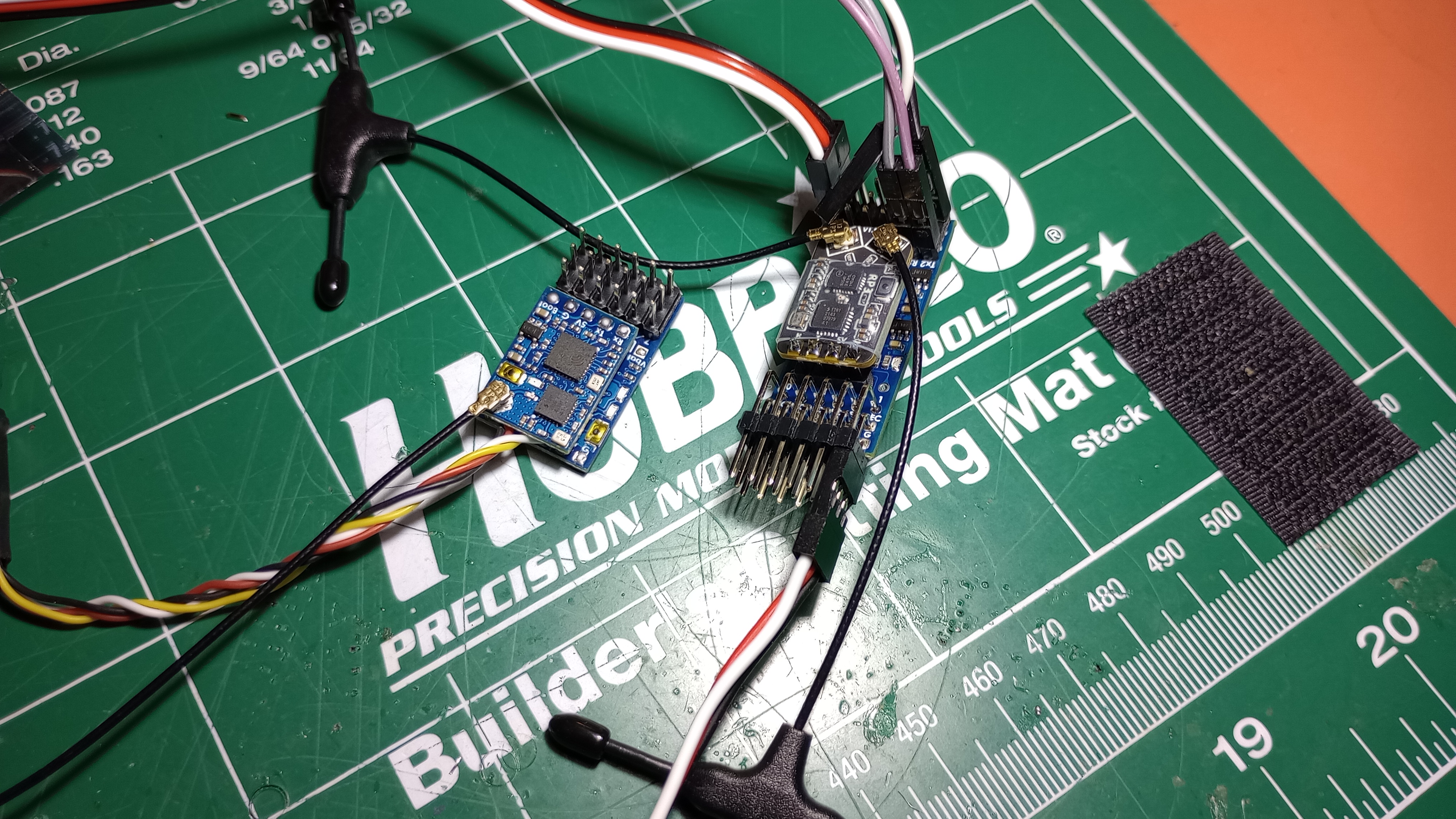

I have a few varieties of the Matek CRSF-PWM boards that I tested over a year ago. I'm sure by now, there are other variants out now tool. The Matek boards used a funky firmware update for the PWM part of the board, and we spent four months getting them to fix a critical flaw causing flyaways before I ever put one in the air. I need to look to see what other options are out there now.
Hmmm. Looks like Matek still is the only company with such an option.
Others have Vario and other telemetry, but Matek is still the only with GPS support.
The boards are 6-15 bucks, and then you need a CRSF/ELRS receiver to connect to it. They also have an integrated one for $25 that has both the RX and PWM board.
You have to provide the GPS module too.
