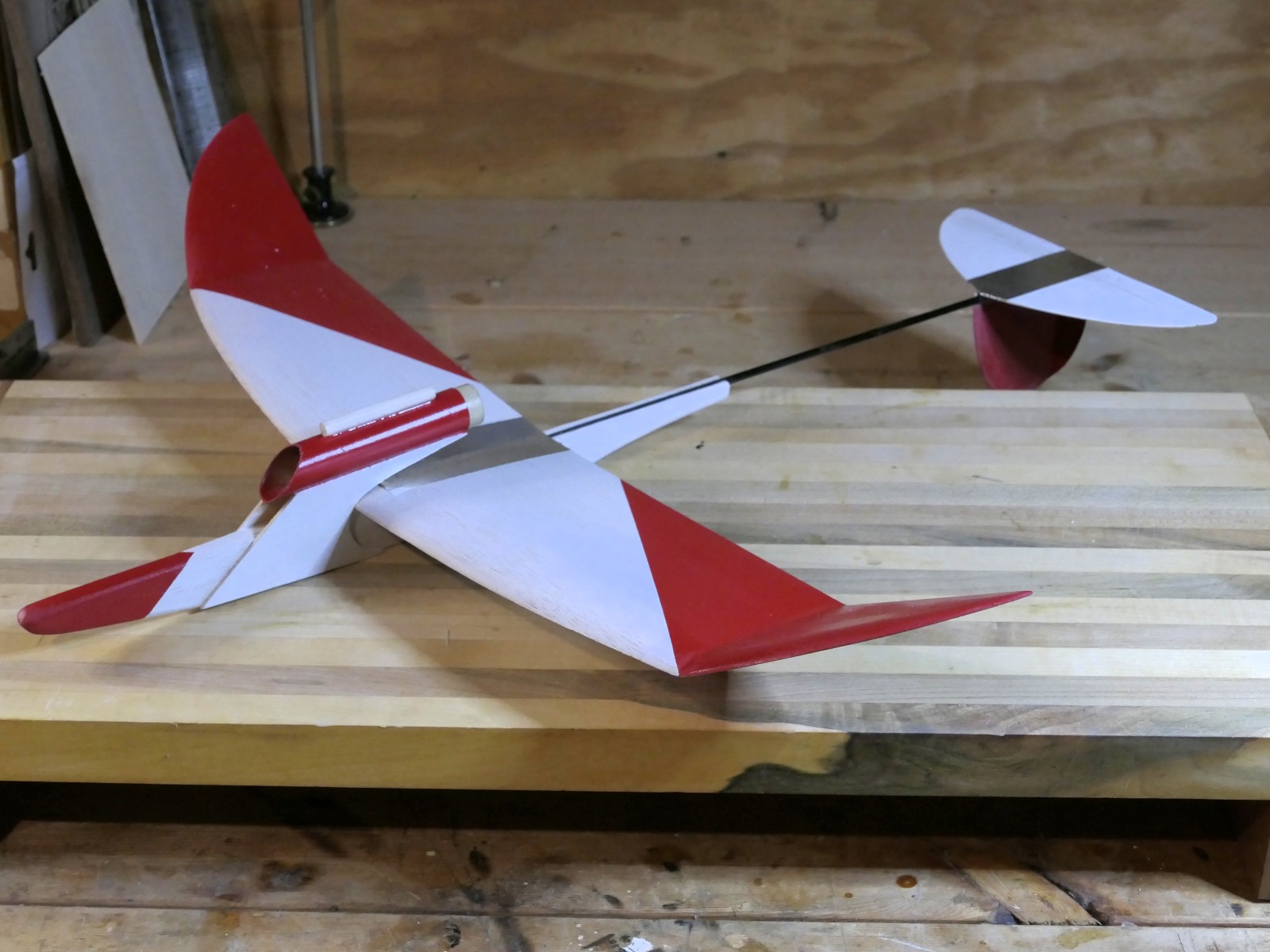

I have on its way to me a NOS Graupner Slipper, a 21" balsa HLG. I will be converting it to 2ch RC with a UMX brick, and adding a motor pod so it can be launched using 18mm A & B Estes engines. I think C engines would push it beyond 400', as well as make it harder for my aging eyes to keep track of it. I've not done any rocketry in around 20 years, but I still have all of my equipment and a large plastic container full of motors and launch supplies. The rocket club that used to meet at the LHS moved to a town across the state line about 2 hours away, so my re-entry into rocketry is going to be solo. Stay tuned for updates.

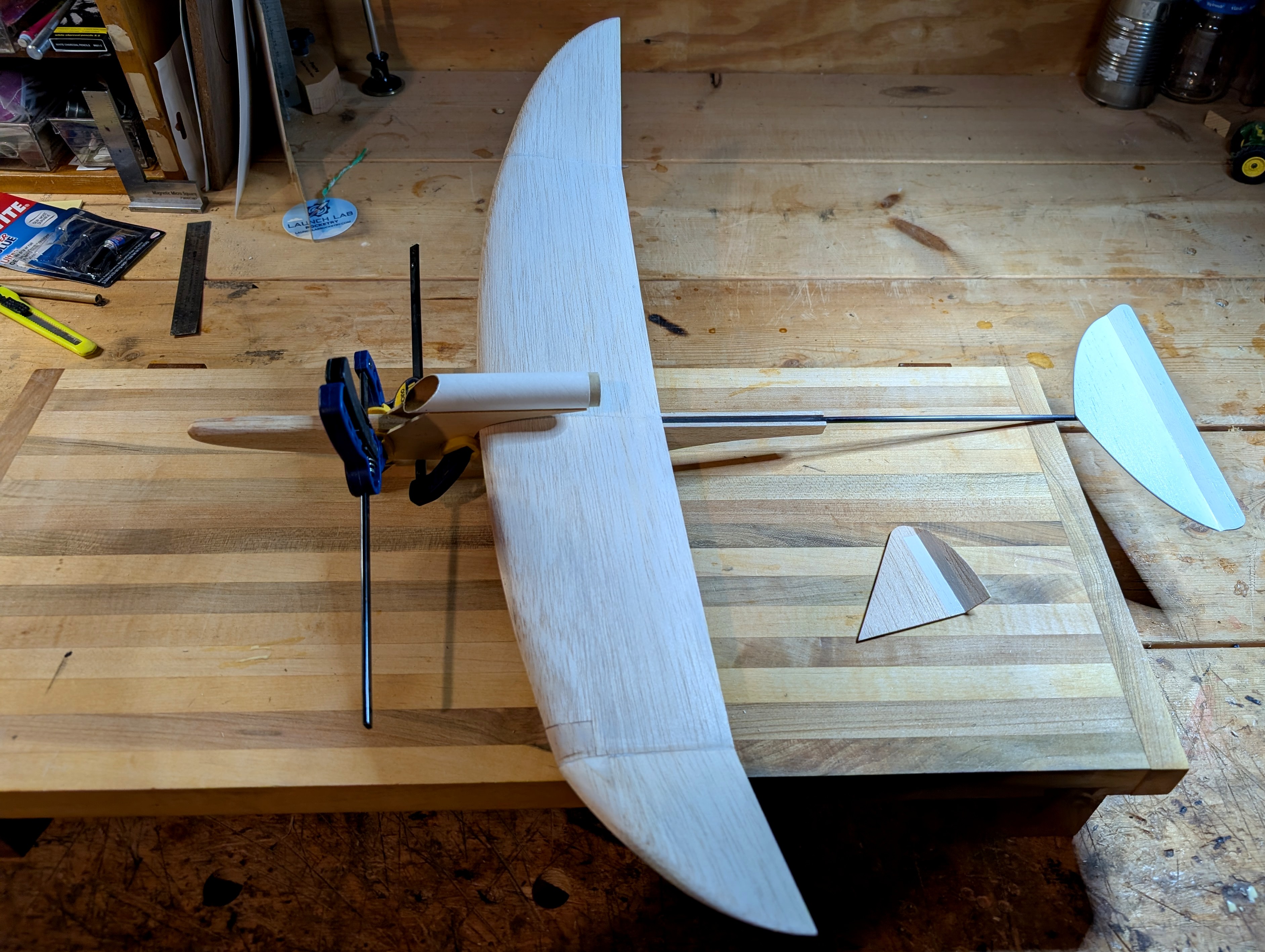

Looks like it is going to be 80-90g. It is mostly built now, and the wings are a pretty dense balsa. The kit was old and had been banged around some through the years, so I had to cut out and replace some chewed up edges in the wing.

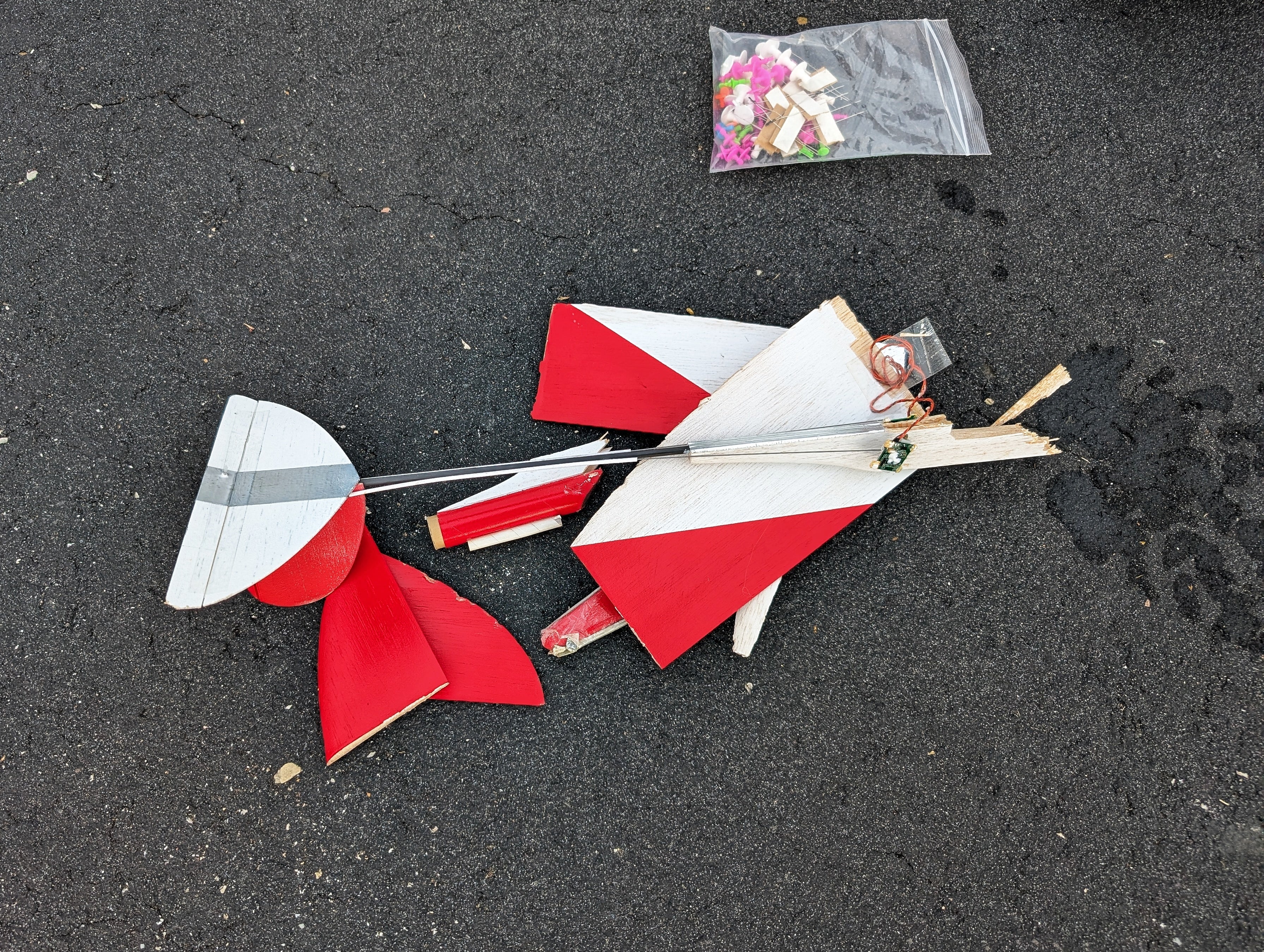

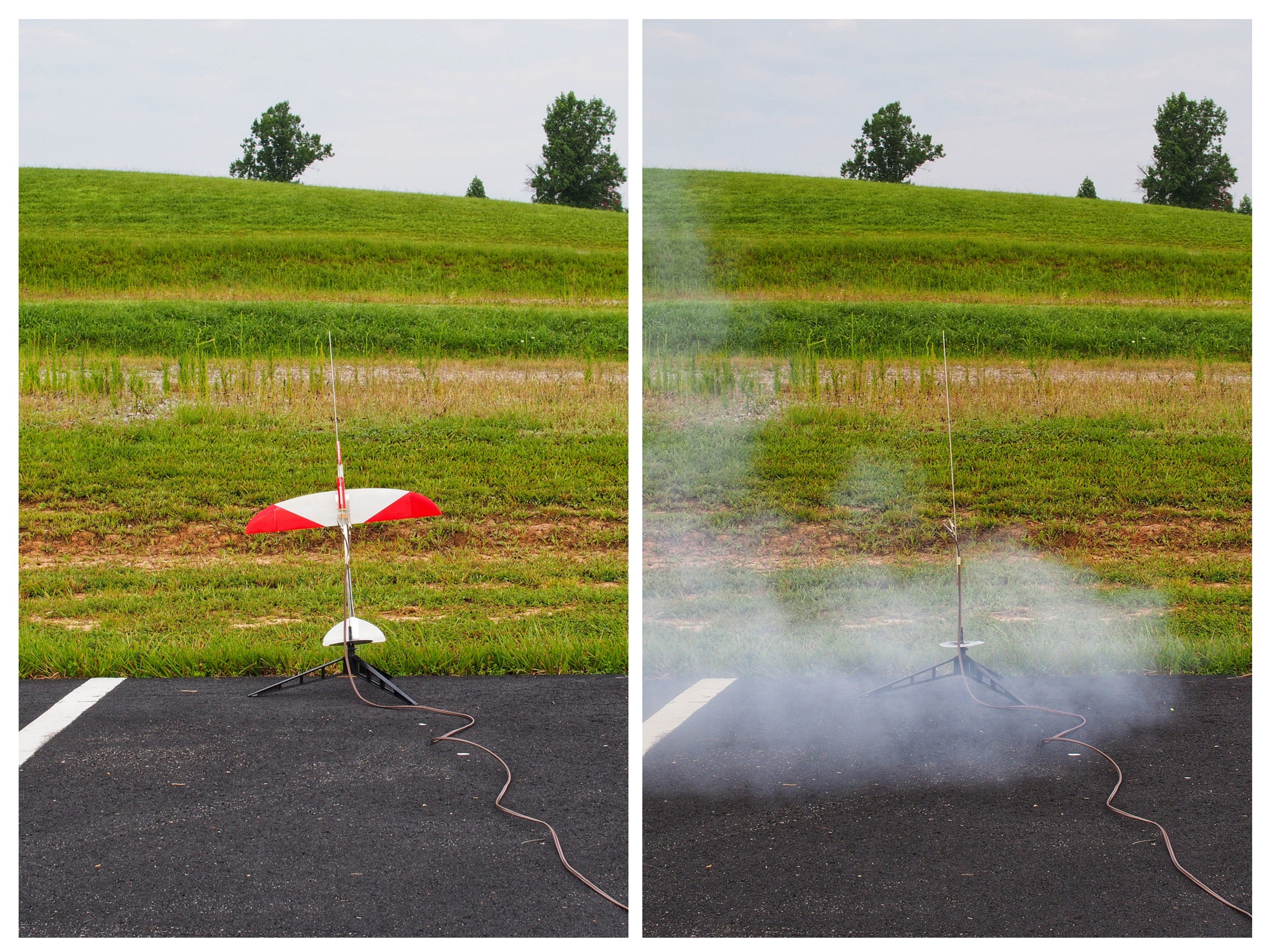

Sadly, I had a crash worthy of the FT guys this morning. It was the first and only launch of my rocket glider. I set the camera to take a set of images 1 second apart with a delay of 5 seconds to give me time to get ready. Sadly, the rocket came off the launch pad at about 150mph in a severe arc that went about 15 feet high and impacted about 60 feet away and to the right less than 3 seconds after ignition. My reflexes were just not quick enough to make course corrections. Still trying to digest what went wrong. I was trying to get an image of the exhaust flame, but it came off the pad very, very fast. Crashes happen, but it's still pretty disappointing.
Ouch, that hurt.

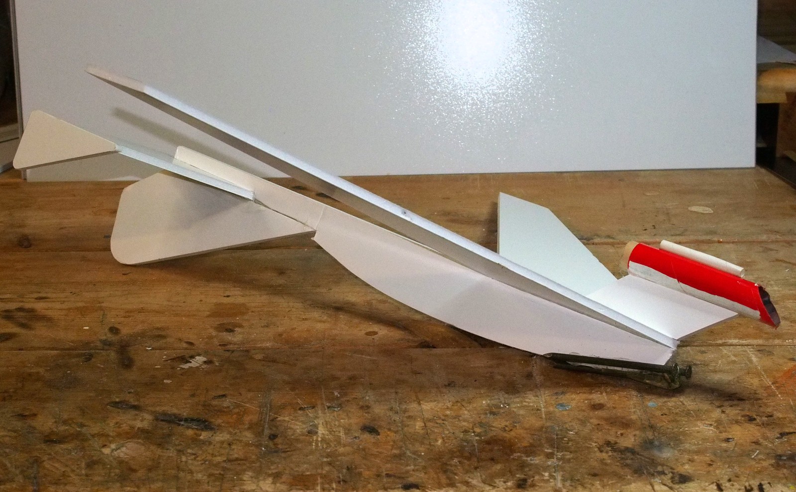

While the Slipper is no more, I've started on a 175% scale version of a 1960s boost glider, the Astron Falcon. Instead of ejecting the engine and gliding back on its own, it will be controlled by an AR6400 brick and rudder/elevator. I started the project by making a foamboard mockup, and hot gluing a couple of large nails to the front to get the proper balance. Glide tests went well, so I removed the nails, pulled off the pylon, extended the nose by a couple of inches, and glued the pylon back on. More glide tests on the new configuration this morning. The area in front of the tail was rather flimsy, so I used finishing resin to laminate CF tow on both side of the fuselage in front of the tail, and clamped it straight and left the epoxy to set overnight. Here it is before the modification:
