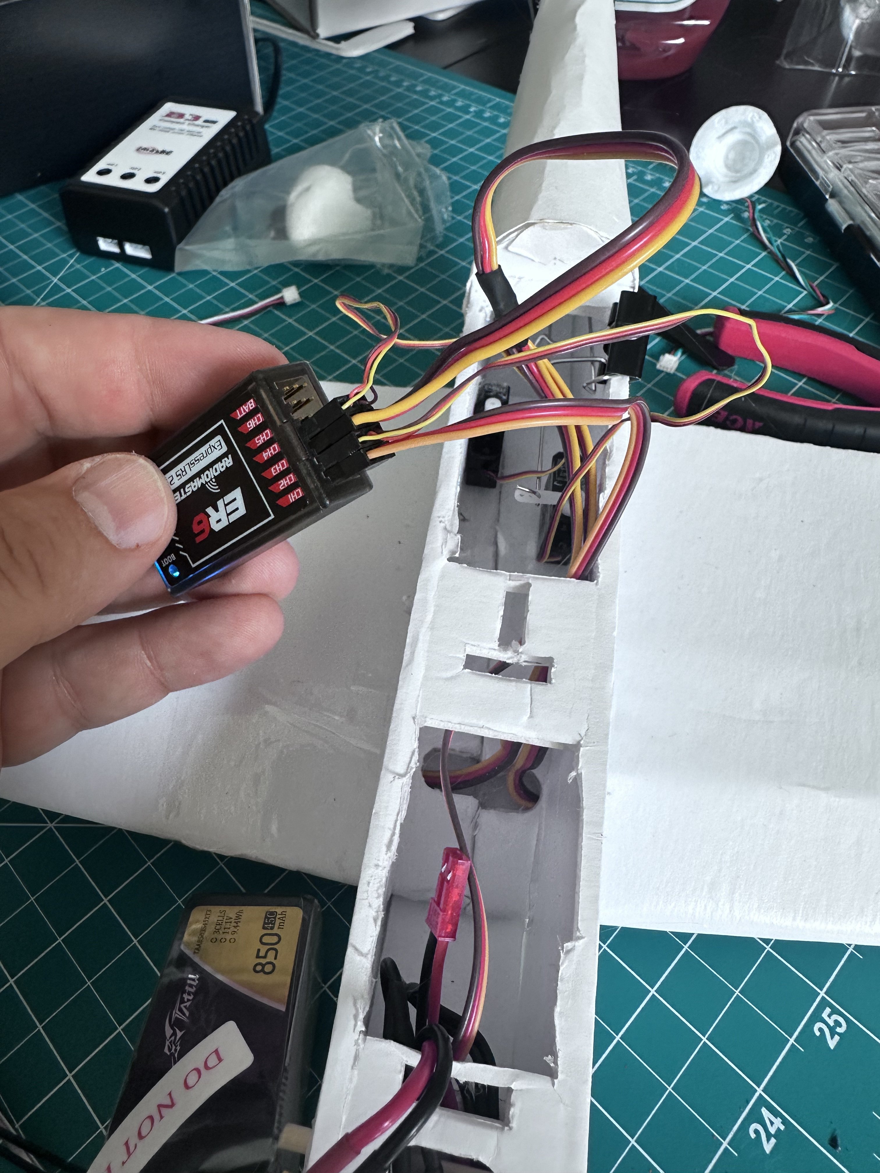

Ok, had a moment to look into this. The current issue I'm struggling with is the aileron channel doesn't seem to be setup correctly and the throttle doesn't work at all.
When I move the right gimbal left/right the receiver makes a beeping noise and nothing happens, and when i push the throttle control up there is no beeping and nothing happens.
I can successfully move the rudder (ch 4) and elevator (ch2).
I used the preset called FT Plane on the pocket 2250.

A bit late to this, but I have looked at the above picture the best I can tell is you had the Y harness for the ailerons plugged in channel 3 and the motor plugged in to channel 1. Not sure if you changed that or not, but that is probably backwards if it is set up for AETR mapping.
1. A aileron
2. E elevator
3. T throttle
4. R Rudder
We need a couple of screenshots from your radio to verify how the channel order is configured. I have a Pocket, but not the FT profiles. In the Model configuration, page 5 is inputs, and page 6 is mixes. Take pictures of those two pages and post them up. That will clear up what channel order is set up for your model. After that is cleared up, we can look at the channels monitor to see if your throttle channel is being passed to the RX or has a cut.

One other thing I am confused about by the picture is you repeatedly say your TX is a CC2250, but unless you have an external TX module, the ER6 ELRS RX pictured above would not bind to a CC2500. Are you sure it isn't an ELRS Pocket TX?
