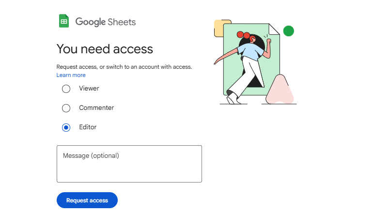

Looks like the spreadsheets are locked

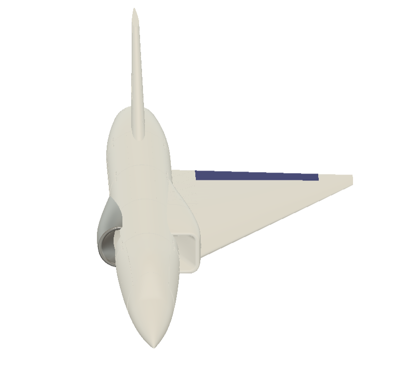

Going back to page 1, your asked for giving requirements of what you want:
1) Rectangular wing about 34" wide and 22"wide. (Foam)
2) Wing is in the back were end of fuse(a piece of 1/8 balsa 3" wide) and wing meet the moving elevons.
3) A rudder about 12 high and max 9" width.
4) On fuse, 20 " ahead of the wing's leading edge, I want a motor/prop and wires only so it will slow and good control.
5) Using a 3s 1300 lipo.
Is it possible to do this design and make it fly or is it impossible to get the CG right? Think of all the areas you need to cover. Interesting what others think it will do.
@Realmdyz
@Realmdyz
That would be one interesting plane to try and balance
Almost every one would agree it isn't going to fly. But, if you add some gizmo's on it, it will fly. And I'm not talking weight.
