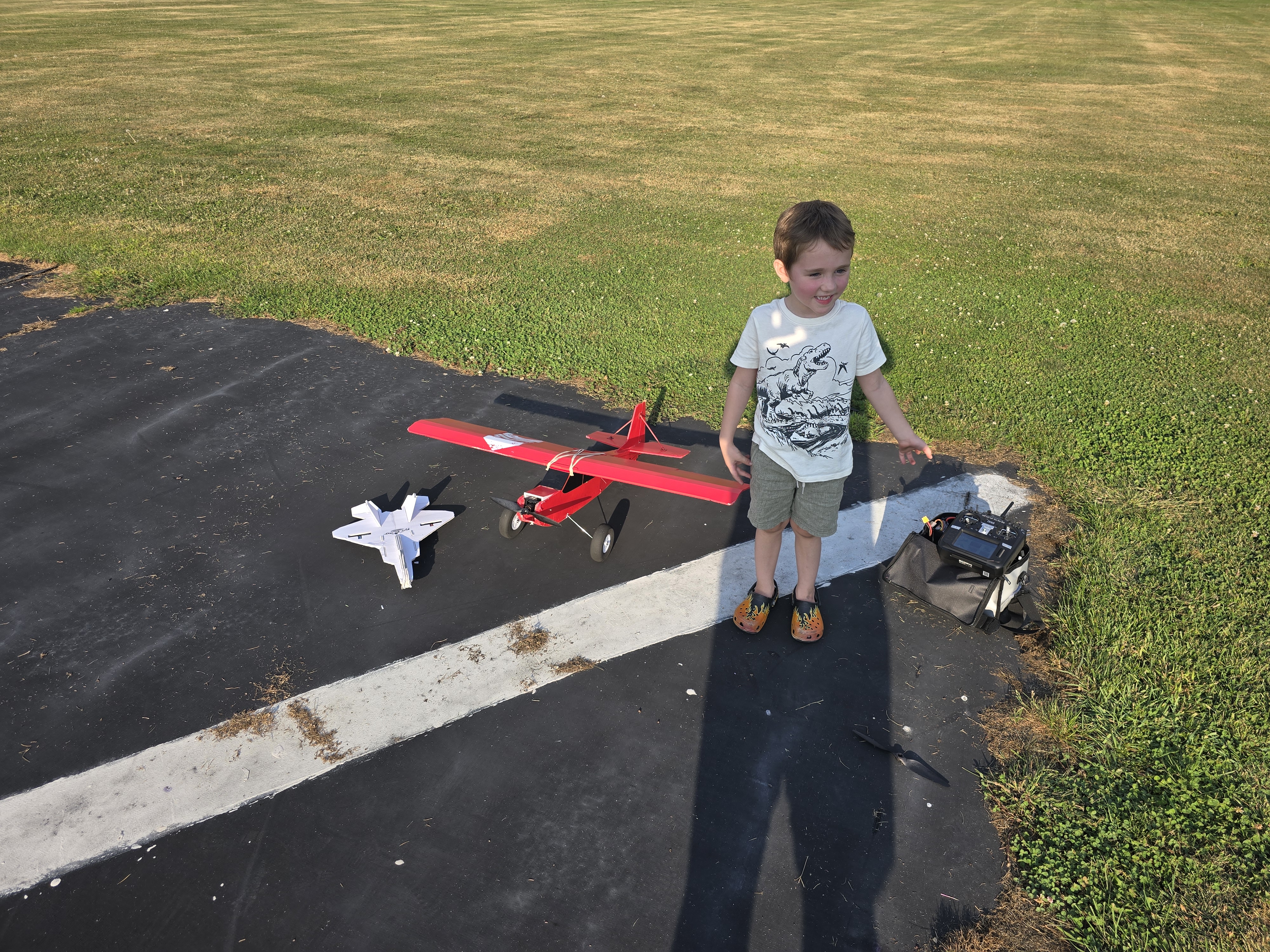

To be honest, as an advancing novice myself, I'm smitten by the Tutor. Takes a beating and shrugs off even the sloppiest landings. I've since built a twin engine Legacy and a Twin Otter but when I have an hour to kill I always grab the Tutor. When I've finally beat the standard Tutor wings to death I have Turbo Tutor wings ready to be assembled and keep it flying. Just such an incredible plane. My son and I just got home from the airfield 10 minutes ago. He flew his EZ F22 and I brought the Tutor.
