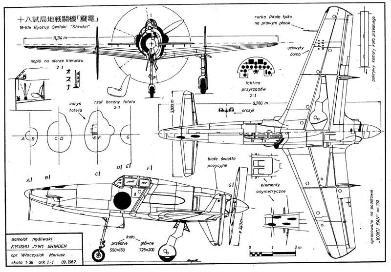

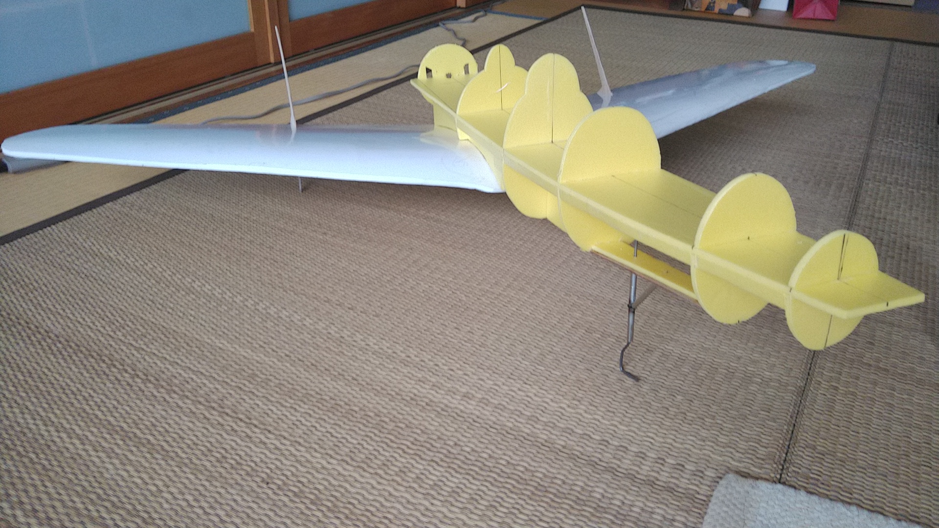

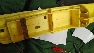

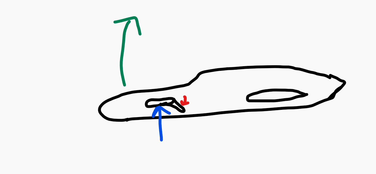

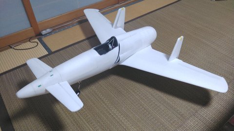

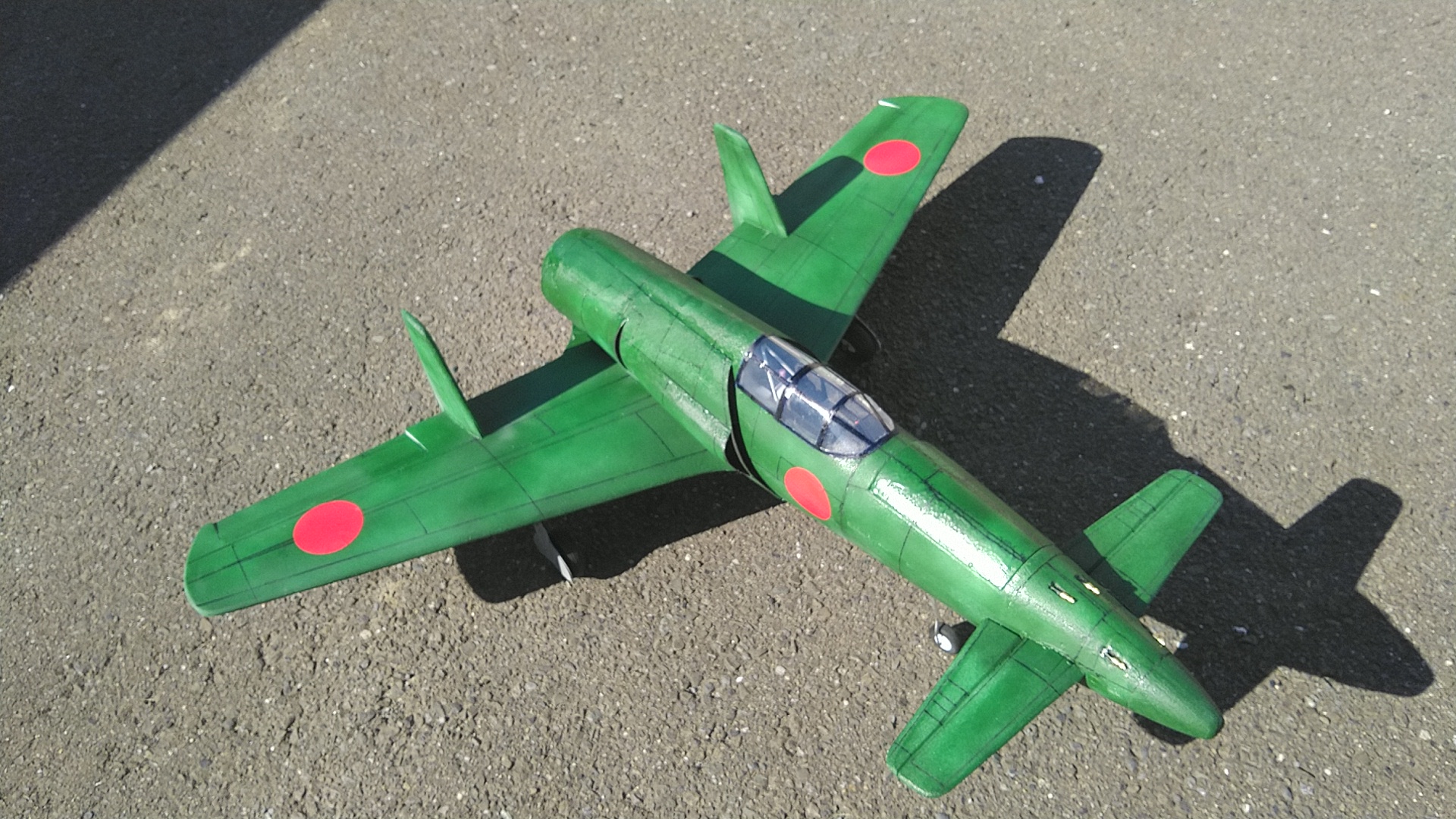

Hello everyone! I'm a Japanese architect (registered first-class architect). I built this RC J7W1 Shinden using 5mm thick polystyrene foam sheets from Daiso.
However, I'm having trouble getting it to take off. On its maiden flight, it didn't even take off; it just rolled over on the runway! 😭
As you know, the design of the canard wings and the placement of the rear propeller are extremely complex due to the relationship between the center of gravity (CG) and the thrust angle. I tried to utilize my architectural knowledge, but it seems I overlooked a crucial point!
I've uploaded photos of the construction process below. You can also watch videos of the crash/tipping tests on my YouTube channel.
Is the center of gravity too far back? Is the thrust angle wrong? Is the canard reflex insufficient?
Please watch the video and give me your opinions and advice. I would love to see this Shinden fly beautifully! Thank you! 🙏✨

That's a beautiful plane. I might have missed it, but where is the CG currently?
Looking at the takeoff runs, it looks like the surface you're trying to take off from might be a bit rough for the landing gear on the Shinden. You might also need more power. It doesn't look like it's getting up to speed and so it's unable to rotate. You might also check you control surface deflections to make sure they all make sense and are large enough. If it is a CG issue, I'd say it's somewhat nose heavy, but it's a bit hard to tell since the plane never gets off the ground so the CG could be spot on or be off in either direction. You can always build a small profile chuck glider to test.
telnar1236
You also mention reflex on the canard - this might just be a translation error but you generally don't want that.
To pitch up, the control surface on the canard should deflect downwards which increases lift and raises the nose

離陸で転げた際にモーターマウントが壊れて、修理してました。ついでにカナードを大きくしました。確かに重心位置がシビアなようです 現在の重心位置は主翼より1センチくらい前です。少しずつ後ろに移動させて、試してみますね。アドバイス有難うございます。モーターも強くしてみますね。
