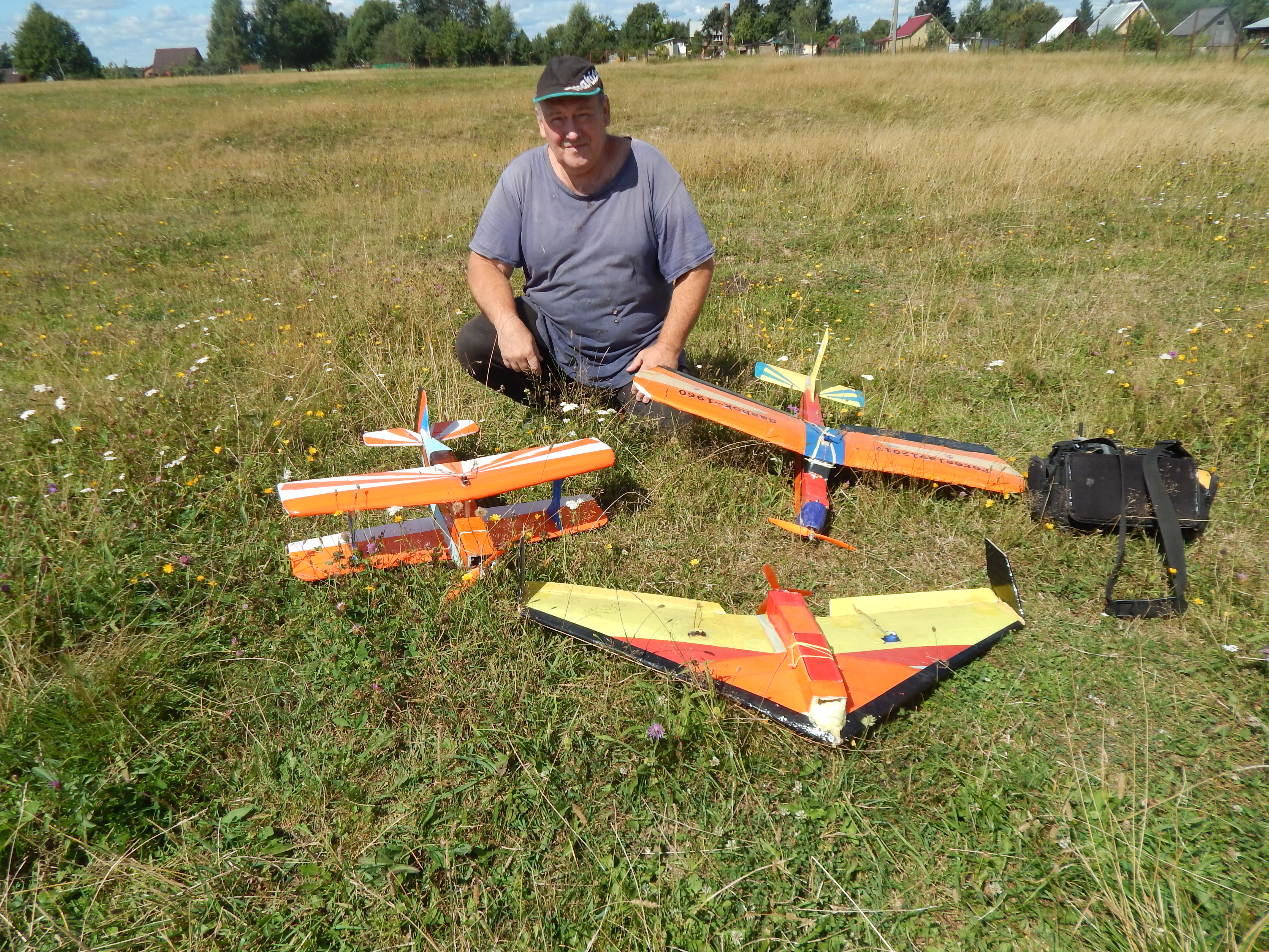

Shurik-1960
There is a rule for beginners in aircraft modeling : 1. Make an aircraft model 2. Install all the control mechanisms 3 .weigh the model 4. Add the weight of the battery and regulator 5. Select the engine according to thrust, taking into account the coefficient (1:1, 1:1.25- trainer, 1:2- aerobatic and higher for high-speed flights) .Everything that is done according to these rules flies.
