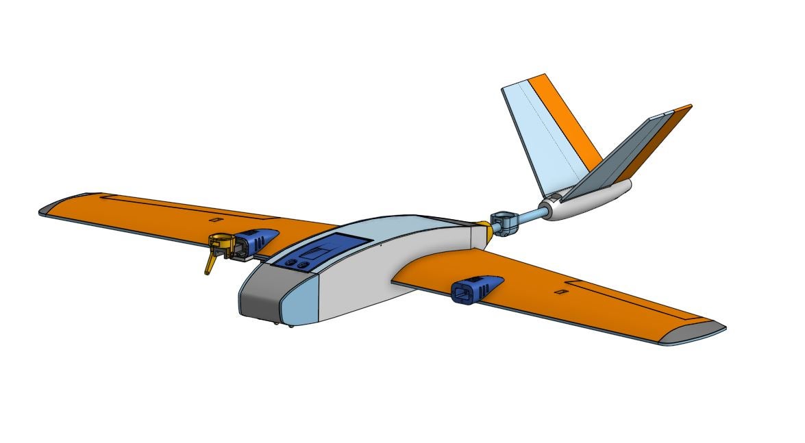

Are you guys maybe thinking of something like this?
Don't pay attention to the lack firewall's ect I'm in the process of designing a VTOL system for it (Vertical takeoff and landing)
