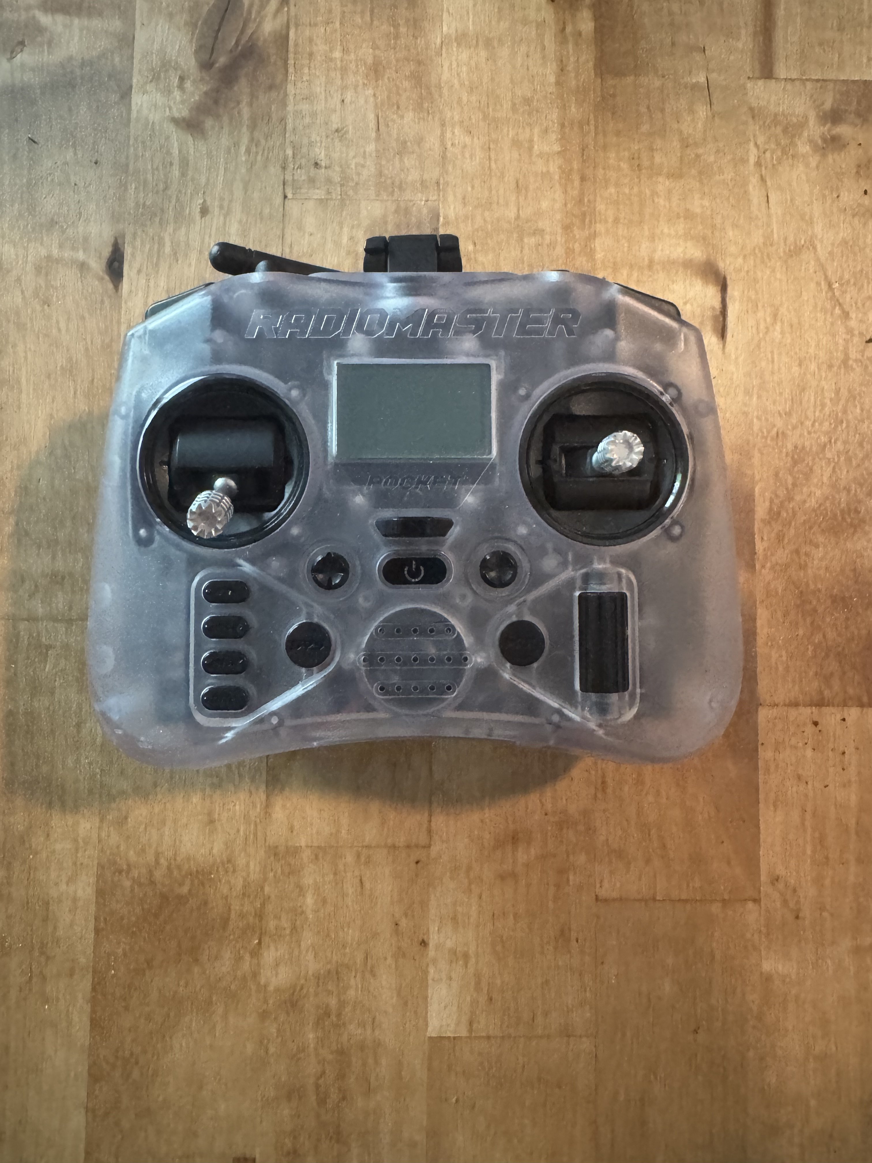

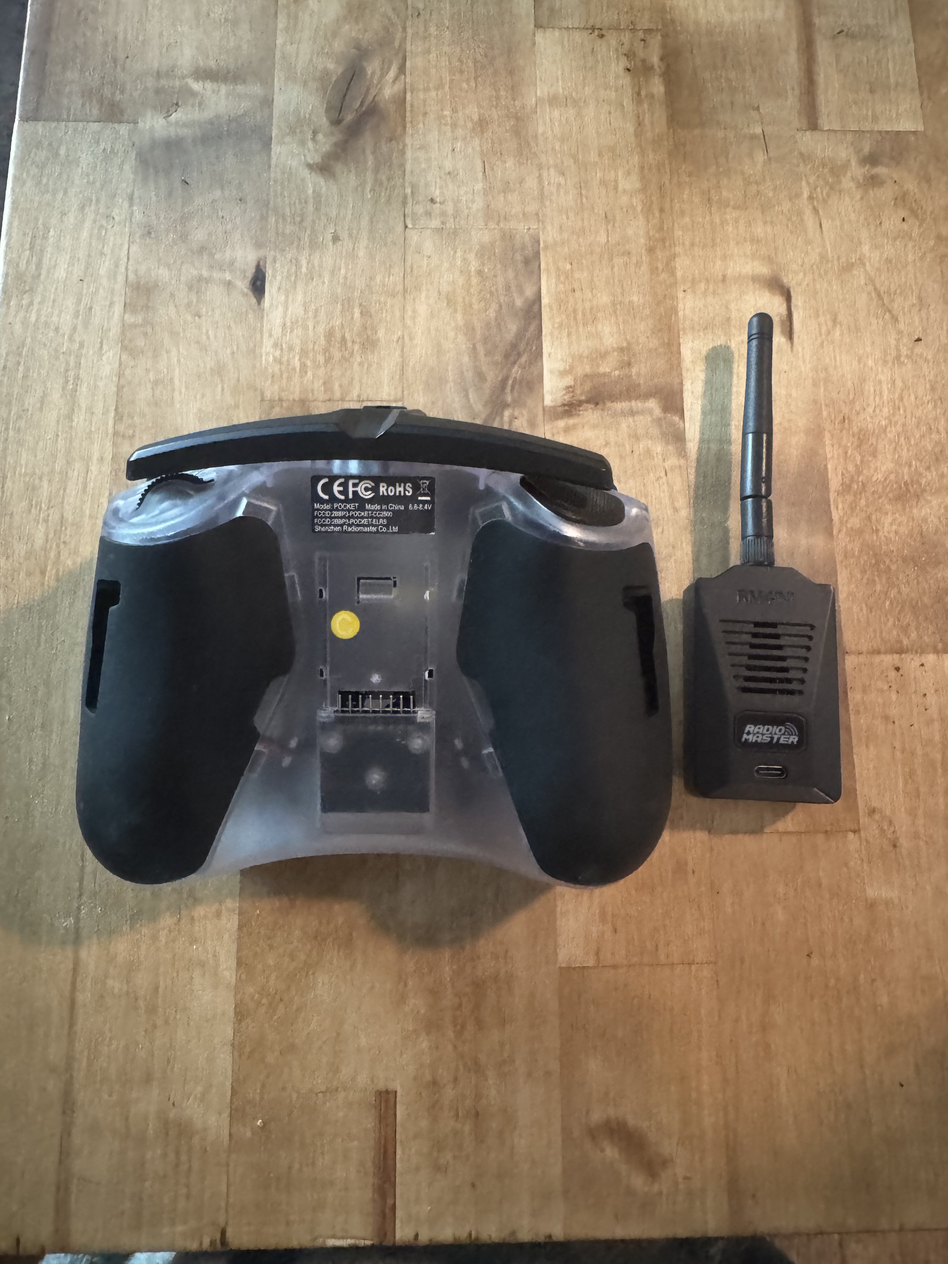

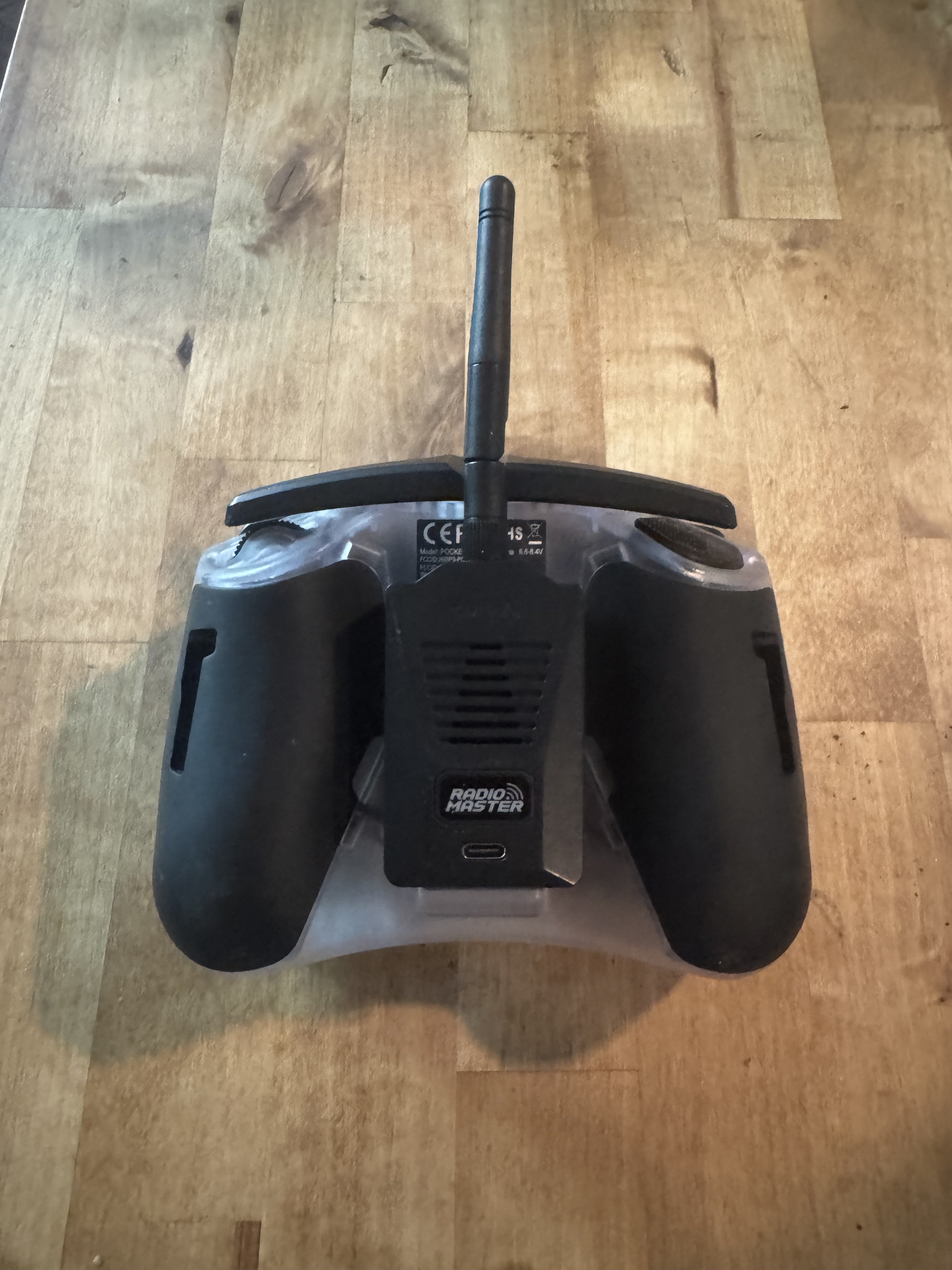

by FT Pocket, we are talking Radiomaster CC2500? the radiomaster cc2500 has a plug in on the back for an External Radio Module, the Radiomaster 4n1 is $60, snd contains the 4 major protocols, along with almost every other one on the market.
so for $120, you can have an extremely capable radio that does bind with volantex.
Captain J
*radiomaster cc2500 “pocket”
*back of cc2500 showing external module port
*2500 & 4n1
i own almost every volantex play ever built, there is only one on the market currently that is not V761, i also speak with Ex Hobby (volantex) weekly about their planes.
OP, you are almost there, dont get discouraged, shoot me a message, i can hop on the phone and talk you thru every step if need be. or even just make videos for you and email them too you.
this is all very easy stuff when provided the right info ✌🏻
