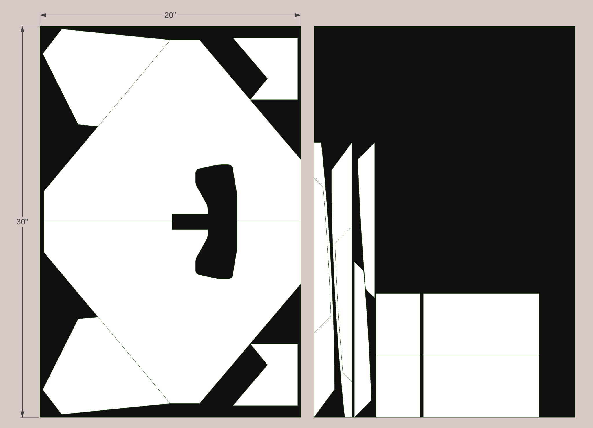

I'm not sure I understand your question. I've also not really studied the Master Series, so it might just be that I'm not familiar with what "sheet of skin" means. So far, I usually go the other way... the size of the materials you choose (say... DTFB) determines the size of the plane. For example... you might decide that you want to try putting all the pieces on one sheet or the biggest piece fits one sheet. Something like this...
