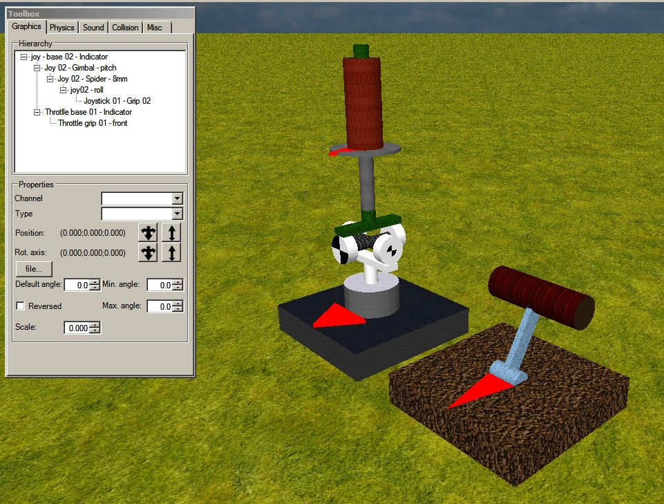

RCDP is old, so is SketchUp 2016 but they together are super easy and cool to make things with. I made a non flying thing
that works in RCDP and it really made me quite proud. Lemme find a pic.... * rifling through .jpg sounds *
( The fully functioning and flying flight controller. it has a twist grip yaw axis. Flies quite well...)
The skin on the model was done in SketchUp and is baked on, as apposed to the .png file way which gets put on in RCDP.

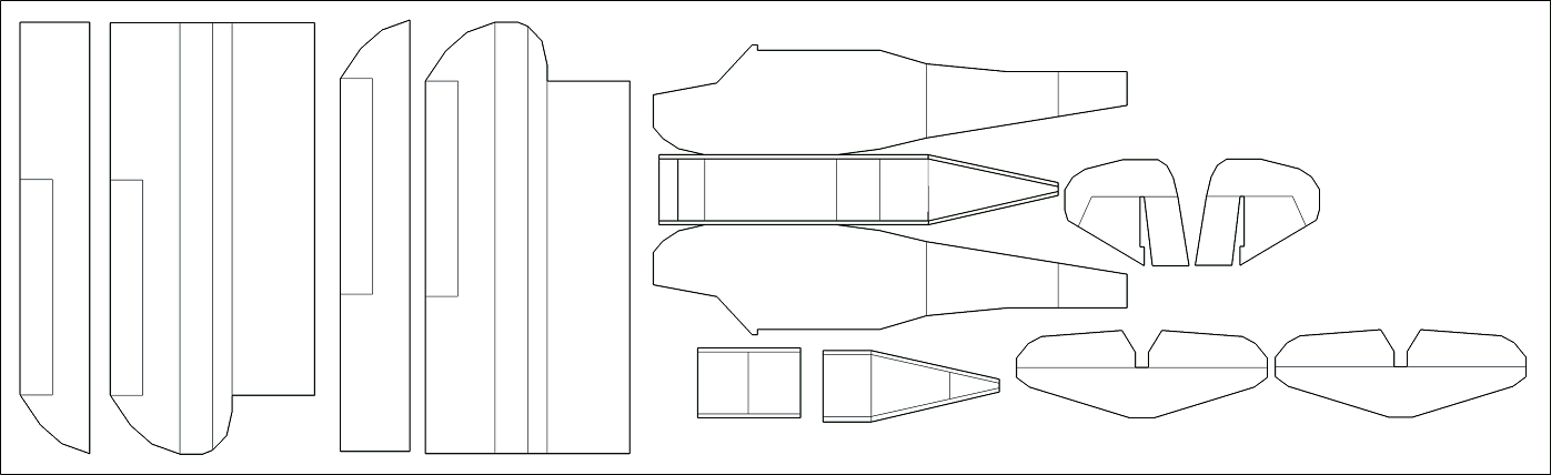

looking through the Aeronca Champ files I found the .png file that is used to create the paint work. How this file is made in
SketchUp is the nut of the problem. They even put the .SKP file in model folder. So I can see the result of the model makers work.

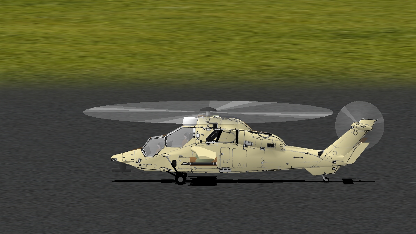

My fave plane in RC DP is the Radian Pro. and the Tiger Heli. ( I am trying to to put paint on the Tiger but it's tricky as...)

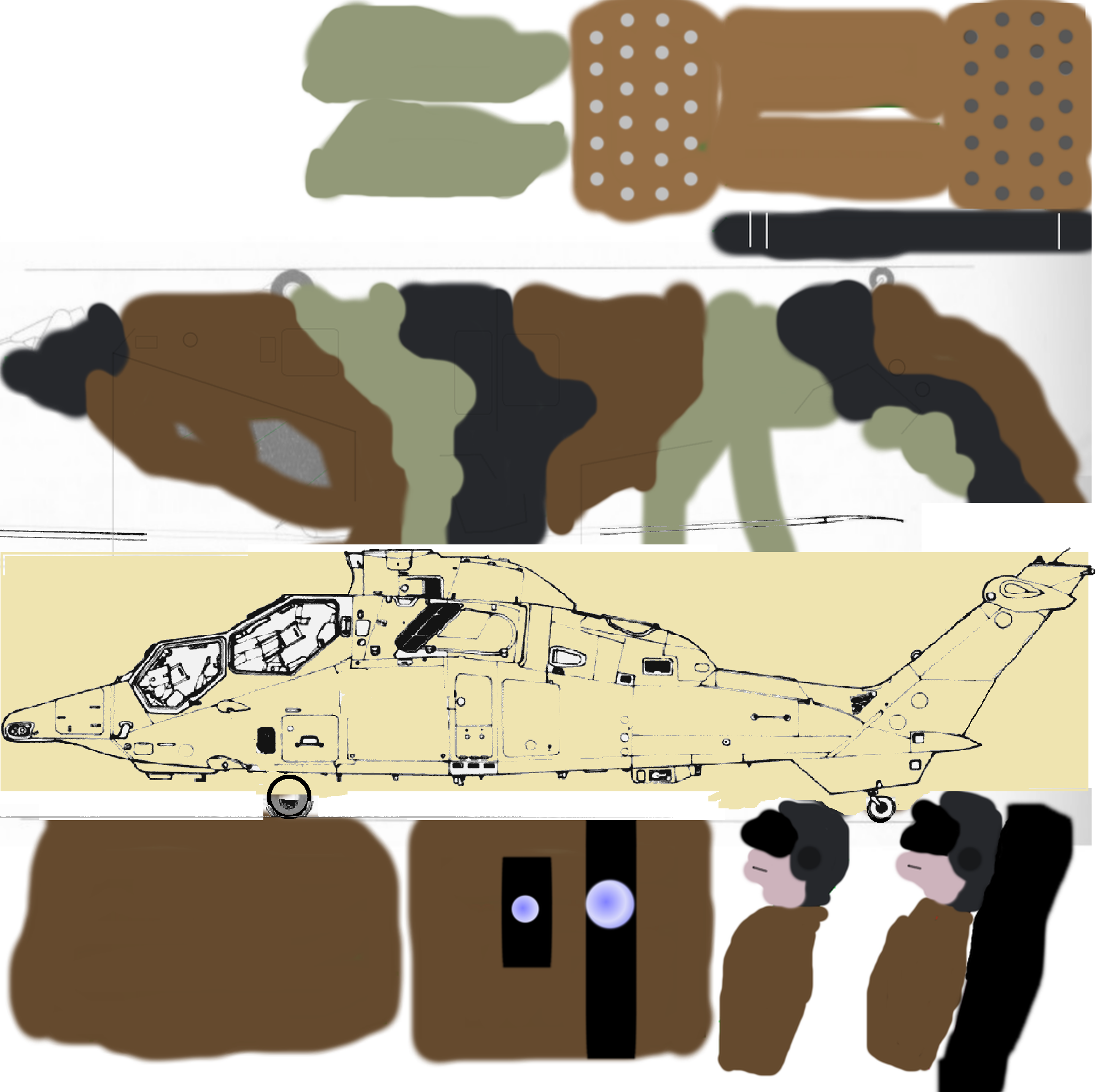

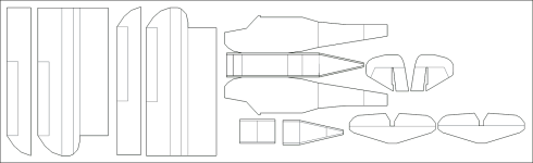

oh well, ahem. I worked out that the Tiger png is a profile diagram, so I found one similar and fiddled it till it fits on and
well, it mostly works. but it was really quite a lot of work.
