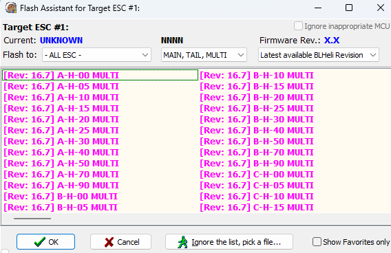

Hi all, I am new to BLHeli suite and I accidently erased the firmware on the esc while looking at the settings. I went to reflash the esc, but there were so many options (0-H-5 Multi, etc.) and the warning about flashing the wrong version. Can someone tell me what it comes installed with? Many thanks. Rob

I'm still stuck. I don't know what target to use. The mcu reads BB21 F166 if that helps at all. Thanks

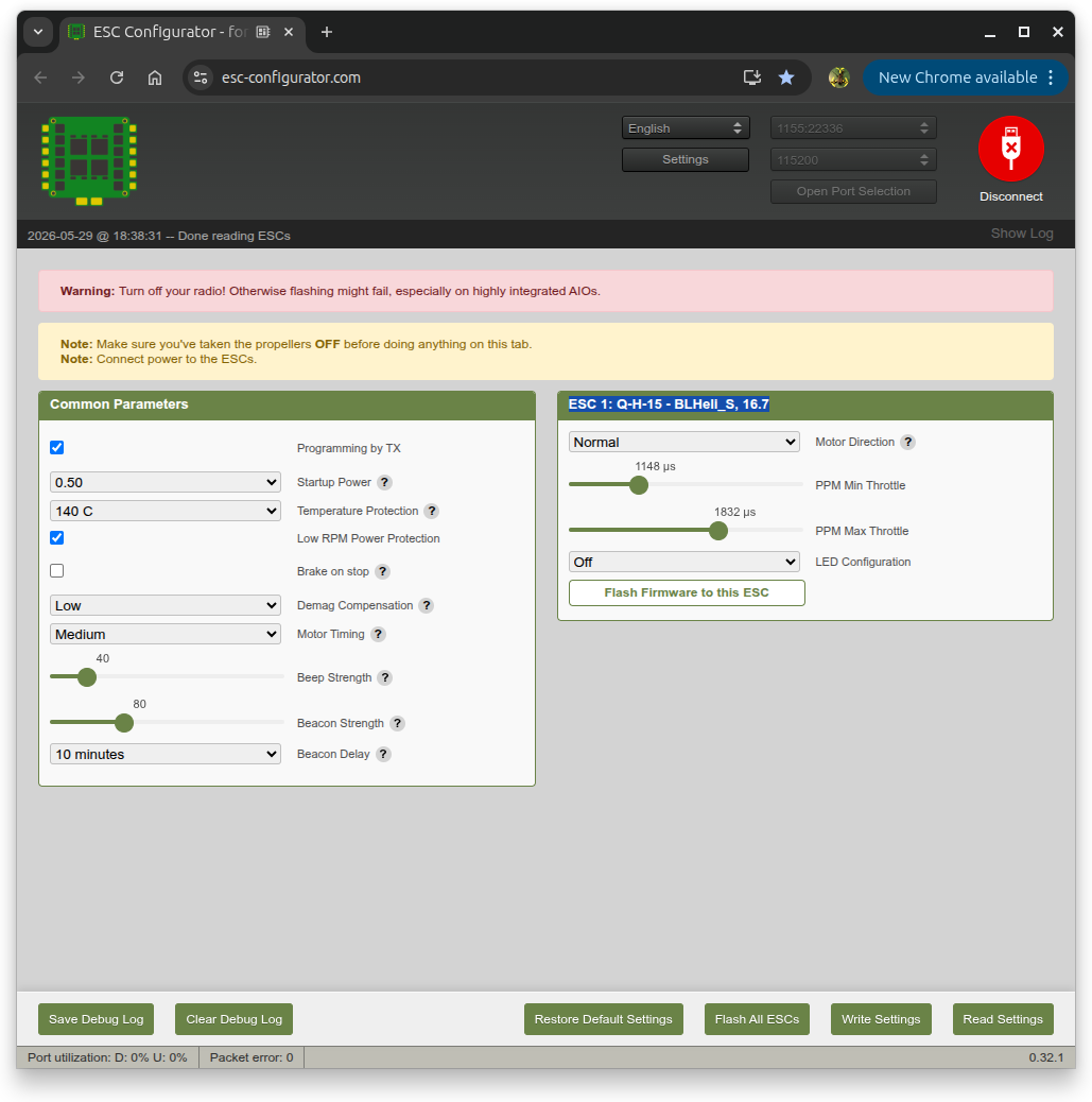

Well, I having an issue now where it won’t write to it. I’m not sure what the issue is. I can’t get the web version to work either.
Maybe it’s this dongle I’m using:
Are you getting error, and if so, can you take a screenshot?
Also, make sure you have a charged battery connected. (Props off!)
