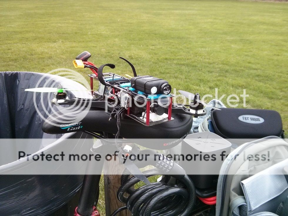

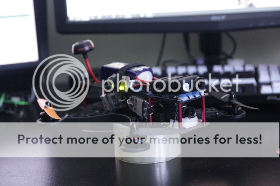

Howdy all. Thought I'd make mention of my FPV 250. Solid little thrasher that I both love and hate.
Specs:
Diatone 250 frame and cage
Gemfan 5030 props
RCX 1804 2400kv motors
RCX Gseries 10A ESCs
Flip 1.5 mw 2.3
Spektrum 6210 + satellite
Fatshark 250mw transmitter
ImmersionRC spironet CP antennas
Fatshark 600TVL CMOS camera
Nanotech 1300mAh 3S 45-90C lipo
Mobius wide angle version
AUW is around 530 grams, which I feel is a bit too much for the RCX motors. Flies pretty well otherwise, just 'high-G' manouvers really aren't doable and feel like driving a dump truck. It'll definitely take a hit and keep on ticking however. I haven't quite tuned it due in part to laziness either and it still flies well.
I've only been flying FPV for a few weeks and that time in itself is sparse and spaced in between, but this frame is nice 'cause I really don't mind if I wreck it. Helps me go fly fast near things without a care :) I was more upset over breaking my lens one day than I was the frame, which required far more work to deal with (good thing I bought extras :D).
