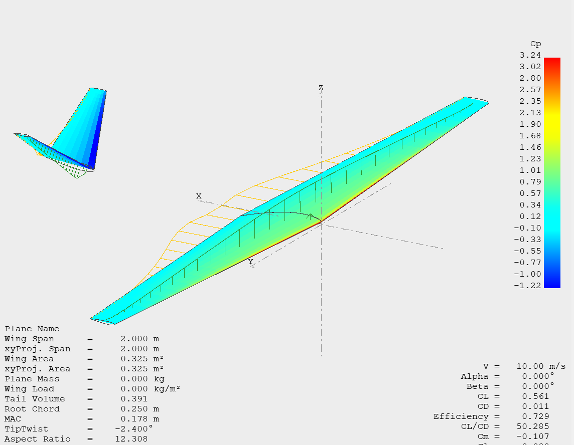

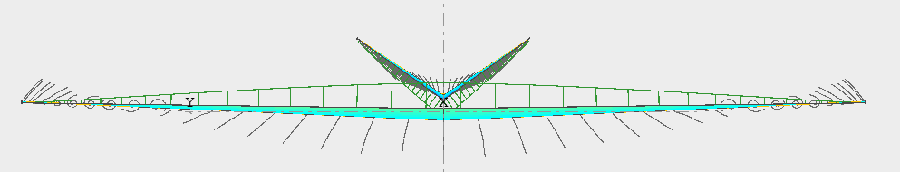

just got the parts to build a hot wire and decided my first project with it would be an rc slope soarer
im going to the outer banks for vacation and hopefully there are some steep enough slopes on the beach for so that I can do some slope soaring
some cfd images so far
decided to have a prandtl bell shaped-ish lift distribution because why not (i kinda just guessed and checked what amount of twist gives a lift distribution similar to the bsld since i have no idea on how to do the proper math)
also just wondering, would 3d printed hot wire templates work? the most heat resistant filament I have is some bambu lab petg hf and im not too certain it wont melt when I pass the hot wire over it.

Regarding 3D printed hot wire templates, I wouldn't trust them by themselves. If your wire is too hot and you pause on the template for a second, you very well might melt into it. If you add some aluminum tape to the edges, however, that should protect the template enough to be usable.
View attachment 251694 View attachment 251695
