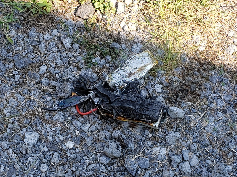

This is what can happen when you charge a battery at the flying field in a trailer during a meeting. Fortunately a few people heard the WHOOMMPPP! Ripped the battery from the trailer and flung it onto the grass.
