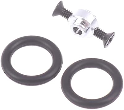

What you are describing in the video is know as a prop saver. It looks like this

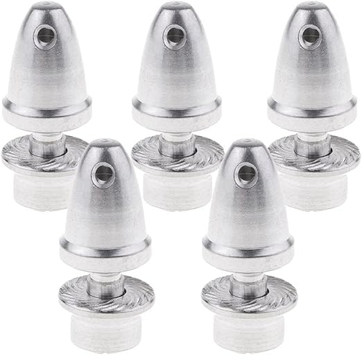

Another type is called a prop collet, it looks like this
I have no idea what the size of your motor shaft is, that is something you will need to measure. The common sizes are 3mm, 3.17mm, 4mm & 5 mm. It is difficult to tell the difference between 3 & 3.17 mm by looking at it, you really need to measure it.
Here are some links to Amazon Prop Saver, Prop Collet
