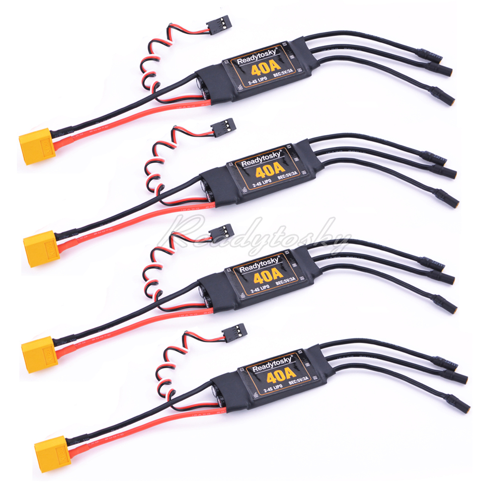

Hi I'm building my first RC wing, I bought a kit that came with the ESC in the title and I don't know how to charge it. It has an xt60 plug. I've attached a picture of it below, please recommend any charges I can buy on Amazon. Thanks 🙏

quorneng
Your question suggests you are a novice at electric flying.
The function of the ESC (electronic speed controller) is to control the speed of the motor.
It is the battery (usually a LiPo) that you charge and this must be done using a dedicated LiPo charger suitable for the size of the battery you intend to use.
More details of what you intend to build would help.

The lipo battery and ESC are combined in this I'm pretty sure. I am building a RC wing based loosely on Samm Shepered's design on YouTube. I don't know what type of lipo charger I need to charge the Lipo/ESC. The videos I've seen so far say I need to plug the lipo to a charger with two connections, one for power and the other a balance plug, but you can see that mine doesn't have a balance plug and instead only an XT60 plug, so I want to know what charger I need to safely charge it.
If what you have is what's in the picture then those are only ESCs without batteries. Here's what a complete set up looks like:
Niaz
Ok nvm what I said, I thought they were combined. Would you be able to recommend a battery I can use for the ESC I have? And a cheap charger to go along with it?

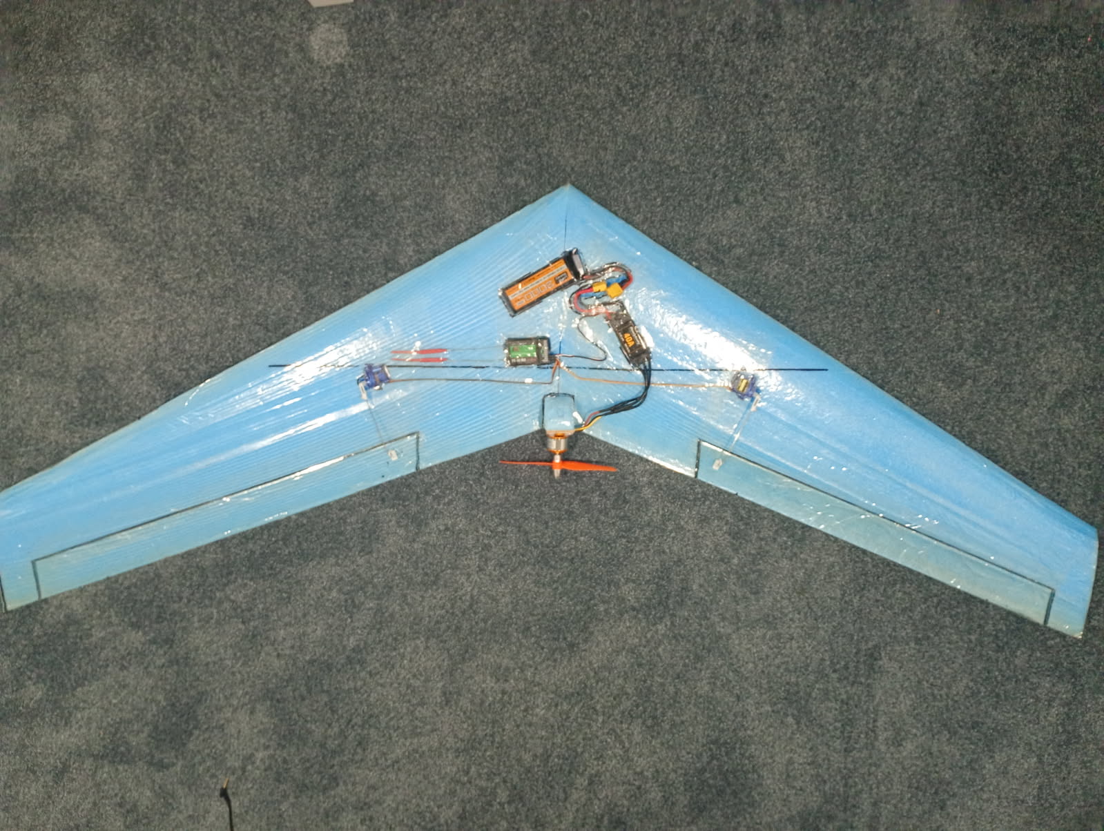

I made the plane but the motor is too weak for it. Final dimensions are 140cm wingspan, 30cm root cord, 15cm tip, 31 degree sweep, weighs 450g.
I also put in a 2000mah 2S battery.
Stability and control isn't much of an issue, it flies for a few seconds at a low altitude but quickly drops. I can't get it to gain altitude even with my throttle all the way up. What motor would you recommend for this configuration?
Niaz
Merv
...What motor would you recommend for this configuration?
First, make sure the prop is the correct way around. The numbers MUST be facing the direction of travel. In your case, the umbers must be facing the plane. If you had a tractor motor, the numbers would be facing away from the plane. If the prop is backwards, you will only get about 40% of the thrust.
Rather than change the motor, try changing the battery, try a 2200 3S. The extra voltage should make the difference.
On my wing, I use a 3536 1400kv motor. On 3S I have plenty of power, unlimited vertical, it will go fast. For your experience, look at a 2212 1000kv, maybe a 2830 1000 kv. You mostly want a lower Kv motor, it produces more thrust at lower speeds. A high Kv motor (2200) is for going fast but has far less thrust at lower speeds. With a lower Kv motor you will need a larger prop.
