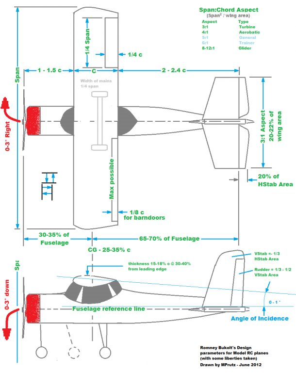

Flying well is hard, there are 2-3 dozen factors that need to be right. Here is a starting place.
Here are some general rules of thumb that most successful planes will follow.
