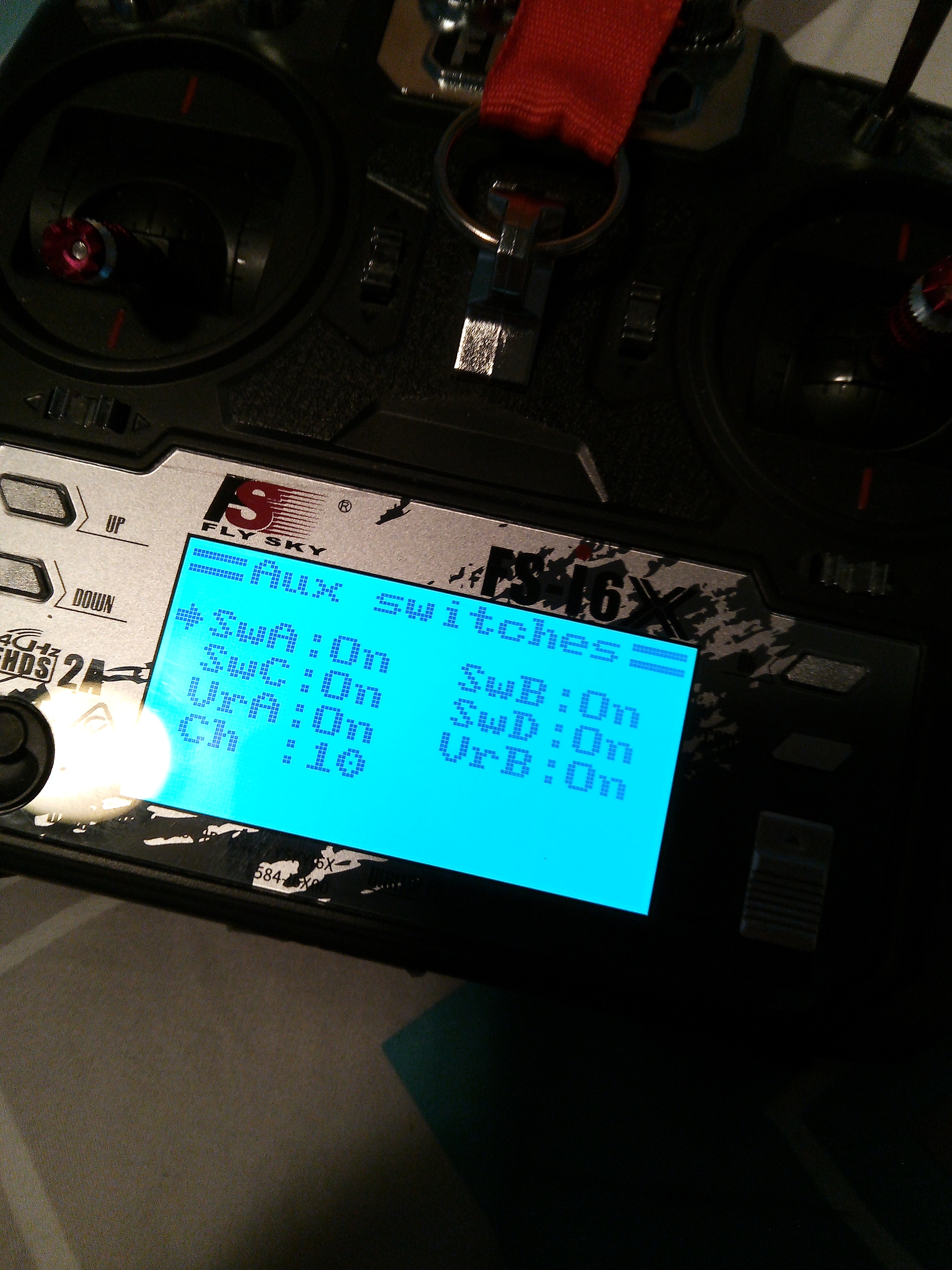

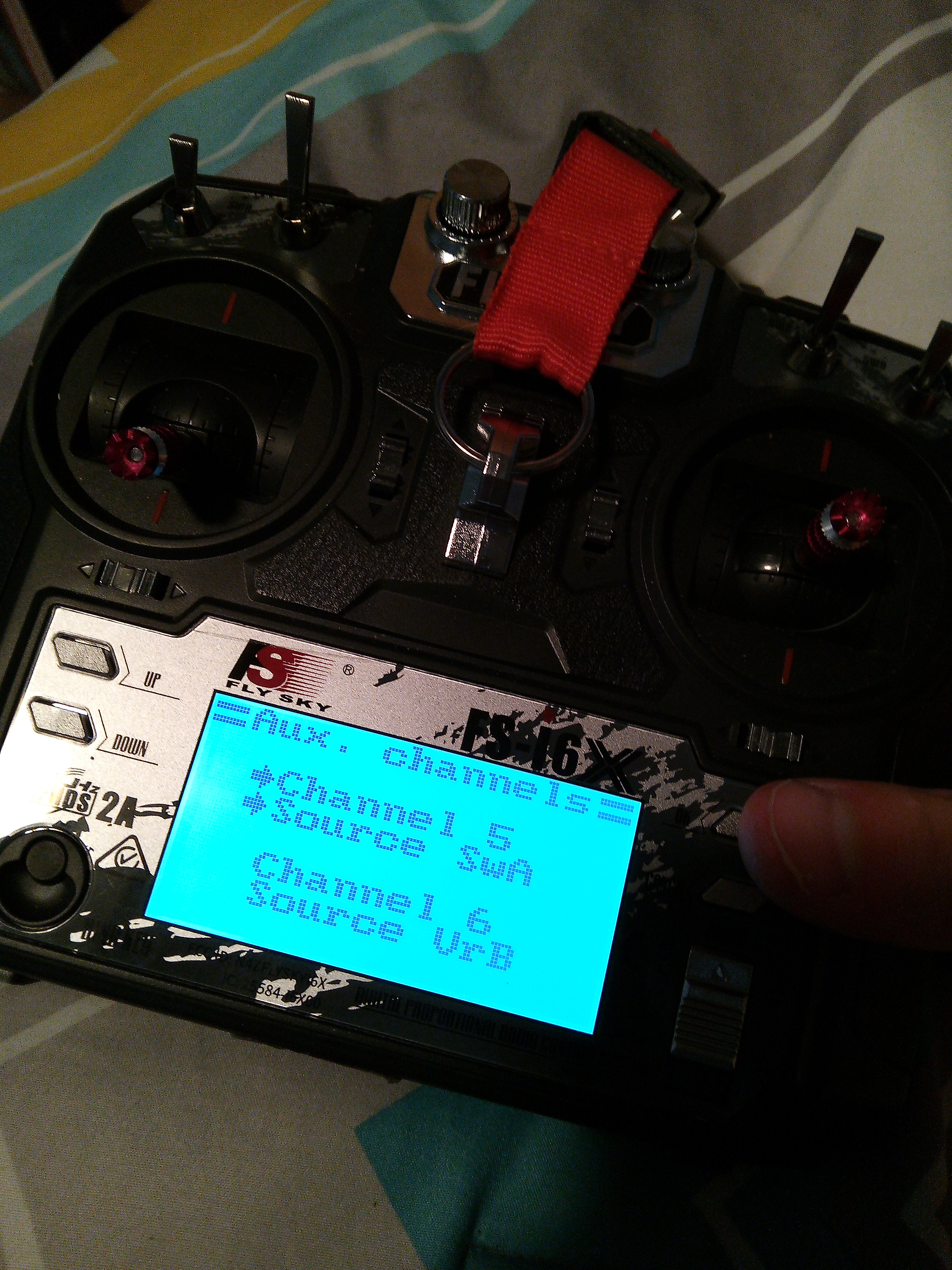

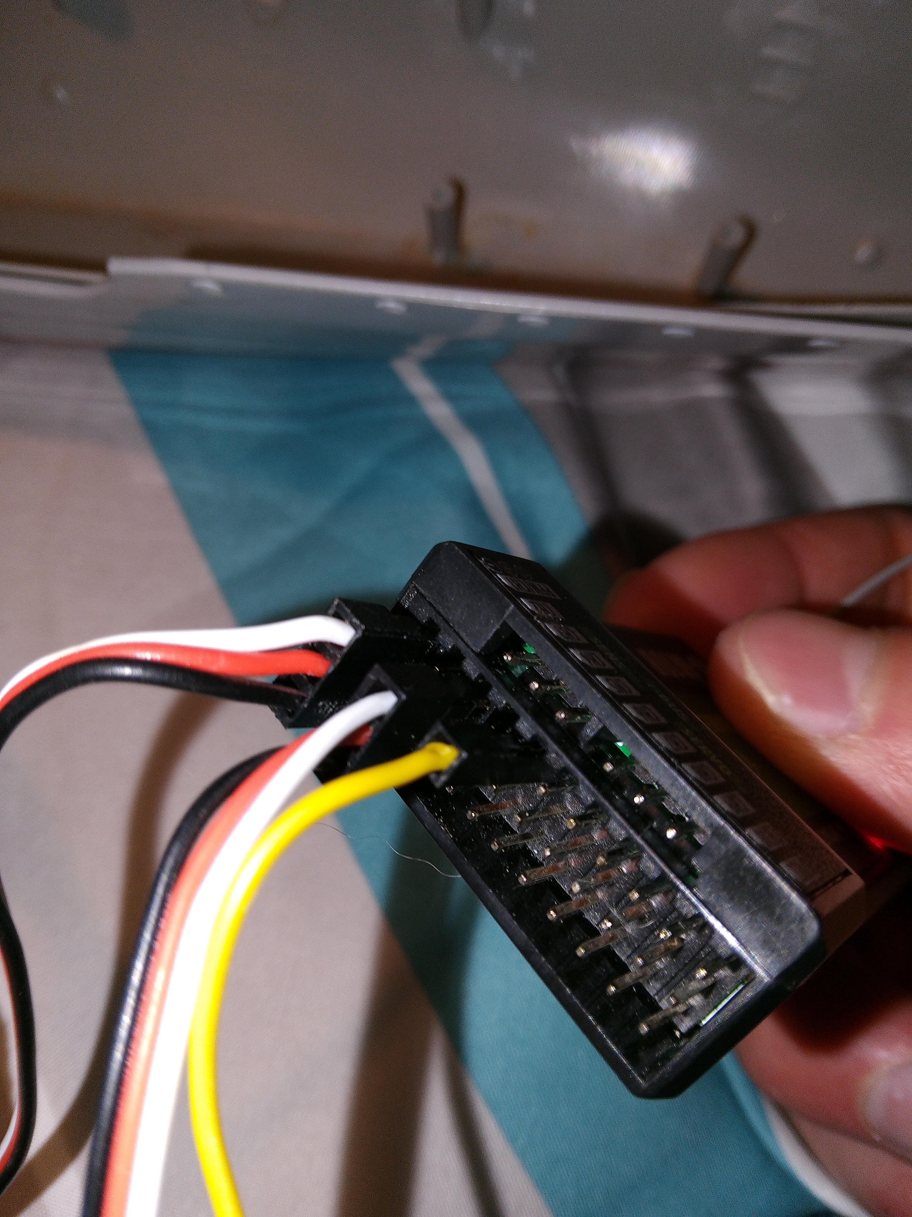

1) On the ESC, make sure the single wire is hook up to the signal side on the receiver channel.
2) On the transmitter, set up a 2 position switch(such as gear) to the same channel as the yellow wire, so when you flip the gear switch, it moves from one end of servo to the other.
3) Check prop/EDF direction , if reverse, change the servo direction.
