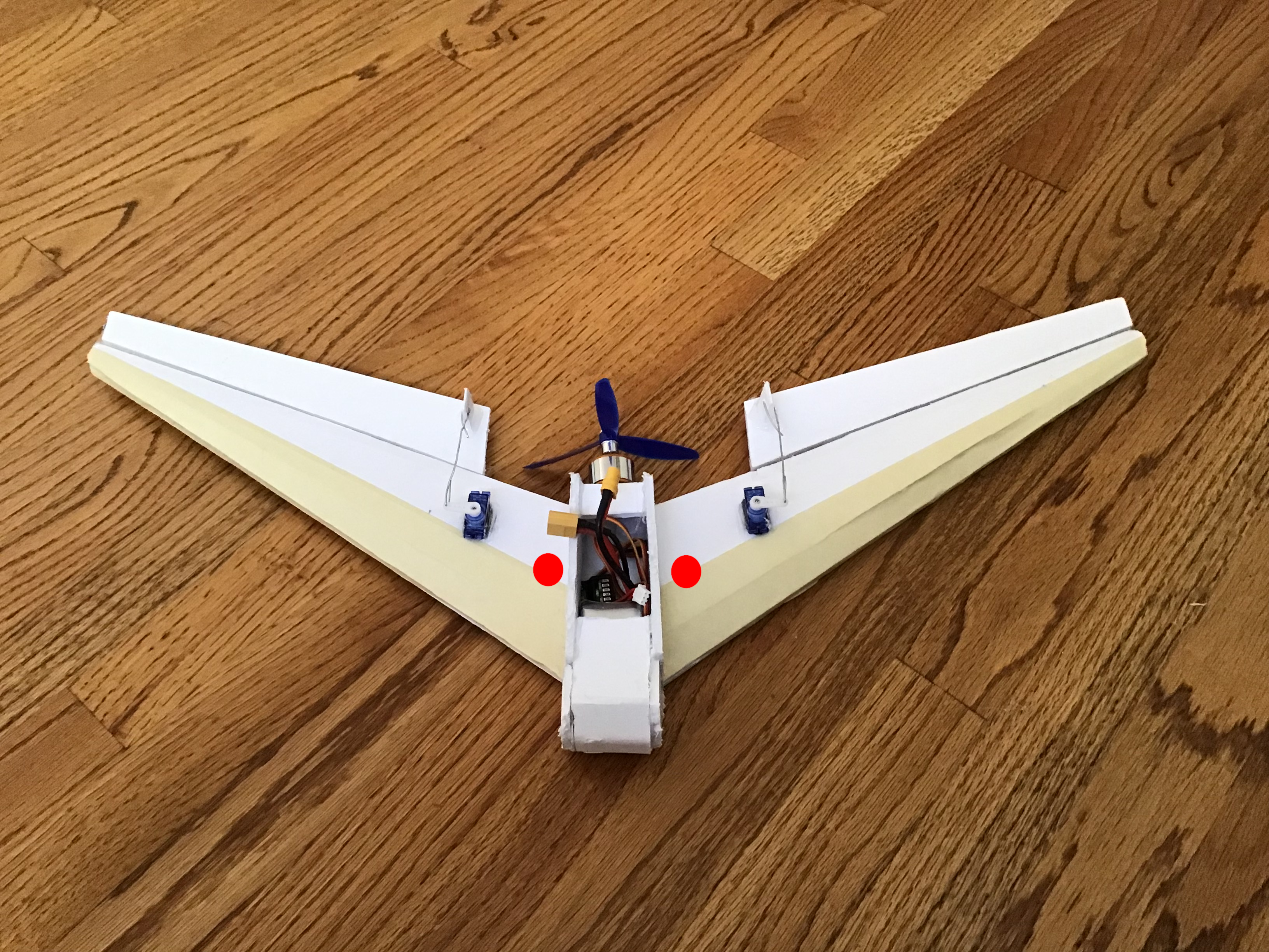

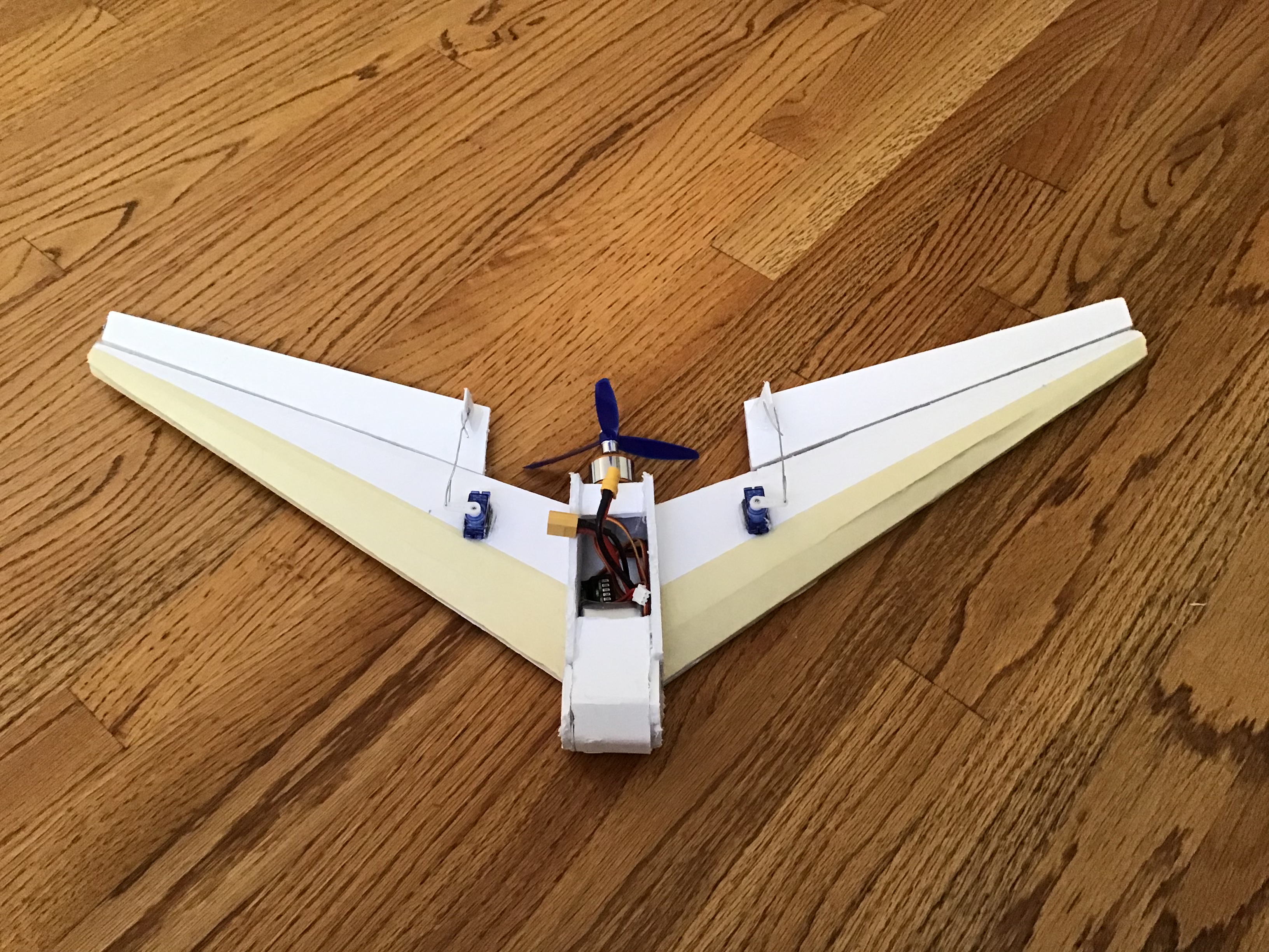

I built a flying wing plane weighing 245 grams with the battery. It uses a 2200kv motor, has an 5x4.5 tri prop, and a 850mah 3s battery. Does anyone know if it will be able to fly?

It’ll need a lot of speed to keep it in the air, and I hope you get CG correct, because that’s the most important thing. 👍👍👍
The control horn geometry on the elevons is kind of backwards.. The connecting point should be over the hinge, not the back of the control surface. This may limit the usable deflection of the elevons, espescially when moving down.

It seems that my cg is an inch too far back. How can I move it forward
Try these a little at a time:
Move the battery more to the front, if possible.
Reposition the ESC and /or RX toward the front.
Add weight to the front. Washers, coins, lead, hot glue, etc.
You could try removing a small amount of foam from the back of the control surfaces to remove rear weight.
