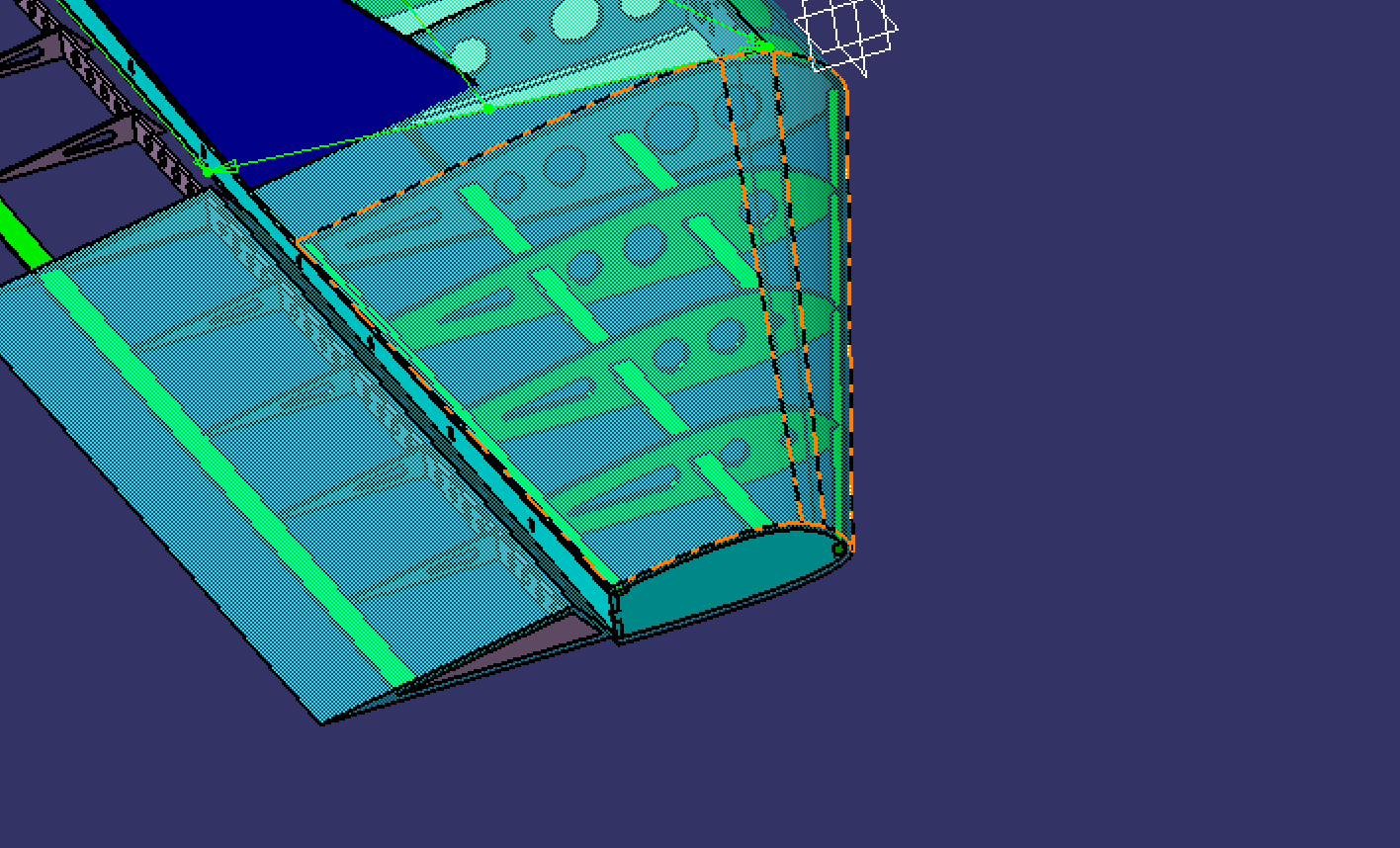

I have designed a flying wing like this,and I want to produce it with KT Board.But how should I flatten such a curved surface into a plane and generate cutting guides for the board?

It totally depends on what drawing program you are using. I use the free version of Fusion, which has a sheet metal function. I think it will unfold a model but I've yet to get it to work. At the moment I draw a flat sketch using the measurements from one bend to another to make the score marks. Then generate the G code form this flat sketch.

Thank you,I think the sheet metal function is a good choice,too.But I'm worried that using kt board won't show its original airfoil shape.
