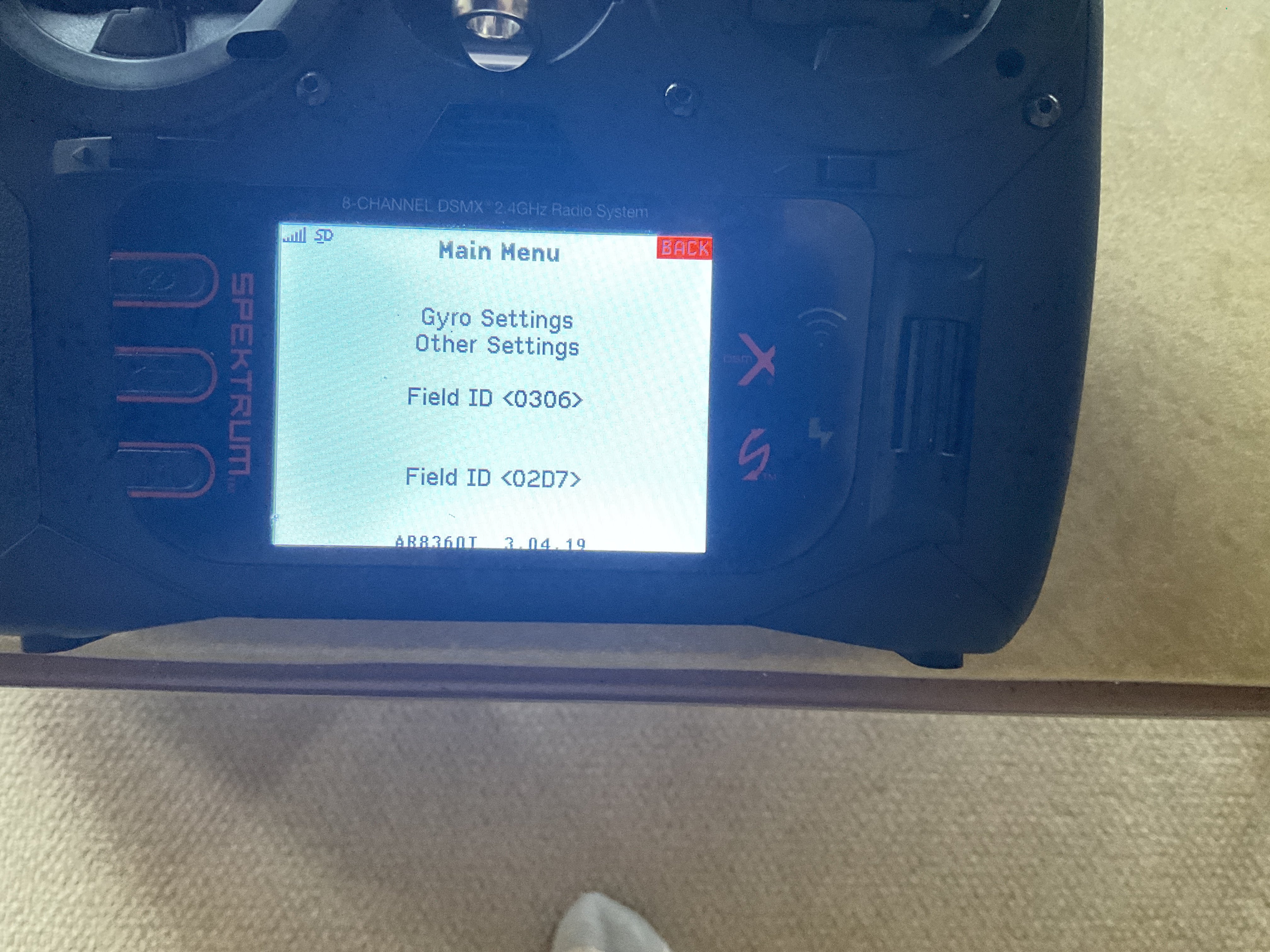

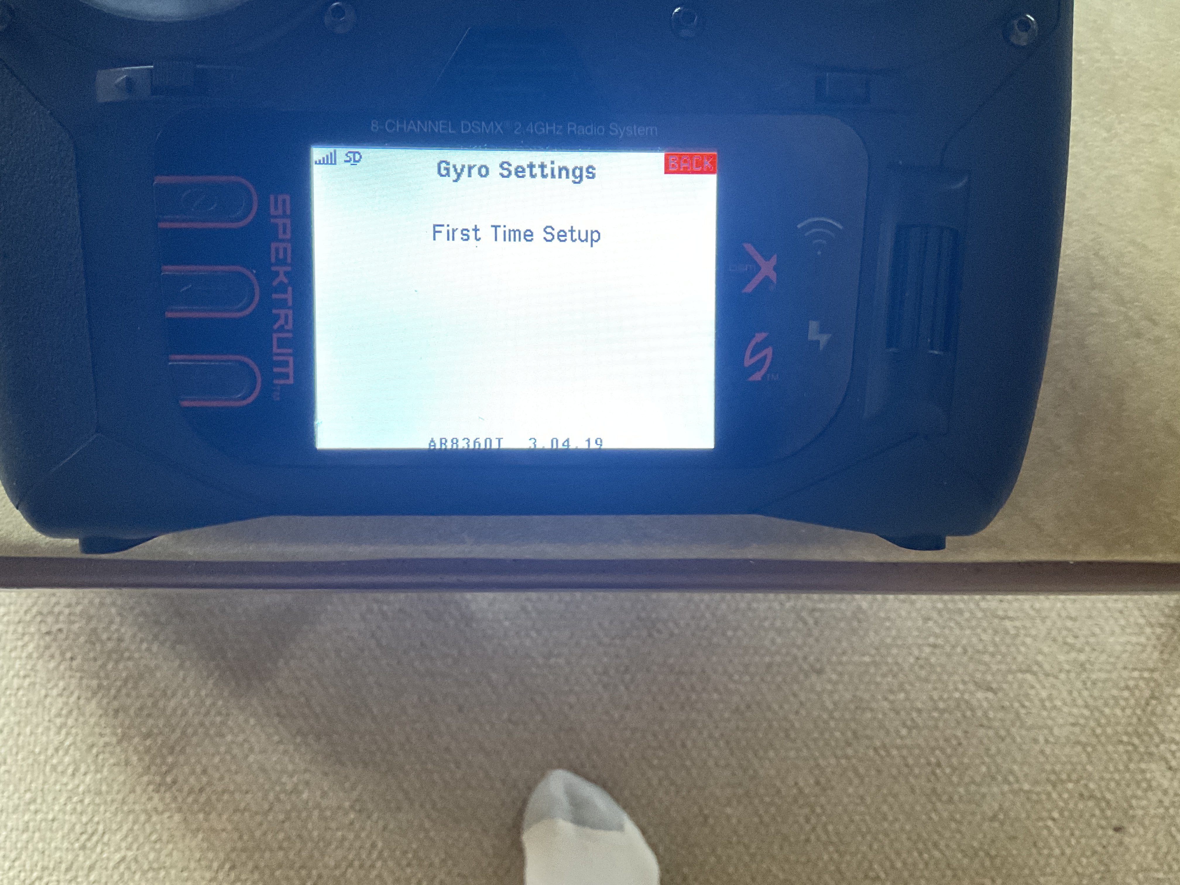

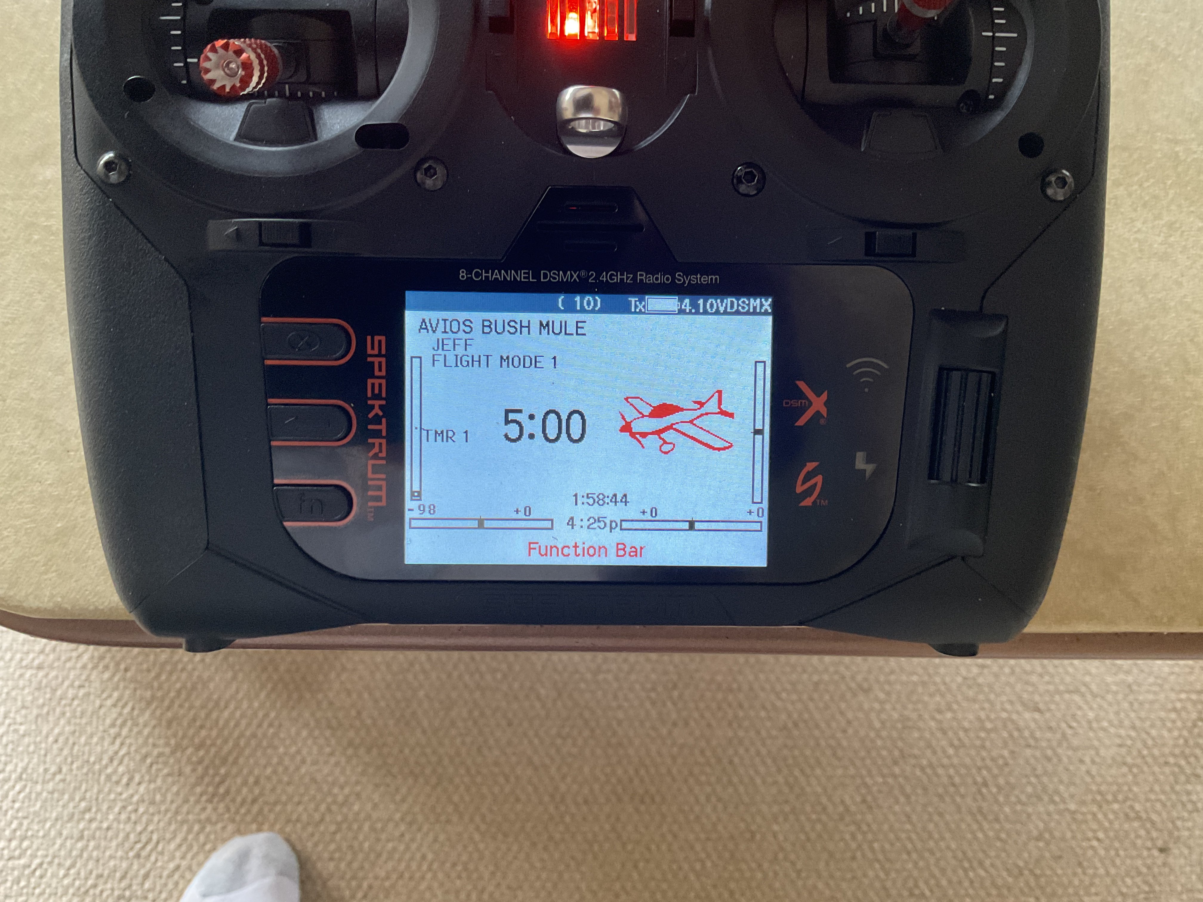

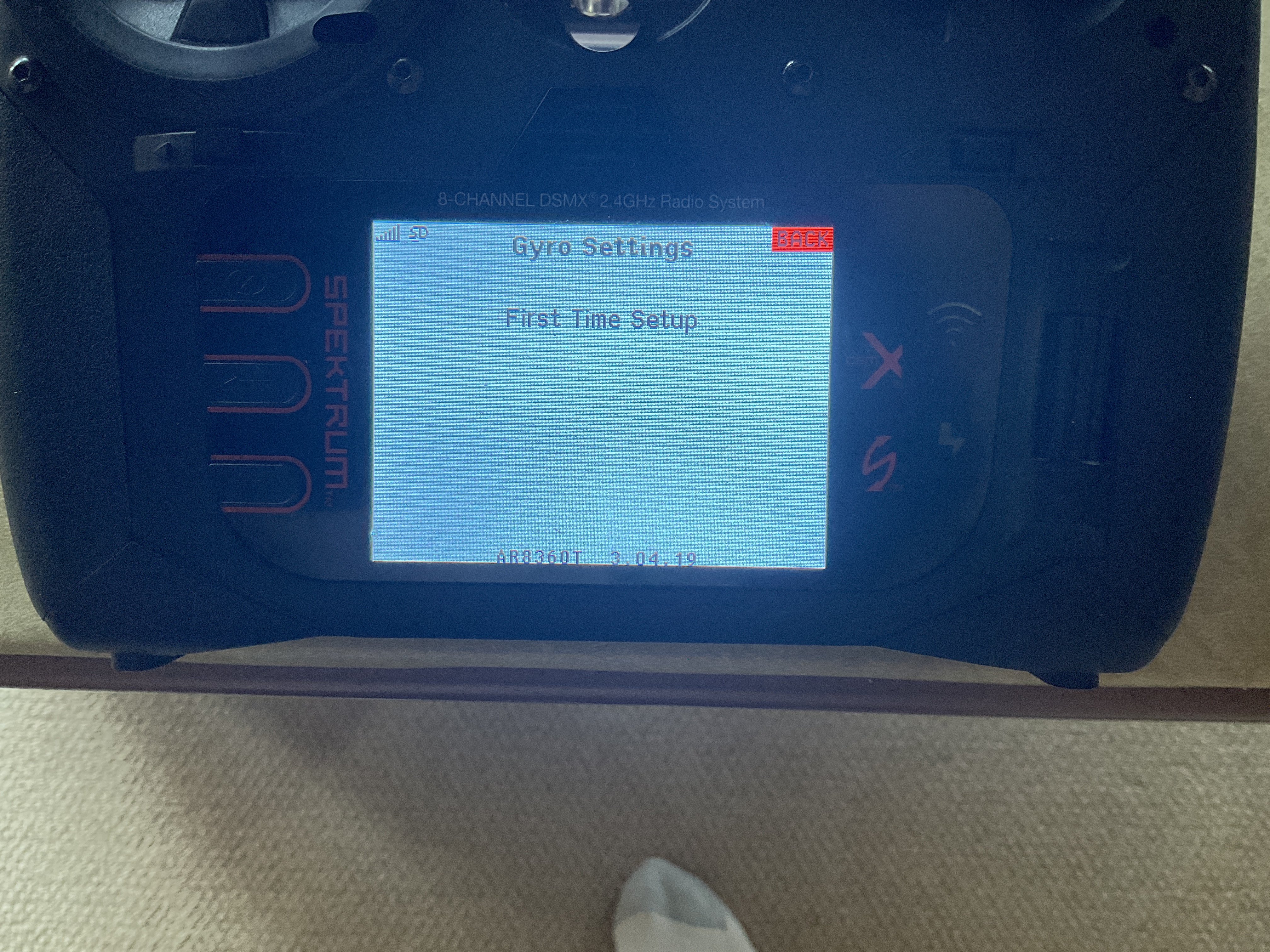

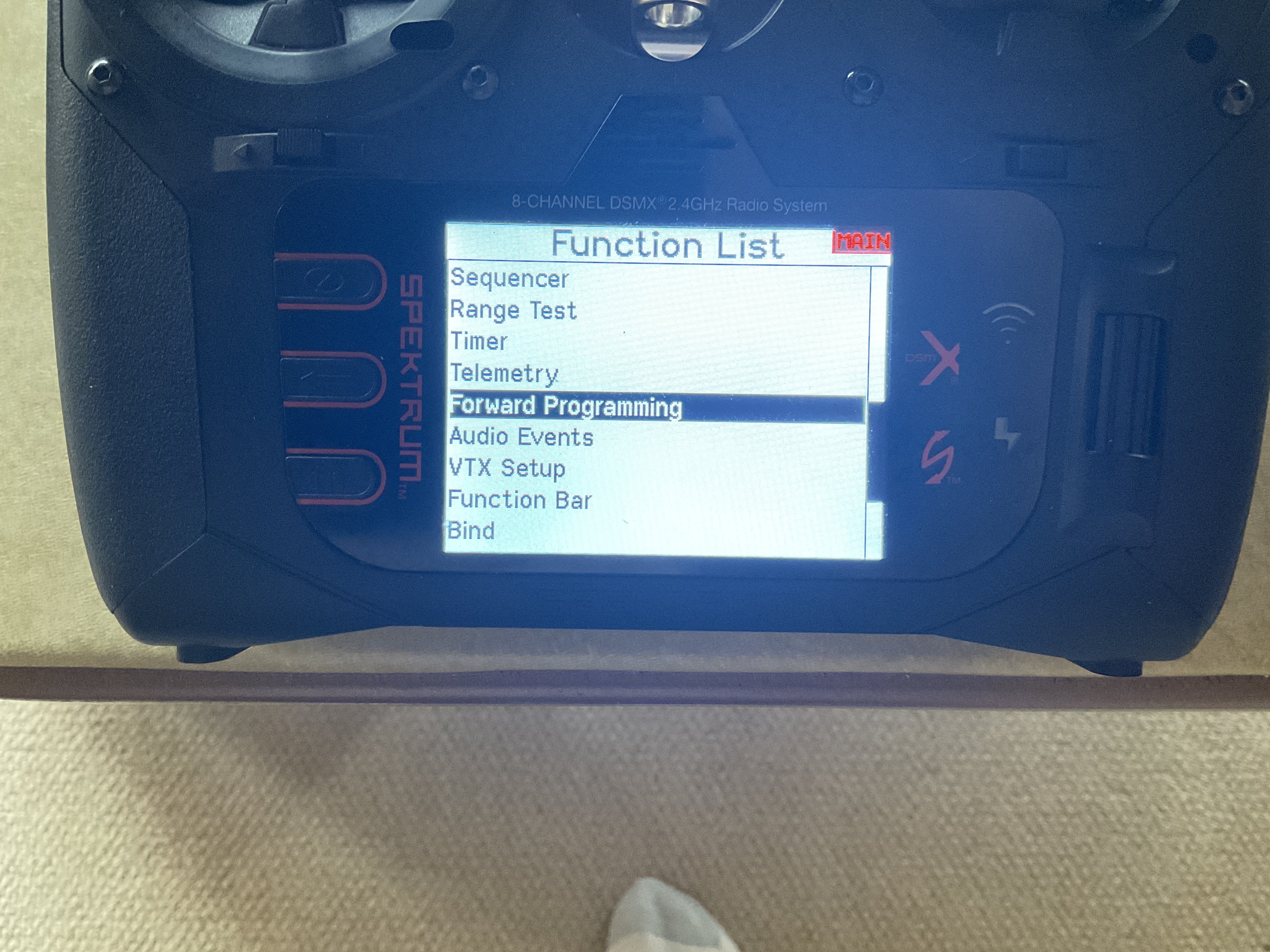

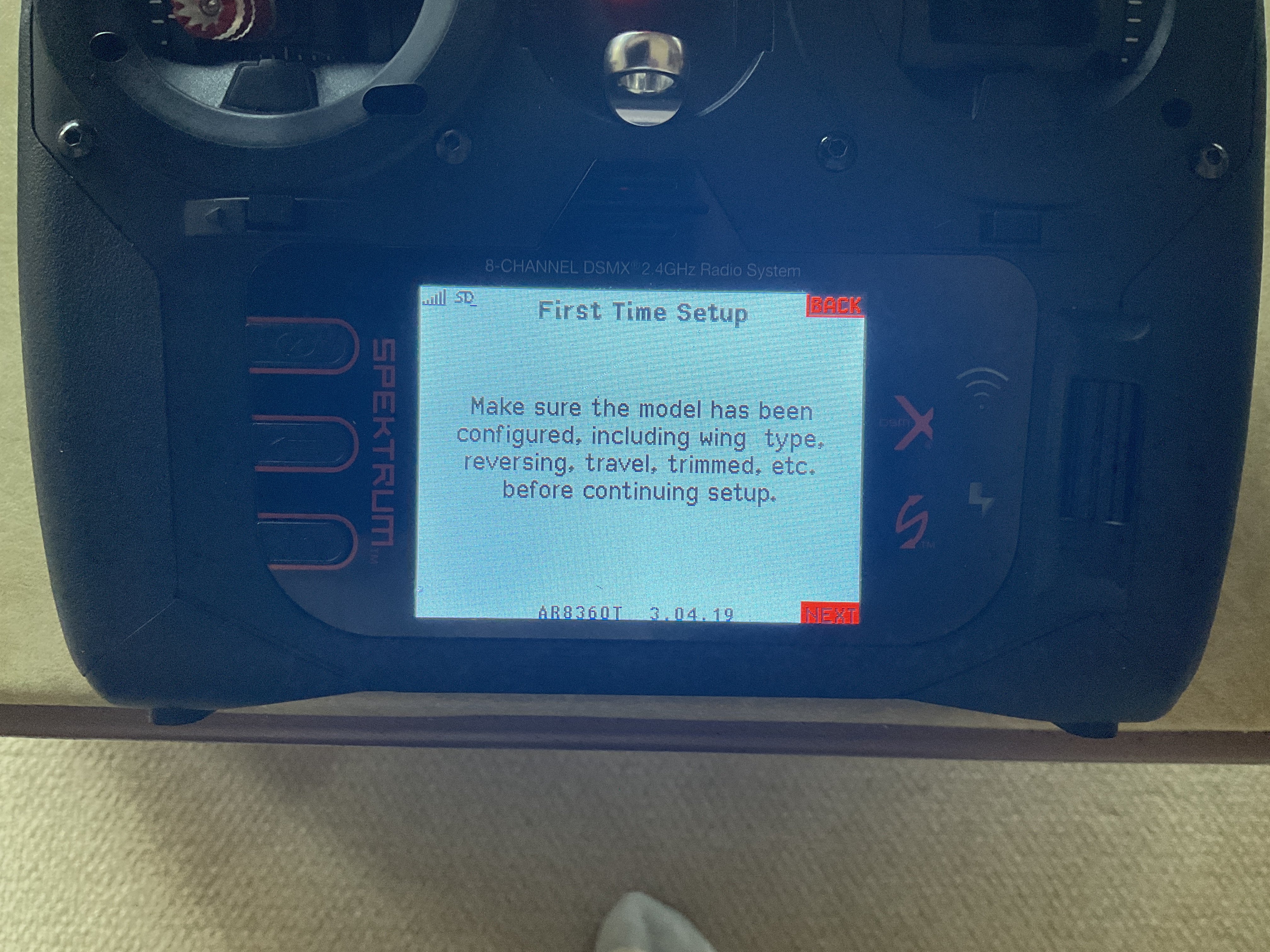

Thank you for explaining how you got yours to work. I attached some photos when I could. I have been through the steps that you have so nicely explained. Including the factory reset and after making sure both firmware downloads were from this past December.
After it prompts me through 1st time programming it bouncers me back to the first time setup screen. I have been at it for at least 7-8 hours on and off.
Thank you for your help.

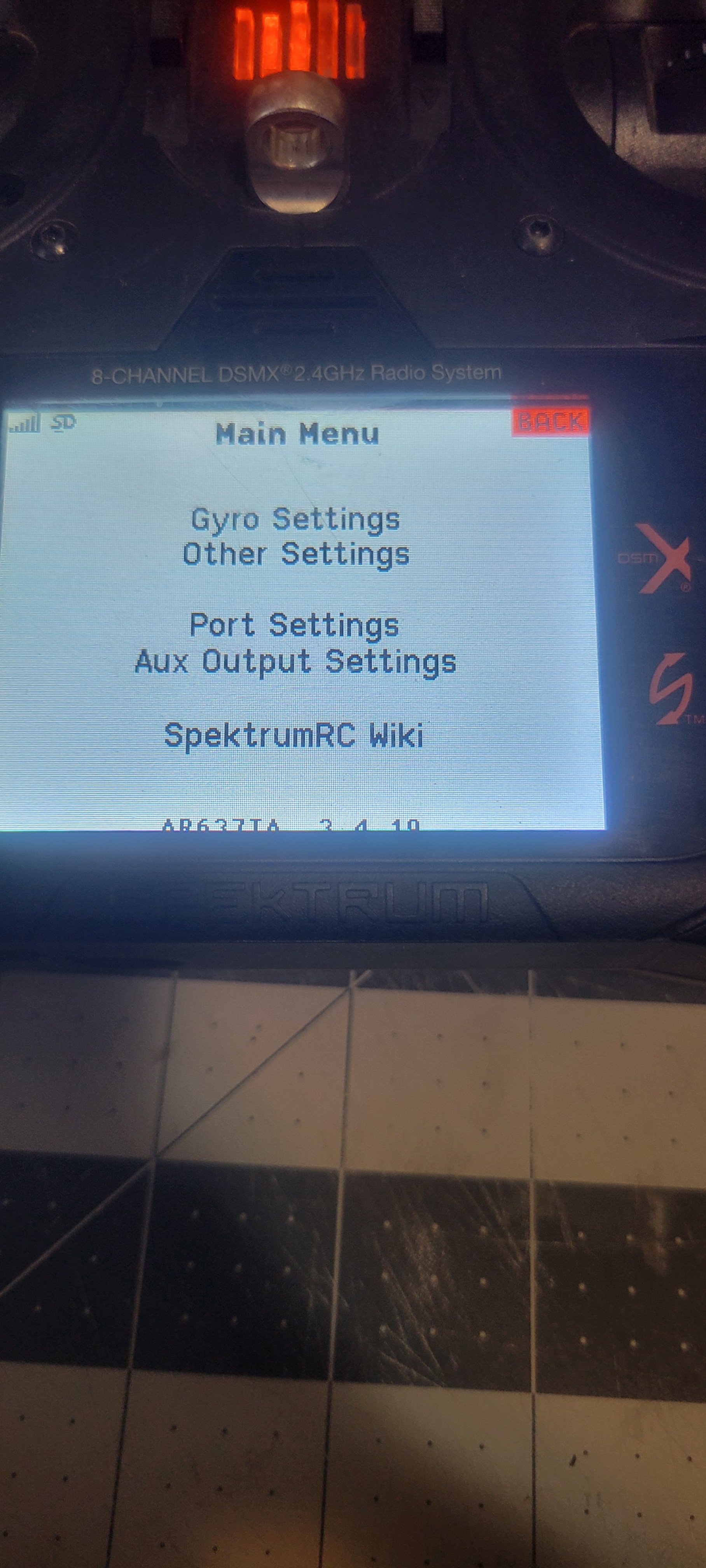

That screen looks a litte strange. See how mine appears. You said you are running 4.01a software. When I did an update on my NX8 last night, my software says 4.02 (located in SYSTEM SETUP, ABOUT/REGULATORY). Maybe try an update if possible just incase your controller has bad software.
This can be so frustrating. Been there. I will be home most the day fixing my 200% Mustang for tomorrow, so just let me know if I can help anymore. Though I haven't been a ton of help yet.

Thanks, I am going to get on the nx8 internal wifi and see if I can get the latest version. Maybe it did not complete last time.
jayoldman
Ok, so after a couple of dozen tries I was able to download the latest firmware 4.02 and the information on the screen represent
the completion. And after rebooting the radio and rebinding the receiver, I still cannot get passed that initial 1st gyro setup.
So back to the drawing board with making sure and triple checking the latest firmware for the AR8360 T which is only
a few weeks old from Horizon and my AR630+ which I got in 2024. It is something I am doing or not doing correctly.
But with your help at least I had some progress.
