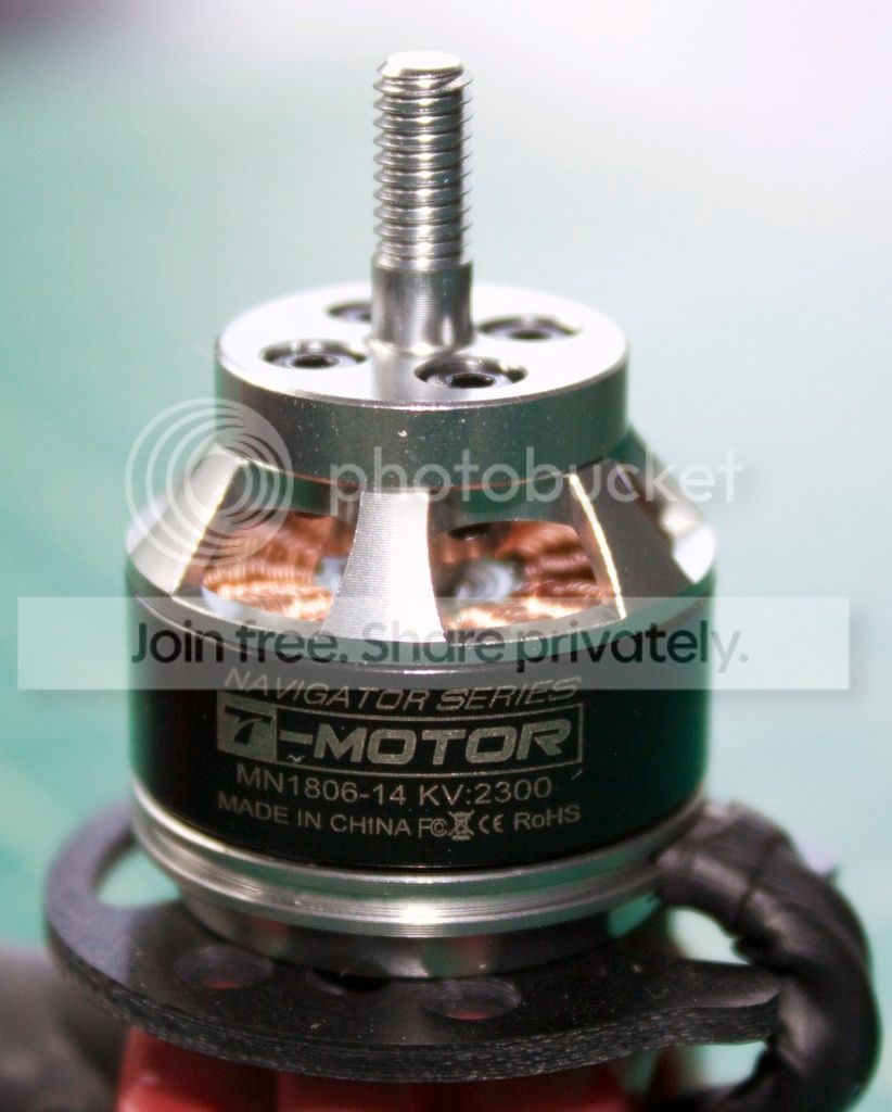

The motors mine came with are stock T-Motors. They have 4 mm prop mounts. According to Immersion, this will change for future shipments.
Luckily, I have a set of unused Dragonfly 1806s, and the removable prop mounts have a compatible bolt pattern. I installed the 5 mm prop mounts from those.
So now I don't need the Gemfans or the stock prop nuts.
Here's what it looks like with a set of HQ 5x4 props installed.

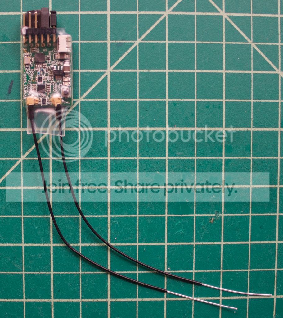

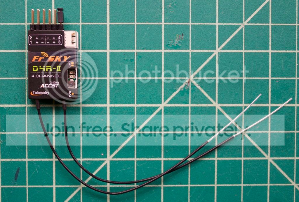

I'm using the FrSky D4R-II receiver.
I took off the case and put some heat shrink on it. I also put heat shrink over the unused pins.
I attached it to the quad with the antennas pointing down. I don't know if this is a good idea or not.

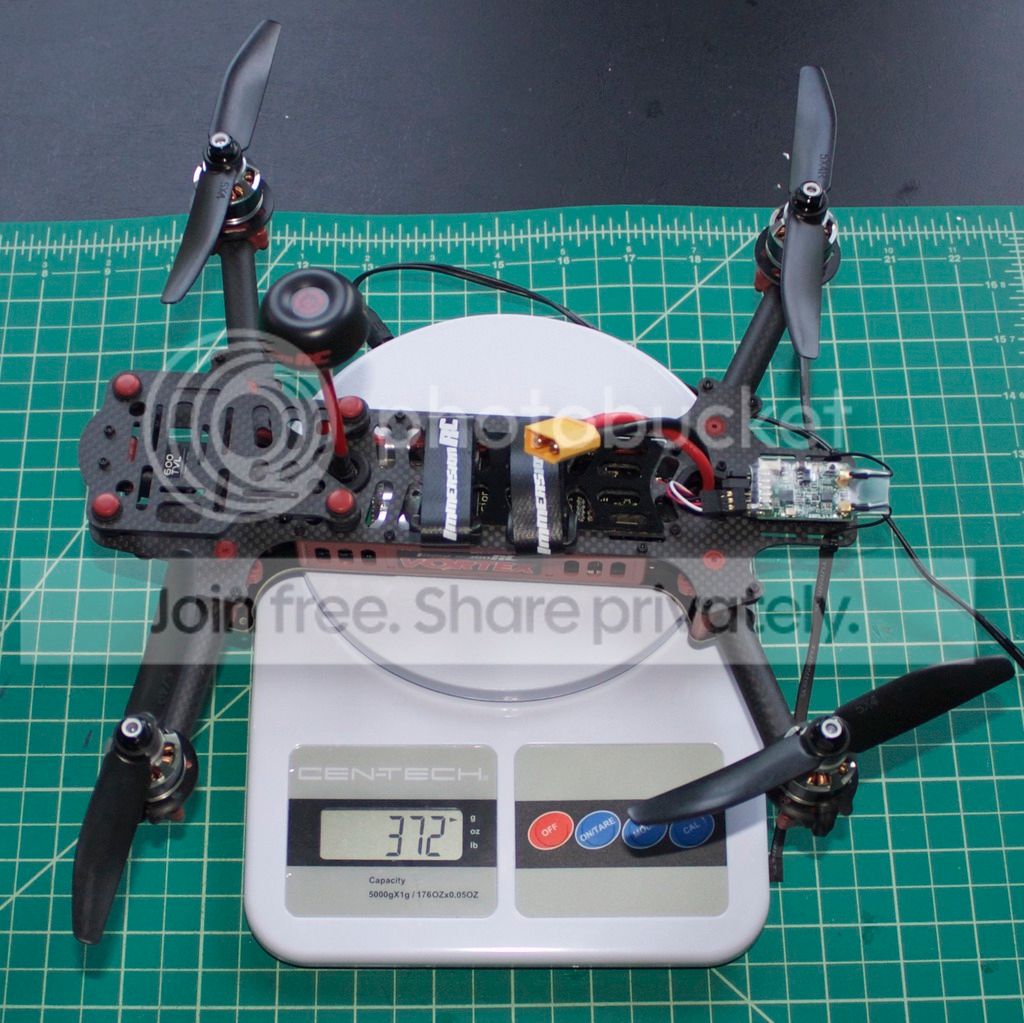

The weight without a camera or battery is 372 g.
With a GoPro HERO4 Black and a Lumenier 4S 1300 mAh 60C, the all up weight is 620 g.
And a Lumenier 1800 mAh 75C will make the AUW 697 g.

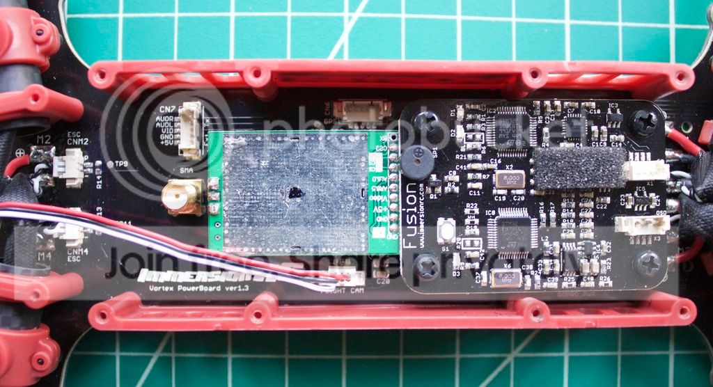

I'm curious....how does changing the VTX frequency through the OSD work. Don't you loose OSD as soon as you change the frequency?
I love using OSD's for changing settings...just seems like that particular setting may not be the best to have to make through OSD. Kind of like switching between NTSC and PAL if it's not setup right the you can't get an image to change it to the other one :D What if you change your VTX to a frequency you don't have an RX for? Can you plug your monitor/goggles right into the OSD before the VTX?
C0d3M0nk3y
When you change the channel through the OSD settings menu, the changes are applied after you exit the settings menu completely, not when you apply the change to the channel.
There is a button on the quad to cycle through the bands. I believe this will go to channel 1 on each band. There is also a stick command to reset the channel. I think that means reset to the default channel, but I haven't tried it.
