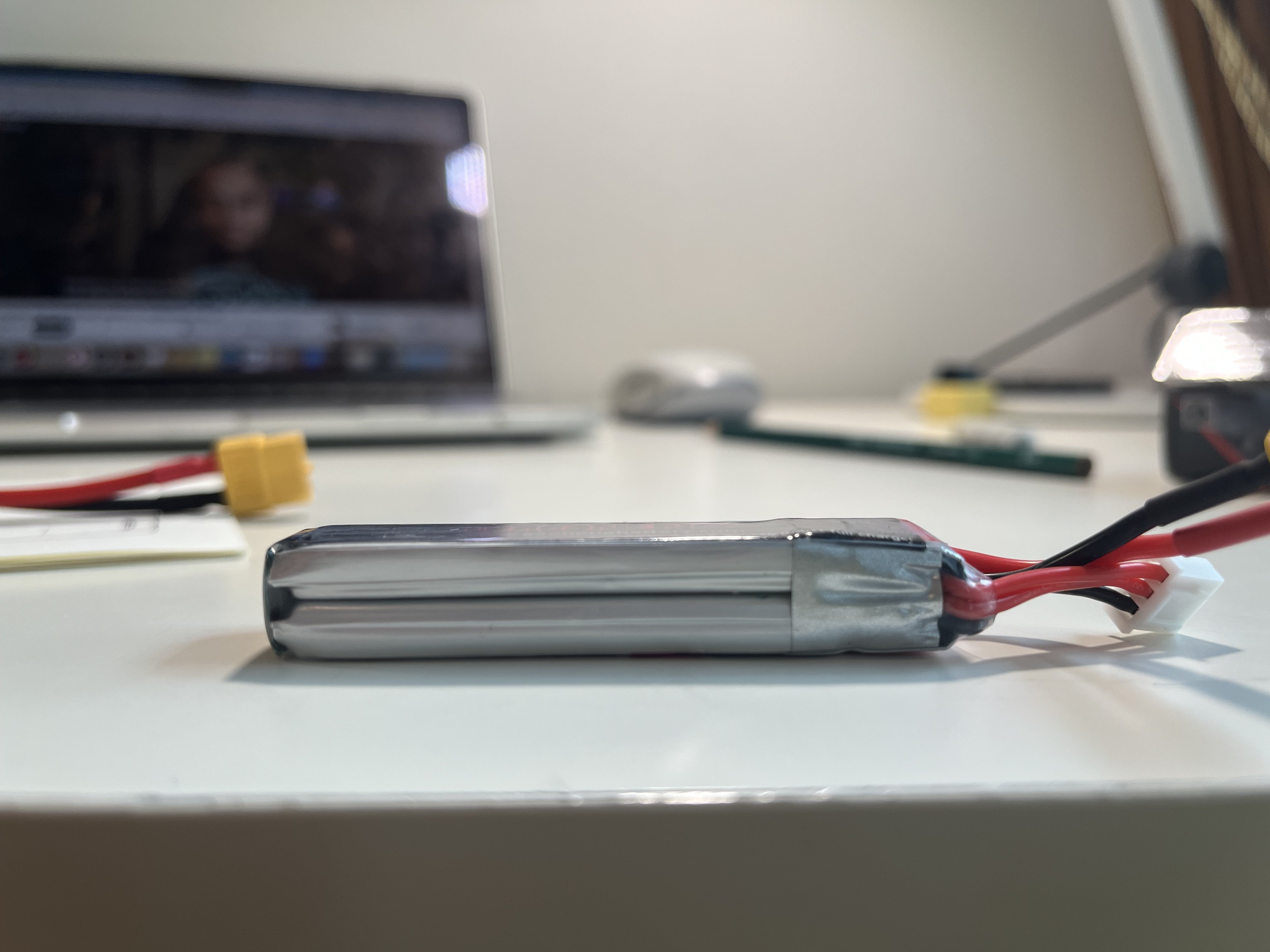

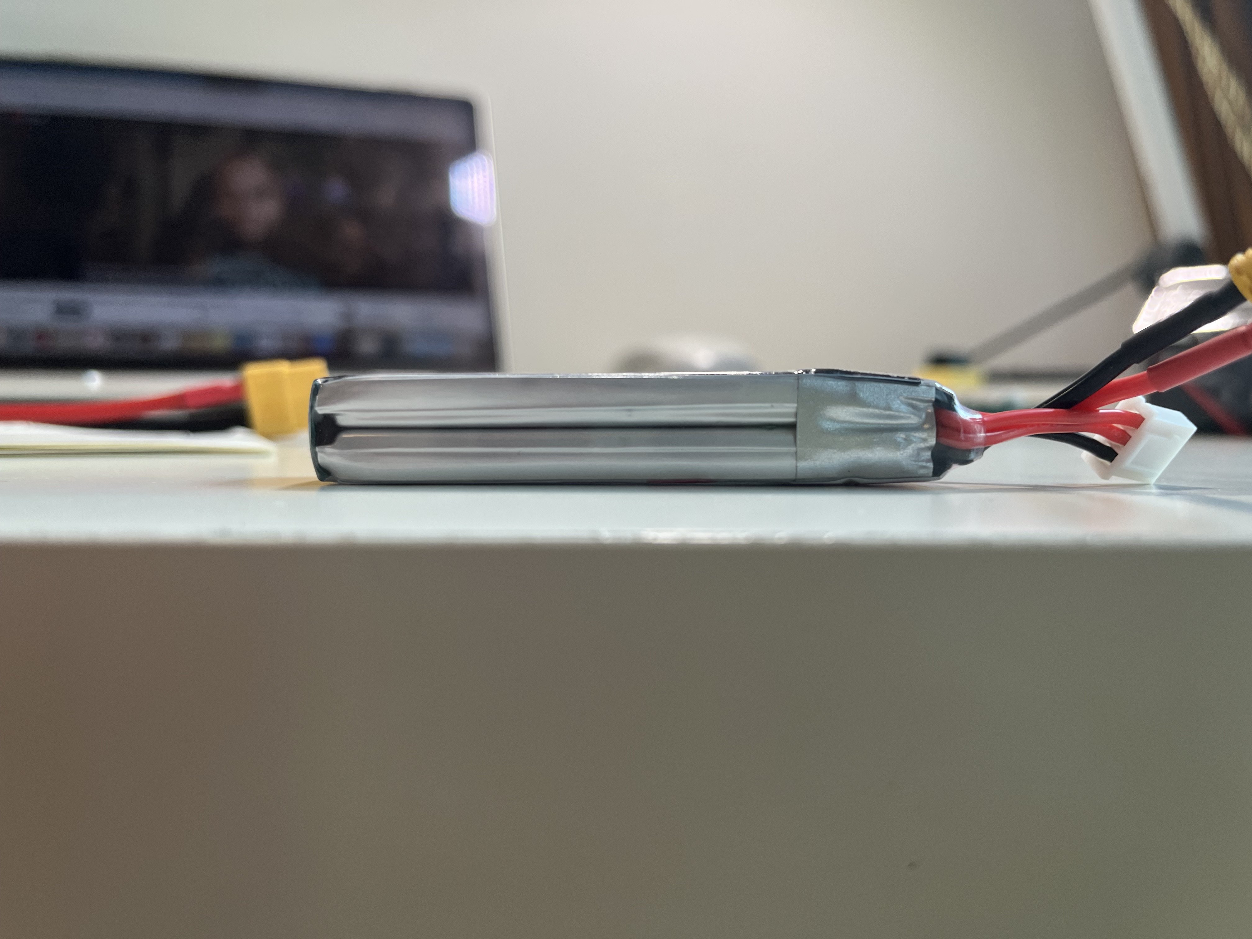

Hi all,
yes, another stupid question
Lipo I ordered on Aliexpress just arrived, is it a bit banged up? or am I overthinking those wrinkles?
Thanks again!
quorneng
I looks fine. As long as it charges normally (ideally all cells starting at the same voltage) it is fine.

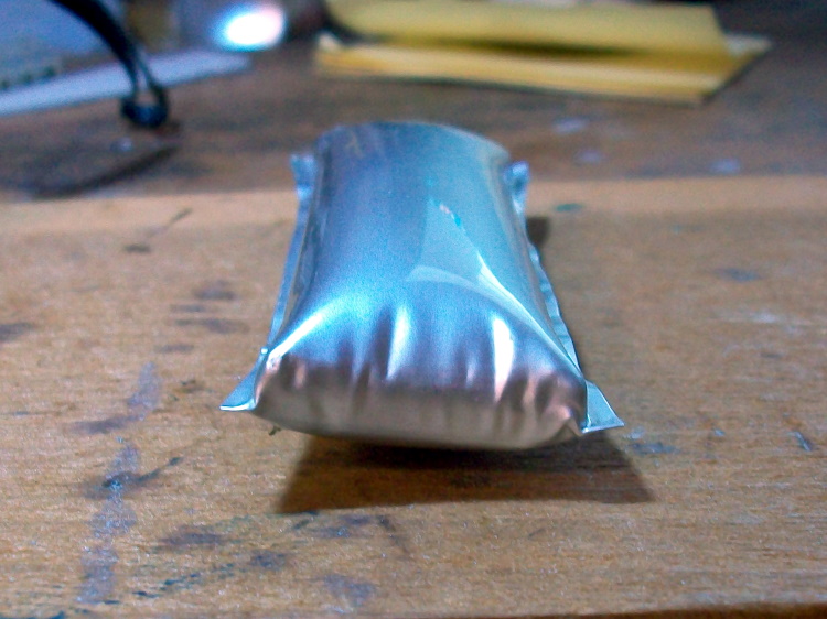

This is what a really puffed and damaged LiPo cell looks like.
It was still showing 3.7V but it wouldn't deliver many amps. Be aware the gas that puffed it up from mis use is highly inflammable and any further use could cause it to get hot and possibly self ignite.
If you really want to see if it's damaged do like @quorneng said and test it for capacity. Or power a radio and servos (maybe even a motor also) outside away from burnables until you get a low voltage alarm.
