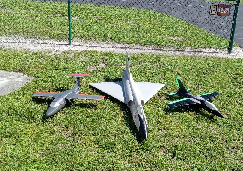

I flew a couple flights today with the old design with the further aft wing experimenting with far back on the wing I can push the CG (I'm going to reprint with the more forward wing regardless, so I wasn't too worried about crashing). To my surprise, the plane is still in one piece. I progressively pushed the CG back, but I never managed to get to the point where the plane would bite me. The further forward wing is definitely the right next step with this plane since with the more aft CG on the wing, this thing becomes significantly more agile. It can't really do anything it couldn't do when it was more nose-heavy, but it responds faster and feels better which let me push the envelope more confidently even in pretty bad wind.
telnar1236
Finally managed to actually get some ok flight video. I'm quite happy with how it flies now - it basically won't stall, even with full up elevator, and it floats quite well, especially for its weight, power off. With a more aft CG it's quite agile and even pushing the battery as far back as it can go, it won't really bite you. With the v4 fuselage, even with a 4s 2200 mAh pack, it's possible to CG it where I want, and it handles very nicely with both that and a 1550 mAh pack.
I'll be posting the files as a resource once I get the chance to write the assembly manual.
