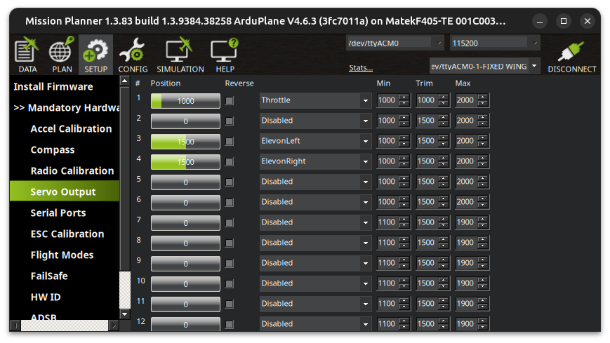

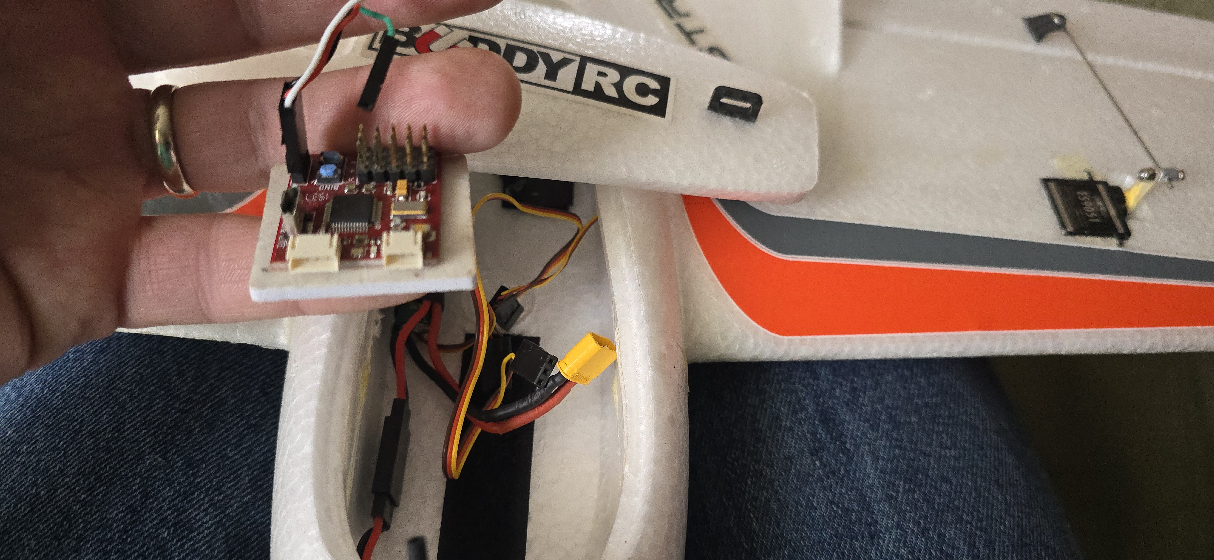

OK then. Another stalled out project getting some love! After Finding my PERFECT FC for this build thanks to @Merv (https://forum.flitetest.com/index.p...ing-mini-mk1-a-cheap-flight-controller.80418/ ) I am back on it to finish it up! Running ArduPilot Plane V4.6.3 (current latest) and checking the center, direction, and throws of the servos. ALWAYS check throws and center in Full MANUAL mode. Fortunately I still had control horn/push rods from #1, because one of the set screws was missing, and it has been a year of getting moved around so who knows where it eneded up. :)
This is an Elevon mix and the Aileron is doing Elevator things, and elevator is doing aileron things, so one of the servos is reversed and/or an RC channel is reversed. NEVER ASSUME that if the servos do what the sticks should do in manual mode, that everything is correct! One of your RC channels could be backwards. Recheck that in autoleveling mode, the servos correct in the right direction. If not, you may have servos AND a RC channel backwards which will totally not work in navigation modes. Ask me how I know. 😵 In this case Servo right backwards, and Elevator RC input reversed.. I fixed them in the Radio Calibration and Servo Output screens Screens by clicking the reverse boxes.

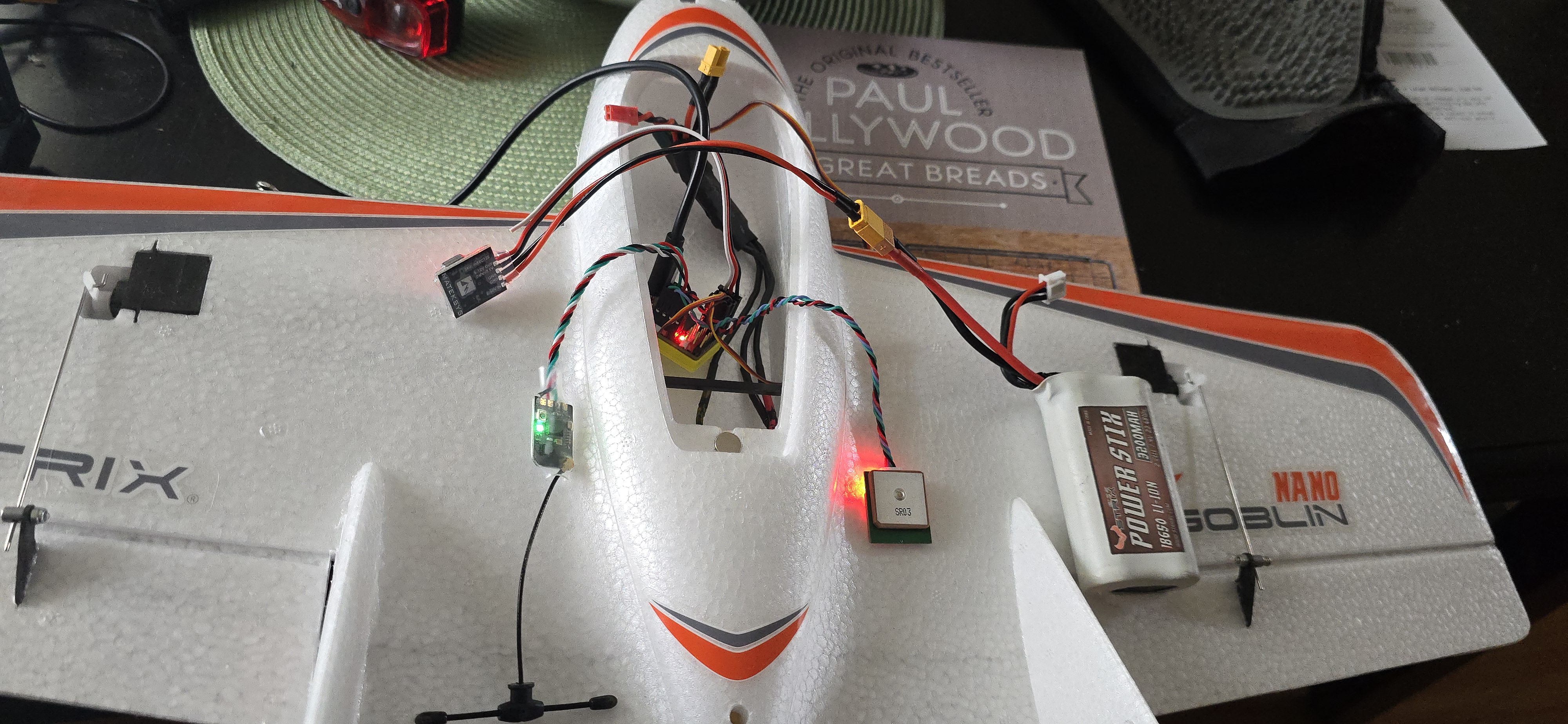

I am testing without the ESC hooked up, so don't worry about the prop (hah which you can't see) being on, it isn't powered up! Wanted to test one of my Nano BECs that I plan to use on the 3D Printed Nano Wings, and this gave me a good opportunity,

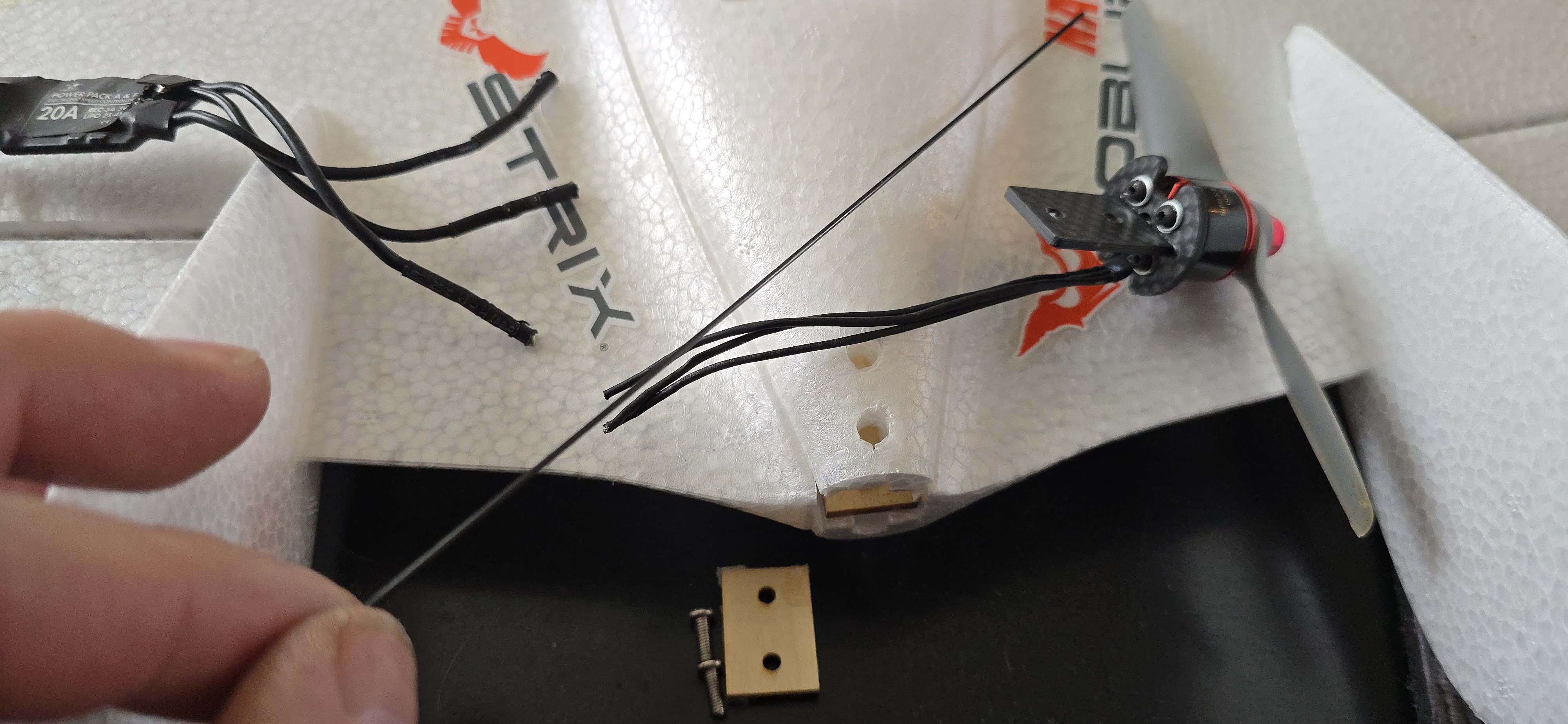

Dug in a little deeper and found a problem waiting to happen. The motor wires were barely hanging on. Got the bottom rear spar out and it will be easier to reglue the motor area with the motor removed.
EDIT: Put new pins on the motor connection so it is easy to install/remove motor without using a soldering Iron. Tested the motor at full tilt on 3S and the 1408 4000kv motor and wires were generating "some" heat.... Probably not rated for the 4.5"x4.1x2 prop it has on it. :sneaky: It will be fine for "short" bursts.;)
