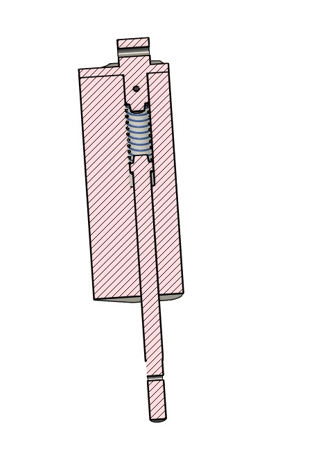

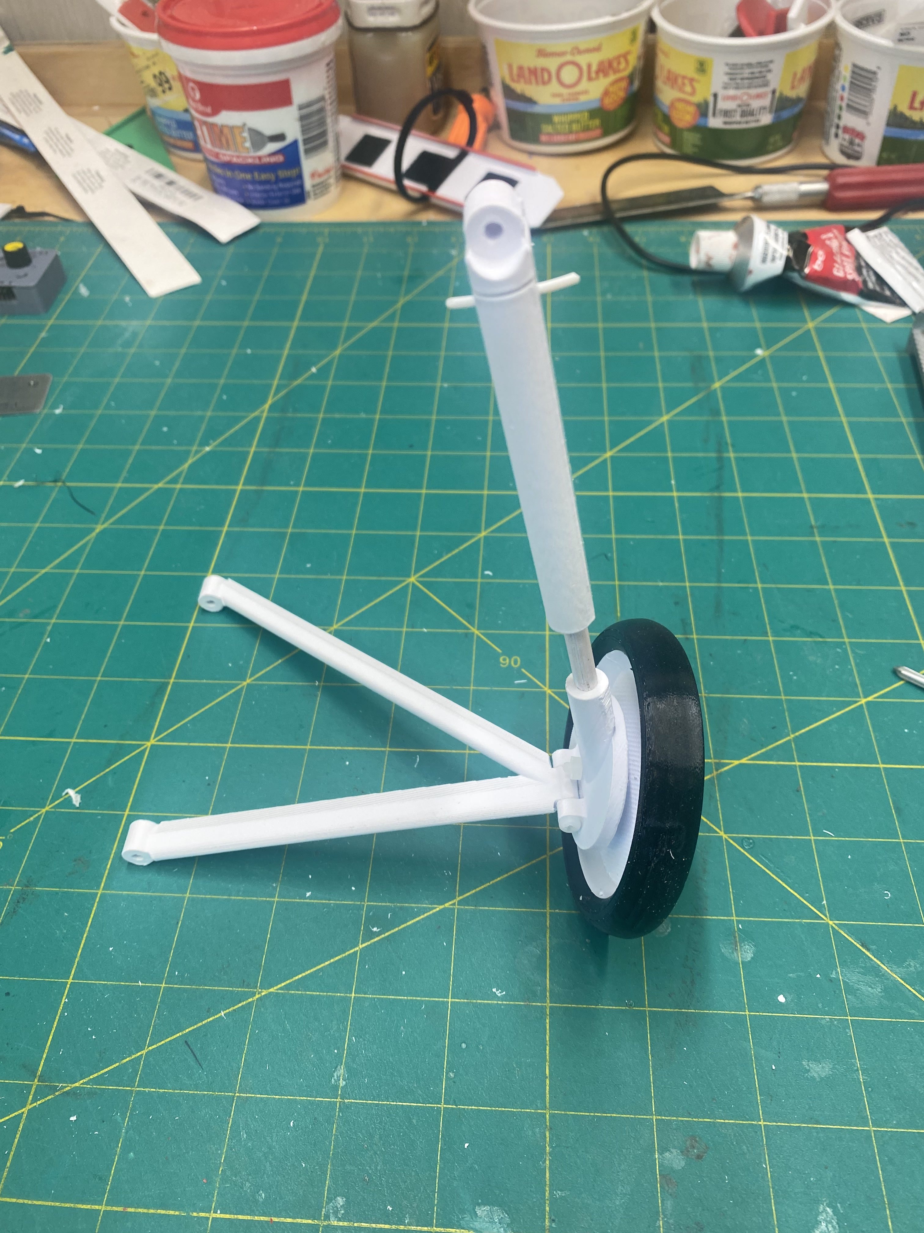

The landing gear is 3D printed. Here's a pic off the plane and a cross section of the strut & spring. The small holes in the strut cap and the bottom of the plunger are sized so it pins with a short section of filament and the hinges are all 3Mx20 nylon screws so it can all be taken apart and repaired. It looks delicate but it held up to a less than good landing. :p
