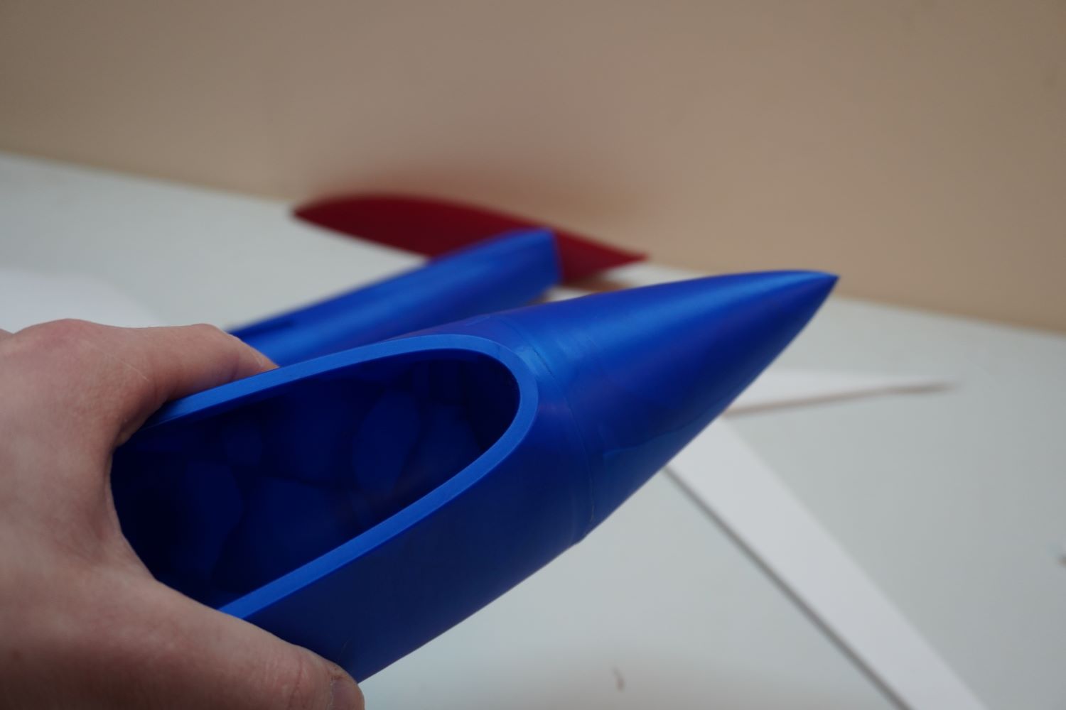

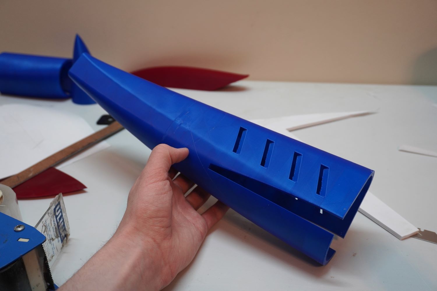

Help! Looking for 3D Printed Rc Airplane design Ideas!

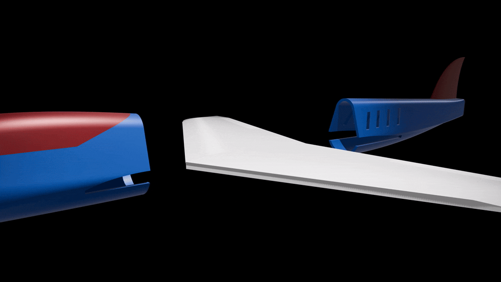

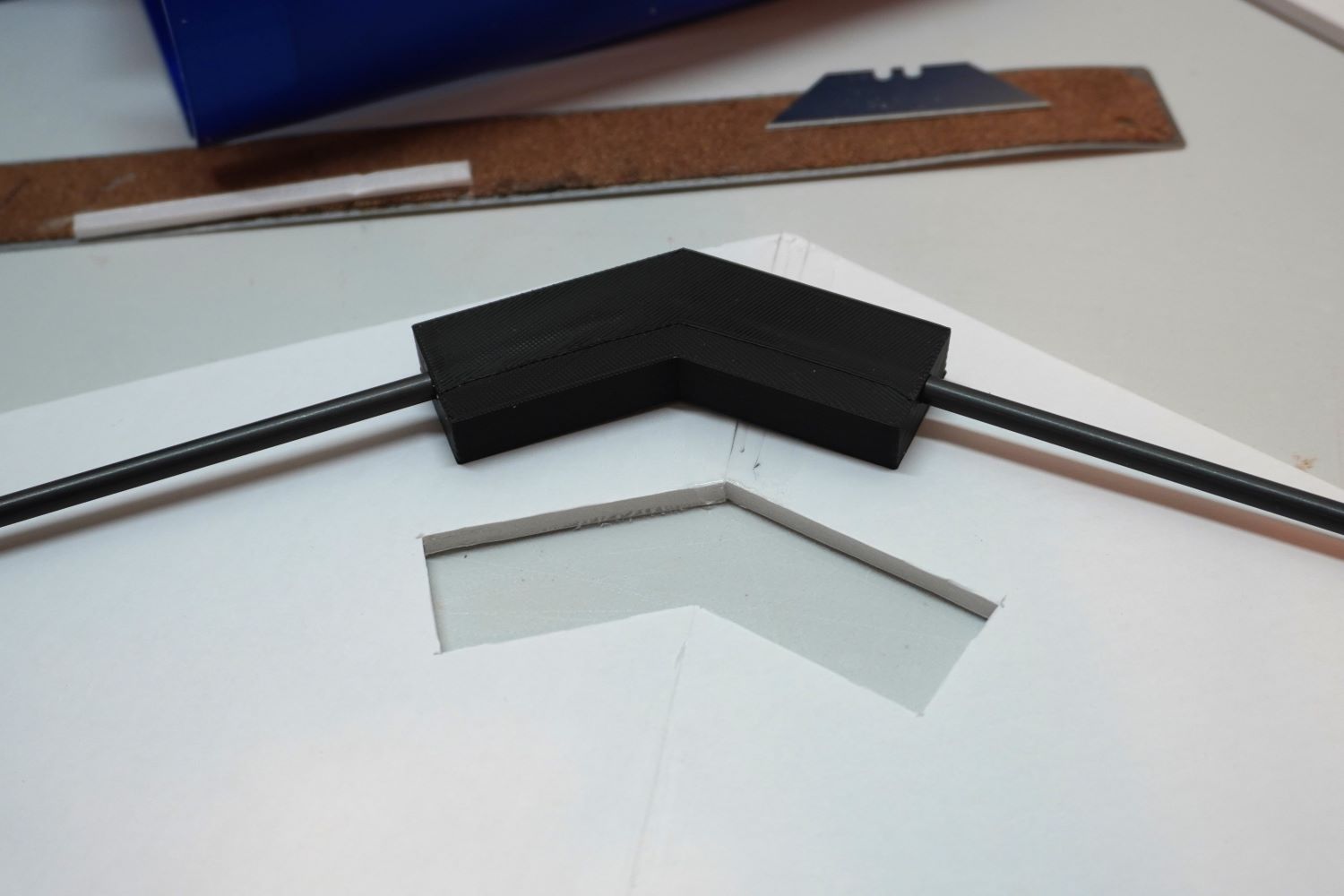

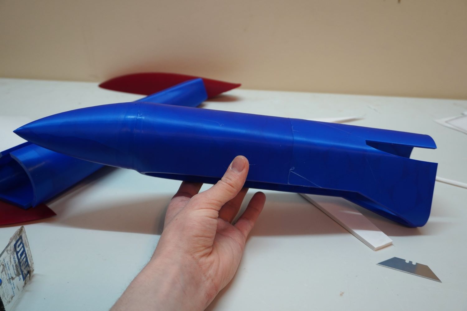

The wings will sandwich in between the two fuselage pieces:

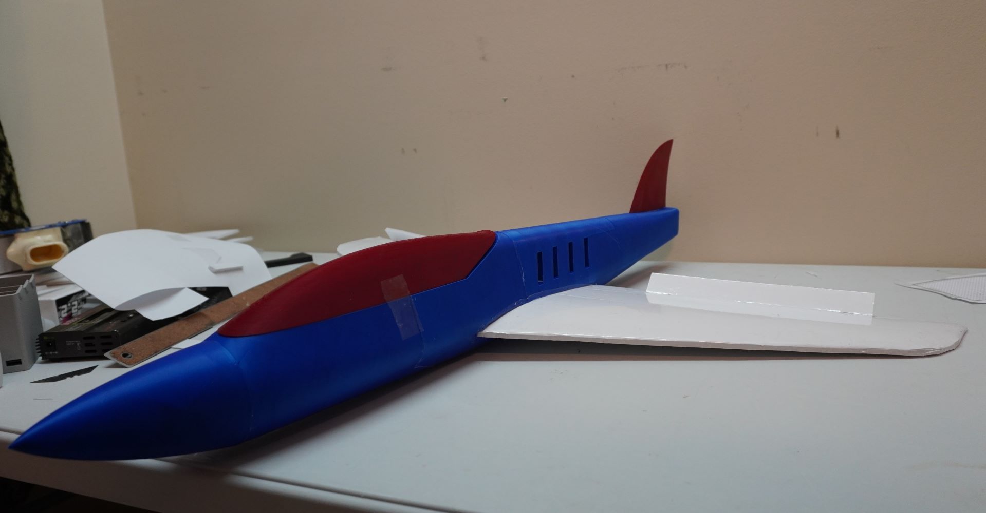

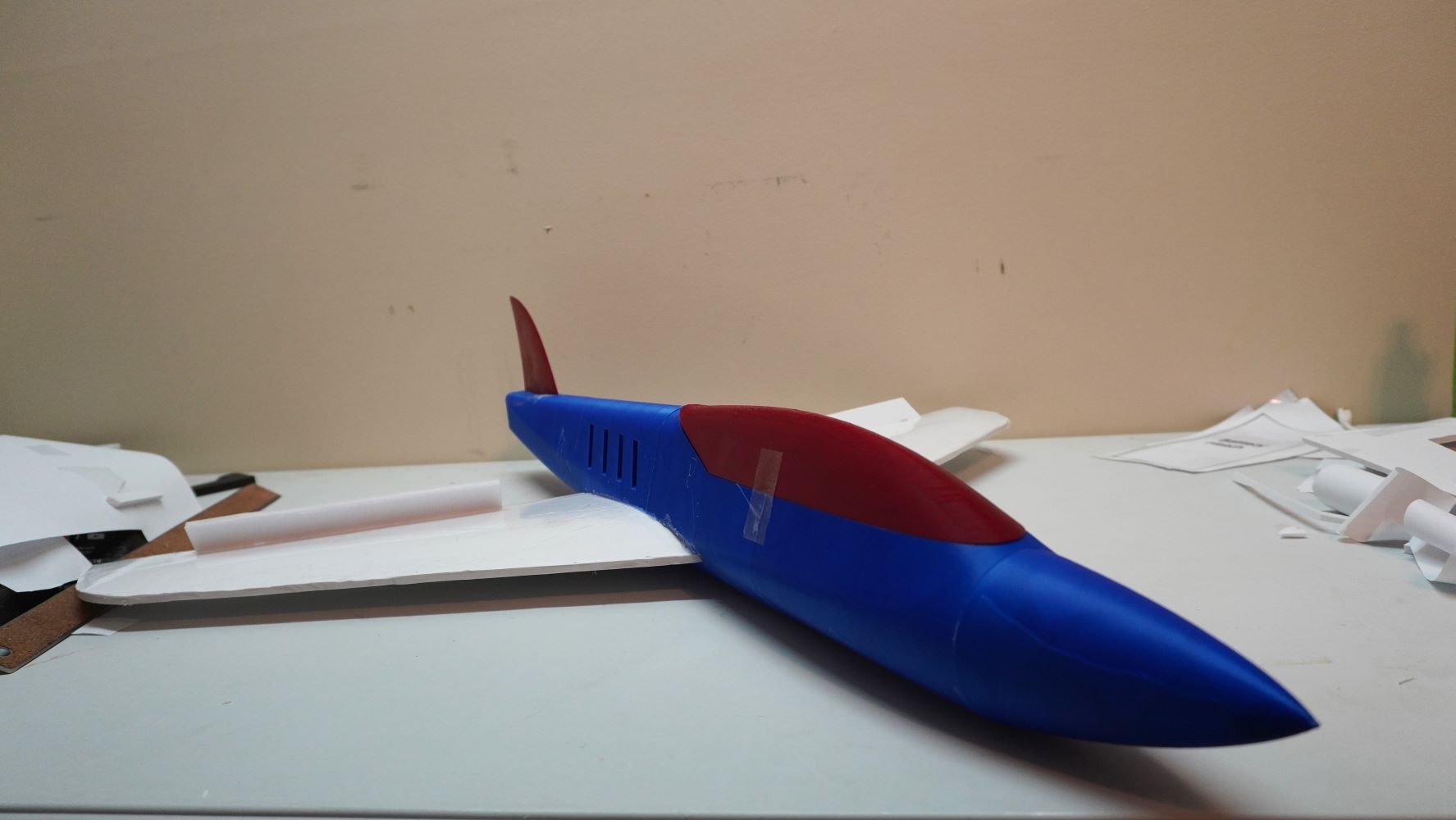

I’m a bit concerned about the size of the ruder, looks kinda small.
It's a bank and yank, so I just have it to help stabilize the air frame...I think I might have a lot of potential problems with this design😒 (I guess that's what I get by trying a design ChatGPT suggested!😆😆) Still, I kinda want to send it and see what happens! I'm trying to decide with I should put a FC in...

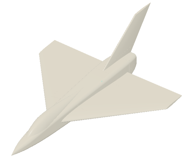

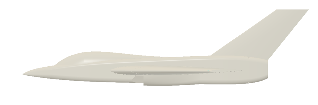

This is the "plane" that ChatGPT suggested and which I roughly followed...IDK, there are some issues with it!🤣🤣
Gemini told me to put all the 3 landing gear ahead of the CG to help the plane pitch up during takeoff one time
But on the other hand it almost completely design a decent 64mm EDF with only a bit of hand-holding required to curb its worst impulses. It looks a bit funny but honestly no more so than a lot of RC planes.
And all of the aerodynamically important dimensions/characteristics for the fuselage, wing, and tail were determined by AI.
