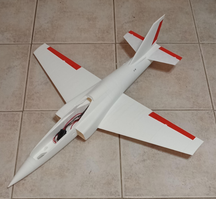

Cool! (I will Beta build that!..If you want..) Man! I didn't know you could just build it as solid and add the infill in the slicer! 😆
It's a bit heavier but gets you a better surface finish that way. I think most of the models out there are vase mode or fully modeled since weight is the major downside of 3D printing

The plane now has wings
I'll probably finish it up this weekend

Finished up building the sport jet yesterday and took it out for its maiden flights after work today. It's easily the best flying jet I've ever built and, without landing gear, possibly the best flying EDF I've ever flown. And it's fast - top speed was 104 mph which was towards the upper end of my predicted range and which makes it the fastest 4s 64mm EDF I've ever flow by a good 14 mph though there are definitely faster 64mm planes out there. I'll try to get video soon.
It's quite heavy, at around 1350g with the gear and about 100g lighter without, so I was worried about hand launching, but it was quite easy. The caveat is there was a bit of a headwind, so I need to try launching on a calm day too. It will try to tip stall if you pull back on the elevator hard enough, but that's about its only bad tendency and you can fly it through the tip stall since the ailerons remain effective. Power is excellent. The static thrust to weight ratio is only about 0.9, but due to its speed and low drag it can go vertical longer than I can keep track of it. You can cruise about 1/3 throttle or a bit lower which feels weird in a jet and it holds on to a decent bit of speed even at that throttle setting. There is essentially no coupling between the rudder and roll and the rudder is large and deflects a lot which makes knife edge flying extremely easy. And it lands well - you can hold about a 5-10-degree angle of attack and glide it in.
With gear on, it's still pretty fast and flies well. I didn't get a gps reading, but top speed is almost certainly lower. The suspension is maybe a bit soft but it's very effective. I'm not sure how urgently I want to fix that since hand launching is definitely the way to go.
Cool!..Now that I have a printer I can start building these!

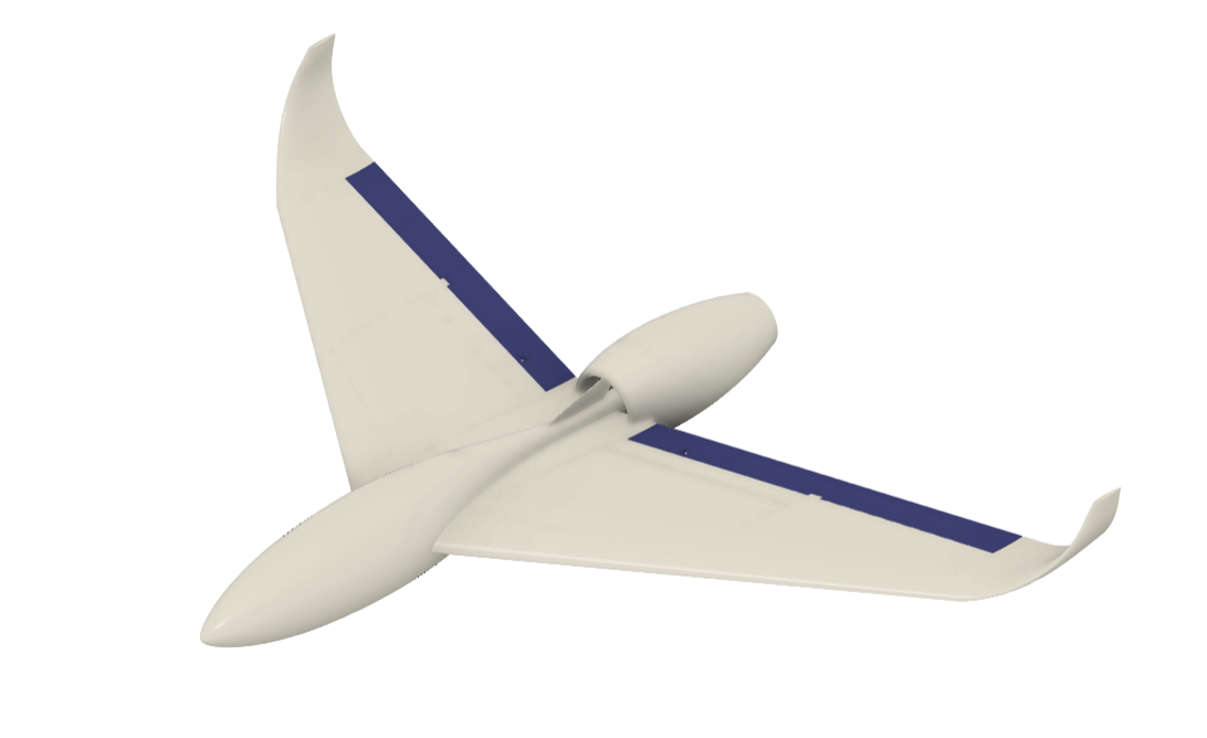

Now that the sport jet is done, it's immediately on to the boundary layer ingesting flying wing which I originally planned to build first. The left wing is already printed
This design will also be LW-PLA but with much lighter construction than the sport jet since it's got a similar wingspan but will only be powered by a 3s 50mm EDF
