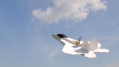

I have an f-22 “MkII” (the bigger one).

Taken from a video on the GoPro (headstrap).
