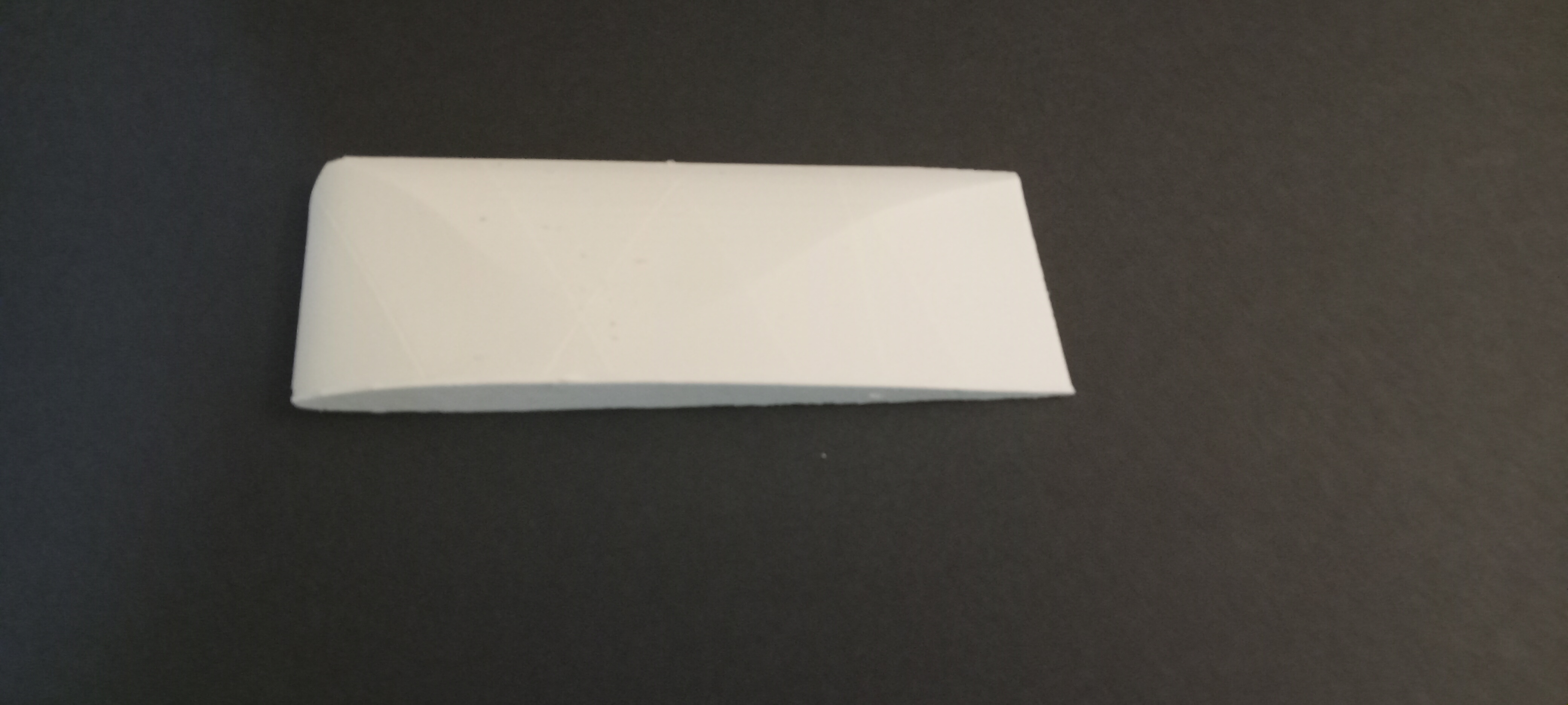

I'm starting this thread as a place to discuss printing in LW-ASA. I recently got my hands on a spool of Eryone LW-ASA so I'm curious what it's like. I'm hoping it's a good alternative to LW-PLA but with more heat resistance and even lighter still.
Has anyone experimented with printing in this material? I've seen a fairly wide range of claims about it online, from it's awful, warps badly, and is very brittle, to it's amazing and essentially superior to LW-PLA in every way.

With my F-106, I've mostly worked out how to get good prints with this LW-ASA. Here are my conclusions (it is important to note that my print, like most other designs including from Eclipson doesn't actually use the vase mode option as this breaks some kinds of geometry and instead relies on carefully shaped geometry to print as close to vase mode as possible):
  1. Prints MUST be nearly vase mode. Non vase mode prints end up very poor and there's a good chance they will lead to clogs. You can get away with small sections that don't print using vase mode, but you need to be careful with them. There are a lot of slicer settings you can get away with using LW-PLA that you cannot get away with using LW-ASA. The most important of these is to set "ensure vertical shell thickness" to none as this results in walls thicker than 0.4mm on angled surfaces and results in many additional travel moves.
  2. For areas that do not use vase mode, do not use the avoid crossing walls setting. Oozing is basically impossible to stop and you end up with under-extruded areas after longer travel moves
  3. Use 70% extrusion ratio. You do not actually end up with the full 70% and it is probably closer to 50-60% extrusion that you actually get (this was true across both printers I've gotten it to print on, both of which were direct drive). This still results in walls of about 0.6mm. I printed at 270 C.
  4. Some printers that should be able to print it can't for no apparent reason. My third 3D printer clogged on the first layer every single time I tried for no apparent reason and I cannot get it to print this filament. It is a direct drive, core X Y printer that prints LW-PLA flawlessly.
  5. Leaving the enclosure open (or printing without an enclosure) is the way to go, but you need a ton of good ventilation. Creep seems to be a problem with the door closed, but this filament stinks so I left my door open to my porch all day as I printed the parts.
  6. Geometry more than about 100mm tall has a good chance of layer splitting becoming a problem. It's pretty easy to fix by filling in the gaps with CA and lightly misting with water to start it hardening, but best practice would probably be to print shorter parts.
  7. It is very weak. Once printed the parts feel ok, but it is much easier to accidentally poke holes in the printed skin when compared to LW-PLA. Any wings (or even horizontal tail surfaces) probably need carbon fiber spars. You could probably design something that would work with no spar, but it would be tough.
